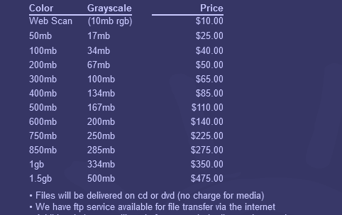

I am in Madison, WI and all the commercial stores are quoting $50 per scan of each image! Times 80 = $4,000; on "quantity I will receive a 10% discount which still leaves a $3,600 cost; since this is all new to me
does this seem reasonable? Seems steep to me; I asked since I am requiring a print just a scan would the price be lower and the answer was no. Should I look for the Epson V700, V800 on the used market would what be a fair price to pay? Thank you again
Because you posted images from film scans - Hassleblad, Coolscan and Epson, and state 6300ppi I thought you needed your film scanned as opposed to print scanned. Can you clarify for me if you need your film or print to be scanned or maybe both?
If it is just to scan 8X10 prints then $50 for each sounds excessive. I have scanned many original prints on various papers and the highest ppi I have used was 1200ppi on super glossy paper and at that point you can see the paper's texture. I have not scanned Ilford Fiber Base Multigrade paper but would guess you will see the paper's texture before 600ppi whichmeans any competent flatbed should be able to achieve all the detail you want.
