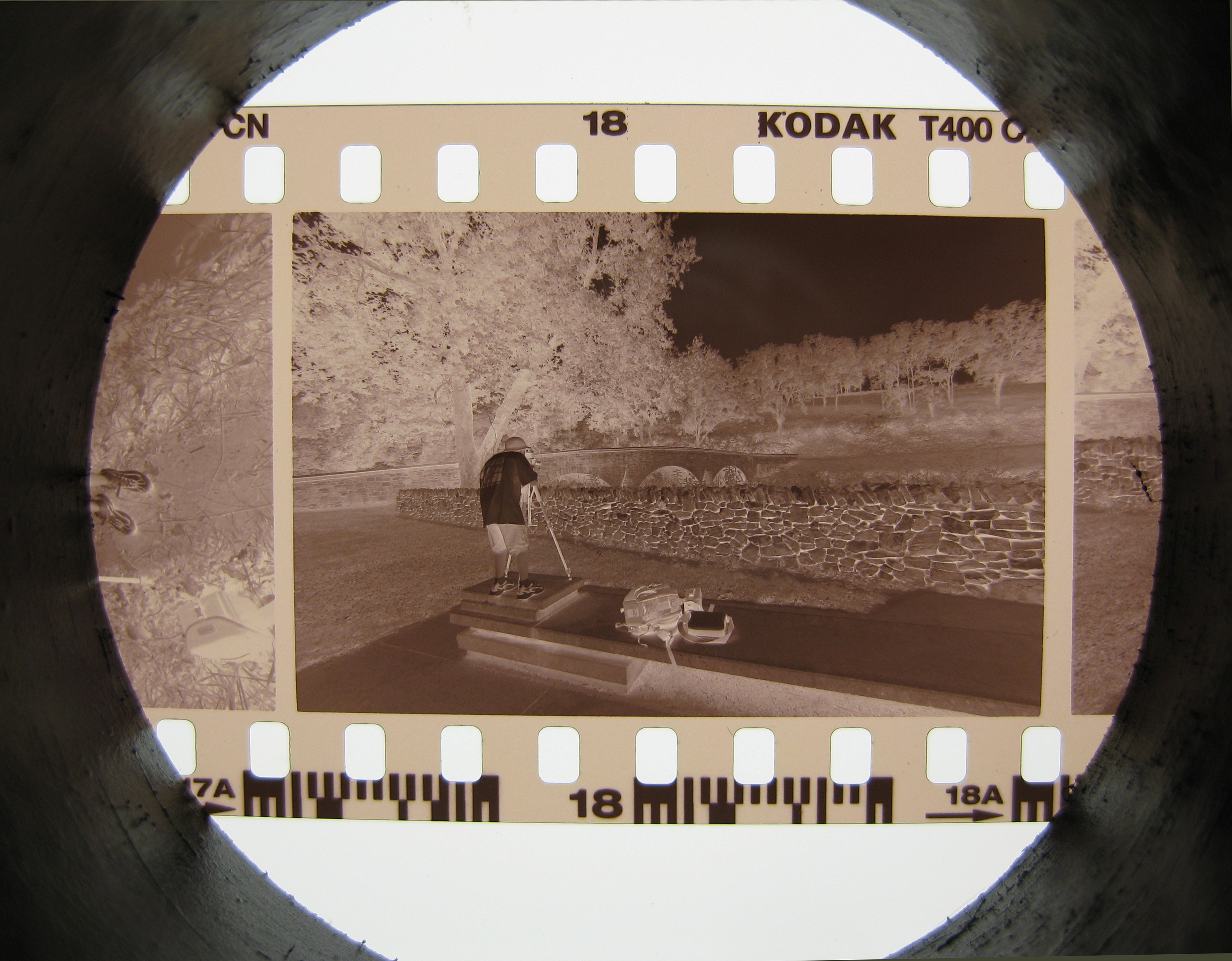

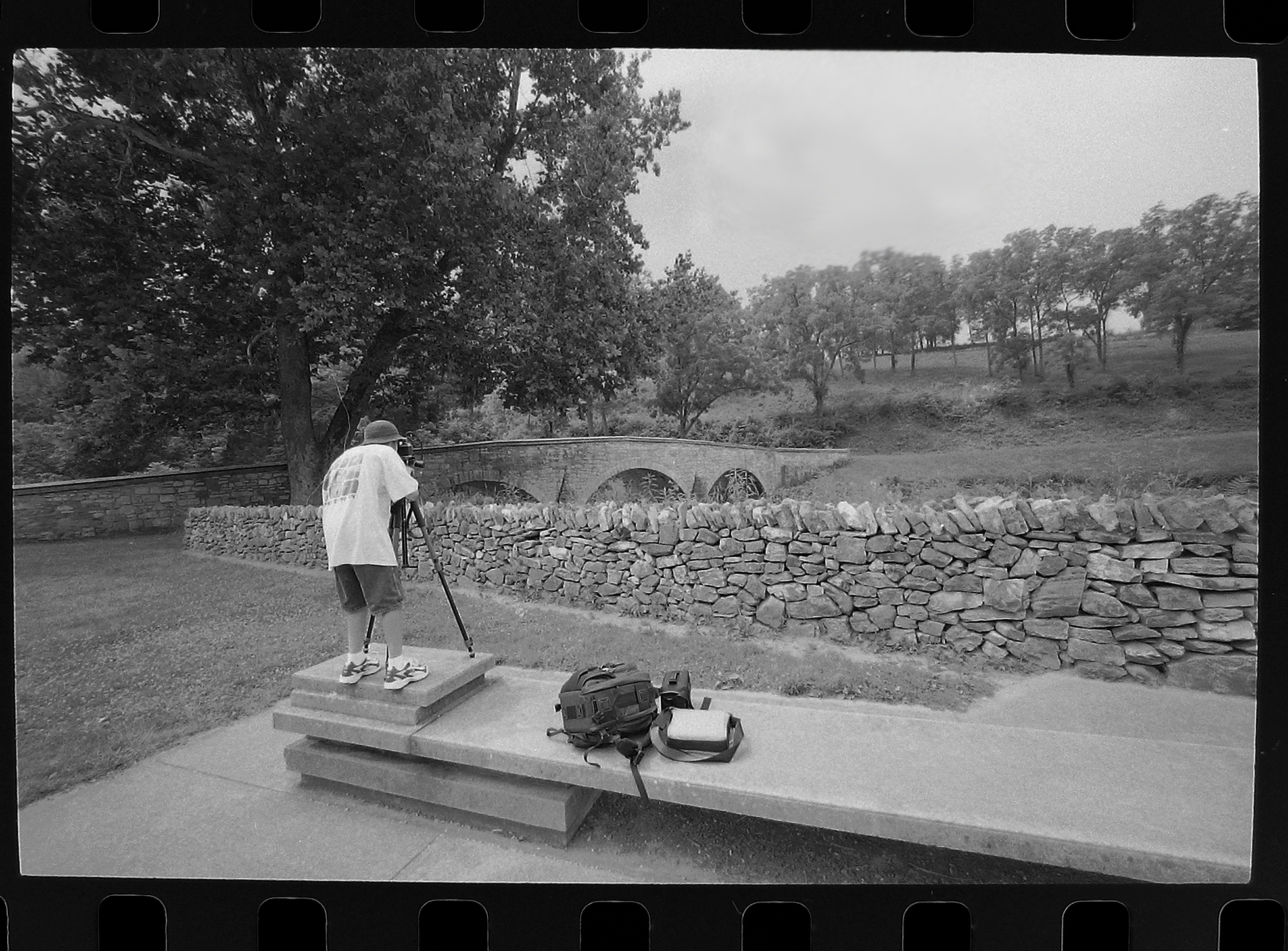

my first foray into negative scanning (c. 2011?) was on the cheap, quick-and-dirty via a neg laid on the light box, then shot down through a matte-black painted "cardboard tube" (aka, a toilet paper roller) by resting a little Canon point and shoot (which had a nice minimum focusing distance - the SD1100is) atop it.
Later, I used a short piece of black-painted pvc pipe to do the same thing.
Worked well enough for my prosaic purposes
(pretty downsized here; contrast was later corrected in PSE12)

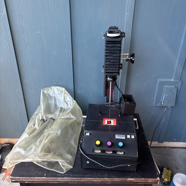

I use one of these with a Nikon D750 and an APO enlarging lens...
A upside-down enlarger. I use the same thing but with bellows lenses and process lenses which at designed for 1:1 and higher magnifications. Enlarging lenses are not.
