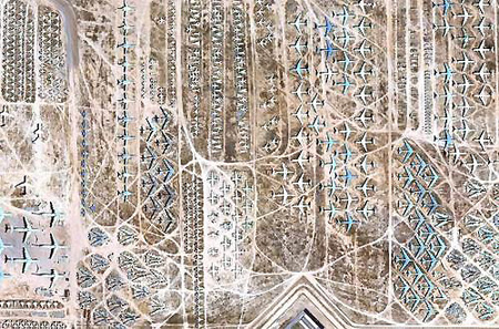

If you live in an area with low relative humidity, then glass mounted slides are the way to go, especially if the slide needs to be cropped.
Yes that is absolute correct - in desert "like" areas you have not to care about
humidity that's a central key to livetime (not only in regard of slides) see :
with regards
