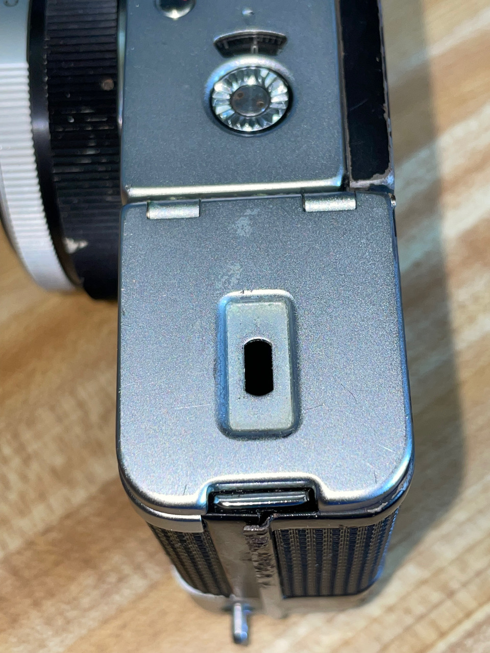

Found this amazing Olympus Pen EM Film camera at a thrift store.

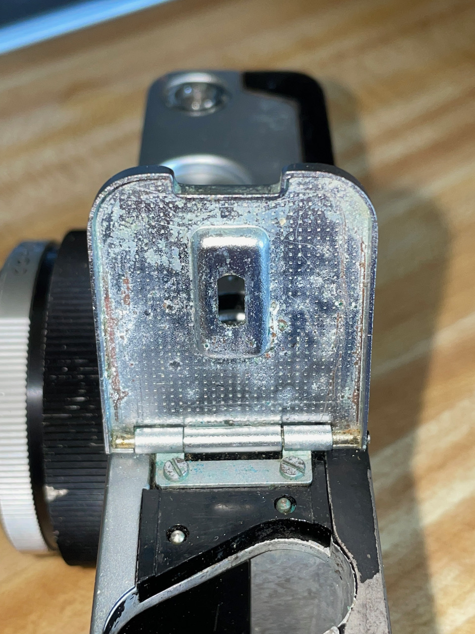

However, the battery door seems to be missing its latch or the battery spring seems to be missing. Please see attached photos of the battery compartment.
Whenever I put 2x AAs into the camera, they fit loose.
How can I find parts, or repair this neat little half-frame camera?
Thanks a lot!

Yep, there should be a plastic insert and metal (chromed brass, usually) contact/spring strip in that door. The plastic bit could be 3D printed; might be a little trial in error in getting the fit right, but it should only take about 20 minutes of machine time (that is, you'll spend longer CAD drafting the model than printing).
The insert might be two parts with a small spring of some kind, too. Hopefully someone will turn up to has one, to at least see what you're supposed to have.

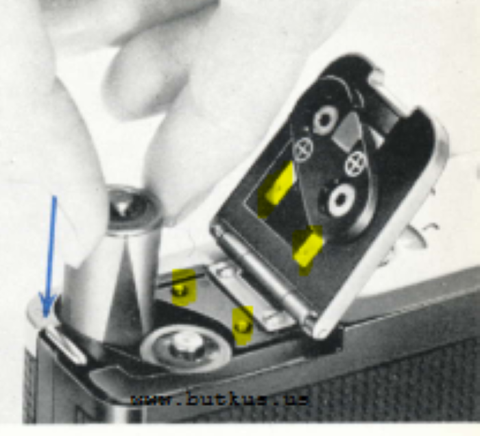

After looking at the manual, the batteries go in both positives ends up. The piece that is missing then connects each battery to one of the little nubs sticking up. I highlighted the nibs and the part that contacts them in yellow on this screenshot.Making a piece to replace exactly what is missing is not a easy task. To start I would make two jumper wires (Flat pieces of metal or aluminum foil may work as well) and see if I could tape them to the battery tops and and then the nibs and see if the camera works. It would be difficult to just hold them there. If it does work I would try a AA battery holder. Cut it down so you only have one side and then solder the leads to the nibs sticking up. The best solution would be a donor camera that has the piece. However, you would still want to verify it works before going through the trouble.

I think it would be possible for someone better with 3D CAD than me to produce that insert and the latch that goes with it.
You're probably correct, donor camera is the sensible route.
.I think having the plastic part fabricated would be simple. The problem I see is not the plastic parts but more the metal connectors.
