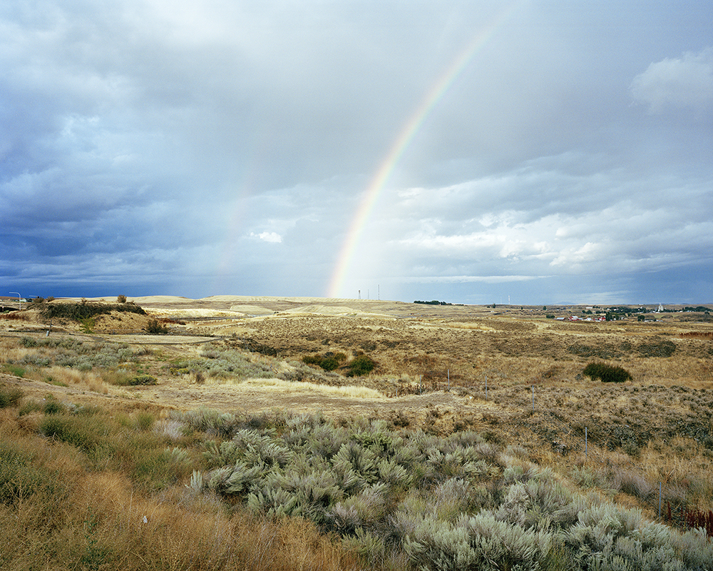

Hey there! I just had a huge batch of film processed locally and was very disappointed to find banding across many of my images. At first I thought it was dust caught in the Flexlight scanner I had been using however, the lines were in different places across each image. It turns out it was an after-effect of the dip processing method used at the lab I sent the film to. They say it has been a recurring issue with the equipment they inherited and that they do their best to minimize it (which is normally the case). Unfortunately, this is the most trusted film lab in Toronto.
Consequently, this leaves me with a lot of work in post to get rid of these issues. Does anyone know of a best practice?Ordinarily, I would just use the healing brush tool for such problems, but because these bands span the entire length of the image and often go through sky, using this is not a best approach considering the healing brush does not work well on very large areas, or on gradients. Any efficient methods out there for removing streaks and lines, that hopefully don't involve hours of work ?
I've included an image where you can see the bands in question in the top portion of the sky, running the length of the frame horizontally.

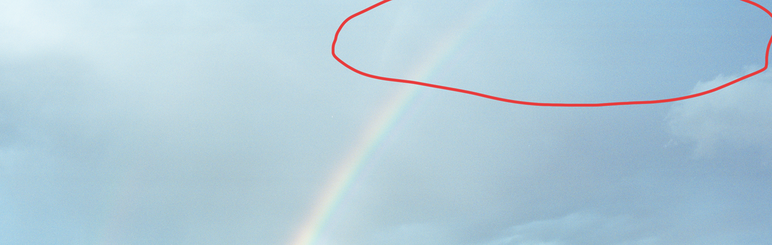

Thanks for your response @Kino ! Unfortunately, it won't let me upload anything with higher resolution, but I have attached a close up screen cap to give you an idea. The lines are very faint, but will definitely show when printed at a reasonable size. It is definitely more difficult to notice at lower resolutions.

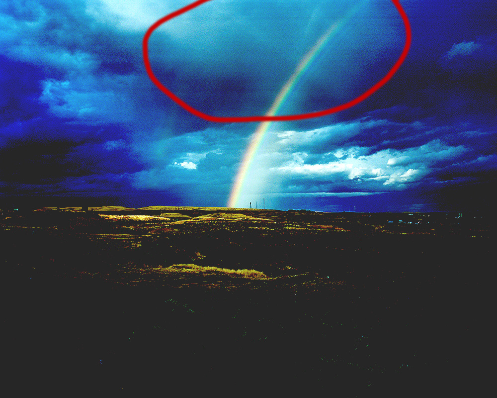

I'm scanning the negatives myself, uncompressed on an Imacon Flexlight scanner at 3200dpi. The hazy, thin lines that run across the top portion of the image are what I am referring to. They are unrelated to the scanning as they are on the negative and not the consequence of anything digital. Normally, I use photoshop's spot healing brush to get rid of dust and other such details, however that tool is notorious for struggling with large sections and across gradients, such as the sky in an image. I'm just looking for the simplest and most effective way to get rid of them to avoid spending hours fixing up each effected neg.

Ugh. That's a tough one.
If the lines are very straight and very well defined, and you have a very large scan to work with, you could draw a box around the entire line, go into curves and manipulate the RGB curves to try to bring it in line with the surrounding pixels.
Might have to experiment a bit with the feathering of the box you draw, but if you manipulate the RGB and gamma data, I'll bet you can minimize the line.
