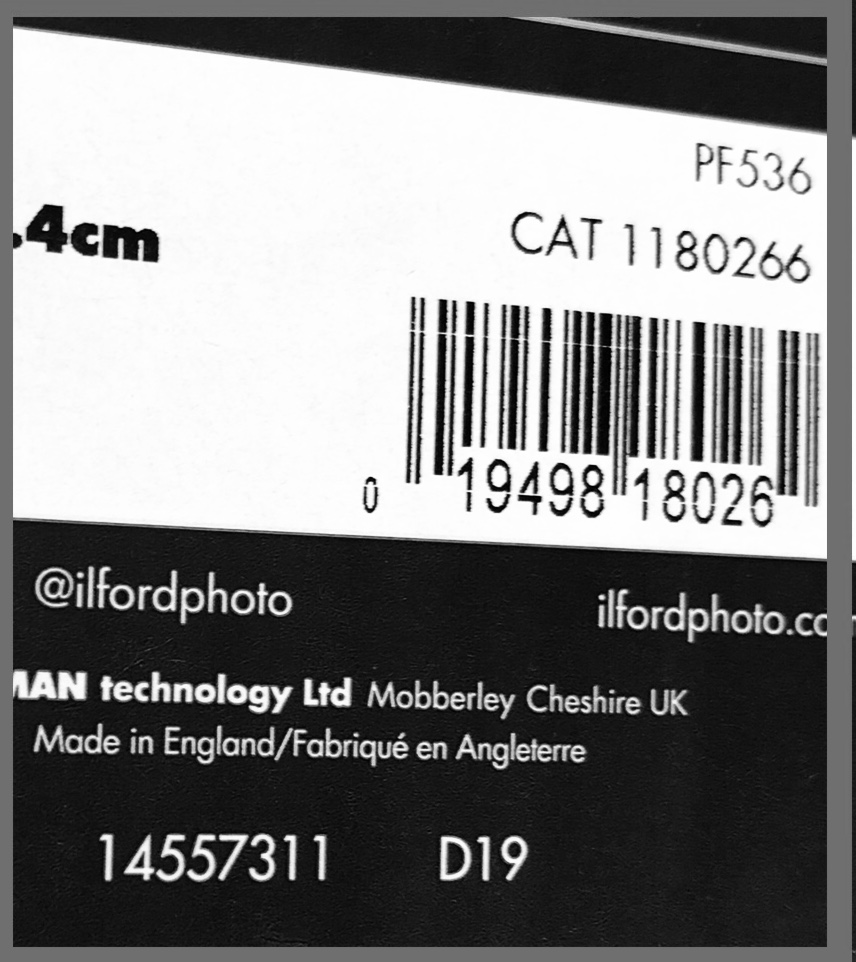

1) which is the date code?
2) how to read?
3) when did they start with the new format?
On attached photo of some paper:
PF536?
D19?

I don't know that they use a date code.
But if you send a Private Conversation to @Harman Tech Service, they may be willing to give you some idea of the production date from the batch number.

Just a bit of guessing:
D= 2013 + 4 years
19 = 19th week

Hi Todd et al,
Since we went over to our new ERP system in October last year all the the batch numbers are allocated by the system as a sequential number. So, PF536 is the 536th job raised on Paper Finishing. Same for FF = Film Finishing.
We will give you a manufacturing date if you contact us on technical@harmantechnology.com
Regards,
David

Over the years there has been several threads on working out the date of manufacture from the code on the box
Can I take it that since Oct 2021 such a code on a box no longer exists and so from Oct 2021 there is no way to work out a manufacturing date from any code on the box and it now requires contacting the above e-mail address?
Thanks

Hi Mike,
Yes, that's correct but obviously we would request that you only contact us about batches you have real concern about eg. private sale of unknown vintage for instance. Anyway, no need to do this for the next year or two with these new numbers!
Regards,
David
