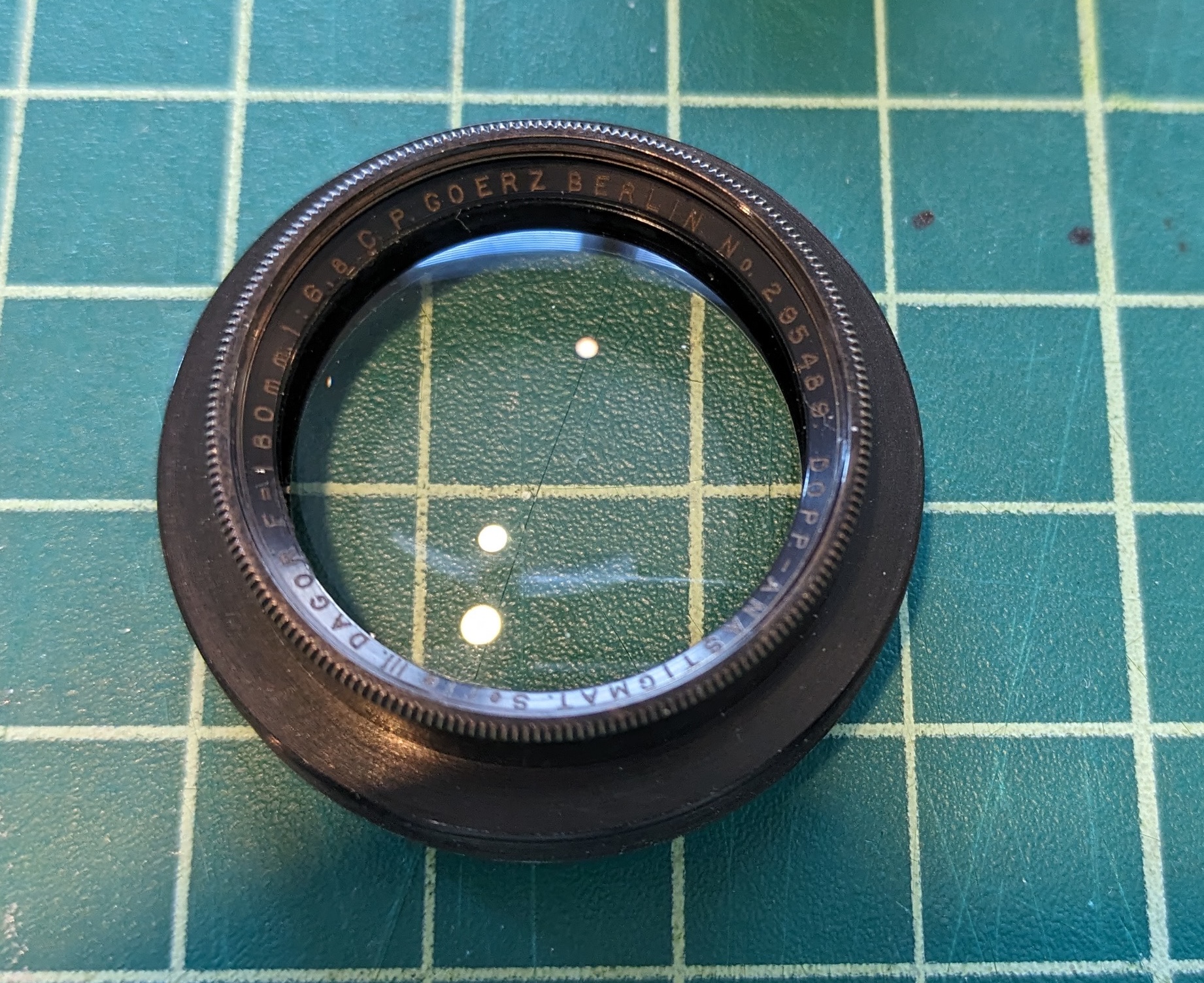

Thank you all for sharing your knowledge. I just did some measurements and took some photos.
The detailed description on front lens group
C.P, Goerz Berlin 295489 Dopp-Anaastigmat Series III Dagor F=180mm 1:6.8
So according to serial number db, it should be manufactured before and near 1915.

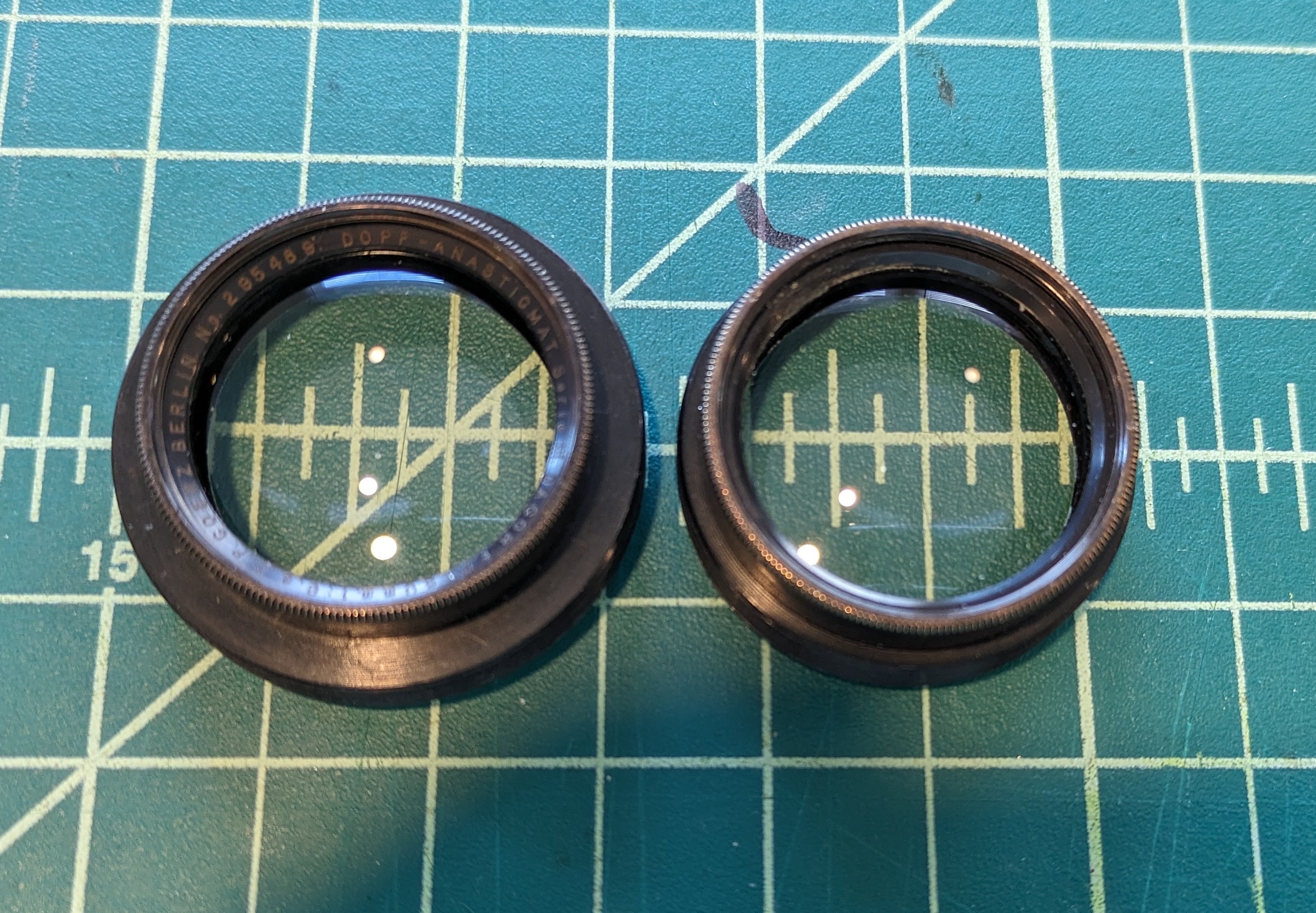

The front cells and back cells look to be identical, both in terms of diameter and depth.
With the thread adapter/bushing, the measurements are as following. The bushings are of different outer diameter and depth.
So based on the above information and images, would anyone kindly suggest the right dial/rim-set Compur that will match the cells?
Thank you!

The thread diameter of the cells from my Xenar 4,5/150mm that's mounted in a rimset Compur from the late fifties (?) is 40,0 mm (front) and 35,85 mm (rear). But there is a problem with your cells not having a flange to stop against the outer face of the shutter. The front cell might be all right to turn all the way to the bottom, but that wouldn't be feasible for the rear cell. This is because the rear inner bottom of the shutter is rotating with the aperture ring, which means you wouldnt be able to adjust the aperture if the rear cell is turned all the way to the bottom. There might very likely be another version of the shutter with another arrangement in the rear. There is or has been a Swede here in the forum (possibly called JPD?), that seems to know a lot about old shutters, perhaps you could ask him?
