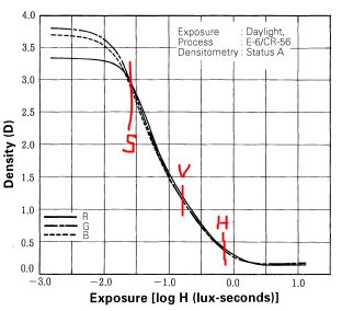

Use spotmeter mode and work with multi spot and watch the clipping points. Since you're looking at gray, the scene will not exceed the clipping points except the sun itself. I drew lines on the Fuji curve for Velvia, where I believe I would put the clipping points on the L-758DR. (You can adjust them you know). They are about 4/3 stop below... and 4/3 stops above. There's a way to test to place them exactly but I think you could either take my word for it or ask around for a better set of points.
