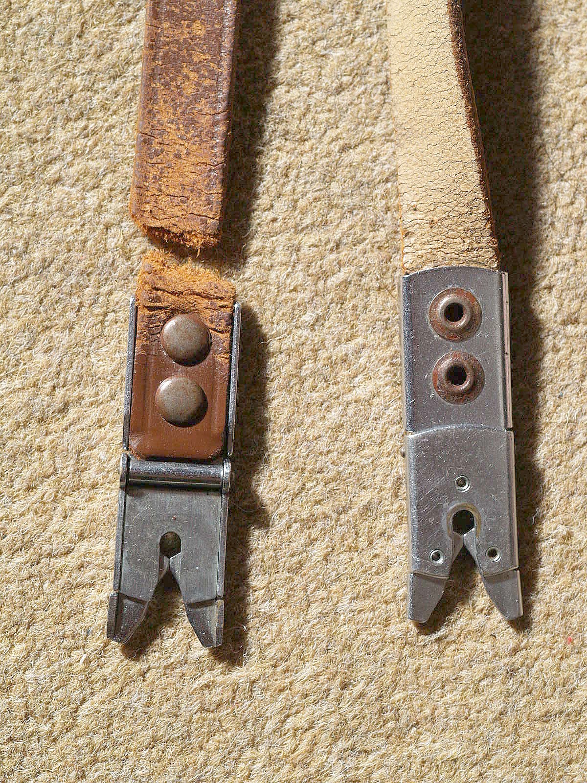

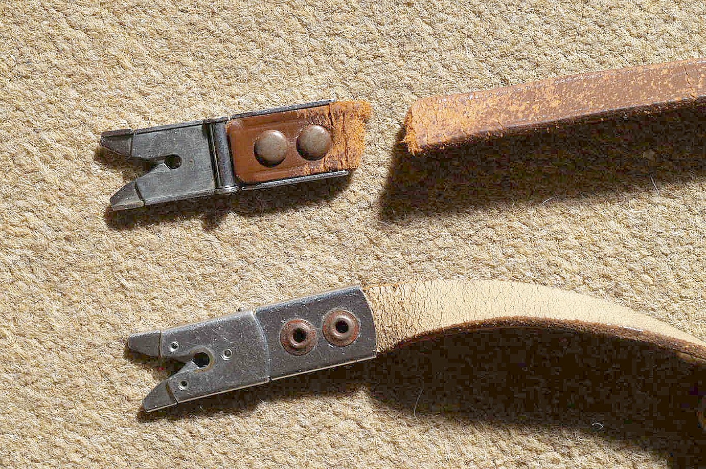

My Lovely 1960 Rolleiflex 2.8F Planar nearly fell to the ground yesterday on a trip as the STRAP BROKE but luckily I was sitting at a table. Does anyone here know HOW to loosen the Rivets and fix the Good Part of strap back please ? I DID put some Neatsfoot Oil on it a couple of years ago to preserve the Leather.

Snapping like that indicates that the leather is old and dried out. You are lucky you were at the table. I lost my first Rolleicord to it crashing to the street as I stepped off a curb.
Get new leather. Find a horse tack shop or a shoe repair shop and see if they can help?

The rivets will need to be drilled to get the remains of the strap off.

As mentioned, drill out the rivets and don't reuse the old leather. I got a strip of kangaroo hide (thin, strong & flexible) from Australia and built several straps. The only leather straps from the 60s I've had survive are the very fine black leather Leica M straps that were reputed to be from unborn calf hide.

WoW ! So HELPFUL ! Today I went to the traditional Shoe Repairer in Brentwood High Street and showed him. He said he canot do RIVETS but the leather strap is all perished - so need a new one -- still considering what to do --
