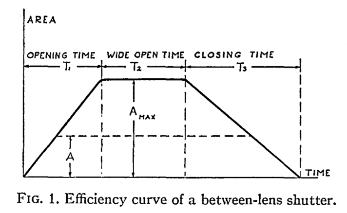

There have been a number of recent threads on how to test focal plane shutters.
No recent threads on leaf shutter measurement, but one can estimate the area under the curve with a measurement at the center and one at the periphery of the shutter opening.
Shutter speed = ((time measured in center + time measured at periphery)/2)
