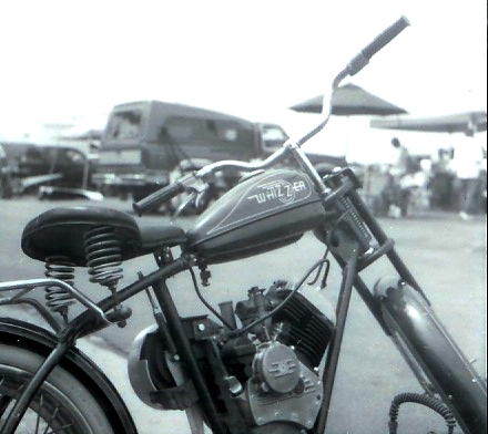

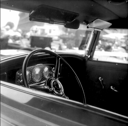

I find myself liking Plus-X in 120 for the tonalities I get with it in bright light situations. I include a couple crappy scans, but I hope it conveys the idea. I use W2D2+ pyro. However, I can never seem to pull the same contrast range when I shoot it low light. Any suggestions or ideas? Thanks!

Not sure exactly what you mean by "can't pull the same contrast range in low light".
Looking at the images you posted, they seem to be underexposed a bit (lacking shadow detail). The sky in the motorcycle shot is completely blown white, which could mean overdevelopment. It may be that the tonal range was just too great for any film/developer combo to handle, however. The car interior shot looks better in that regard.
I'd say try more exposure (you'll likely need to shoot at less than box film speed) and then the same or less development time, depending on lighting conditions. Generally, more development is required for more contrast, and vice versa.

Hey. I should have given the caveat that the scans from prints scanned on my fax machine, it works until I can afford a real scanner. RE: exposure, I shoot it at ISO 100. Haven't tried more but I think I will. Keep the suggestions coming! Thanks.
