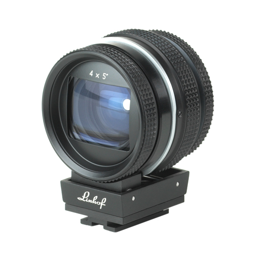

Or you could use one of these:
That's a good idea, but I have, 4x5, 5x7 and Whole Plate cameras to consider.
Matt board is cheaper! :wink:
