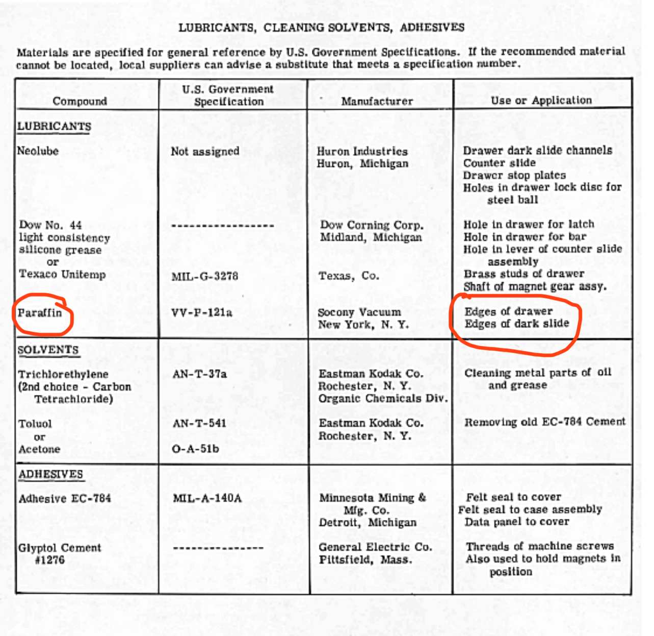

Hey Everyone!
I found this thread when researching how to lubricate my own grafmatic. In the process I found the repair manual, along with their recommended lubricants.
It looks like they used Paraffin and something called Neolube to lubricate the drawers and dark slide.
Here’s the link to the repair manual:
Does anyone have insight as to what a modern equivalent for these lubricants would be? Would using some paraffin wax be sufficient?
Thanks!

The last time I did mine I used a product called Tri-Flow gun lube. It is for use in dry dusty climates and does not leave a wet surface to attract dust.
The paraffin listed is American paraffin not English paraffin.

Since they say parrafin
It's not solid wax(like the canning wax at the grocery store)?

Paraffin in this usage is almost certainly American paraffin, which is basically like candle wax. In the UK, "paraffin" can refer to what Americans call kerosene (the flammable liquid).
Good question. My understanding is that there are 3 types of “parrafin”: liquid (kerosene), solid (paraffin wax, “canning”, and soft (Vaseline). Hot pack or cold pack canning with parrafin, BTW, was deemed unsafe many years ago.

Thanks everyone! I'm going to try the solid paraffin at some point to lubricate the slides. I'll report back with how it goes.
