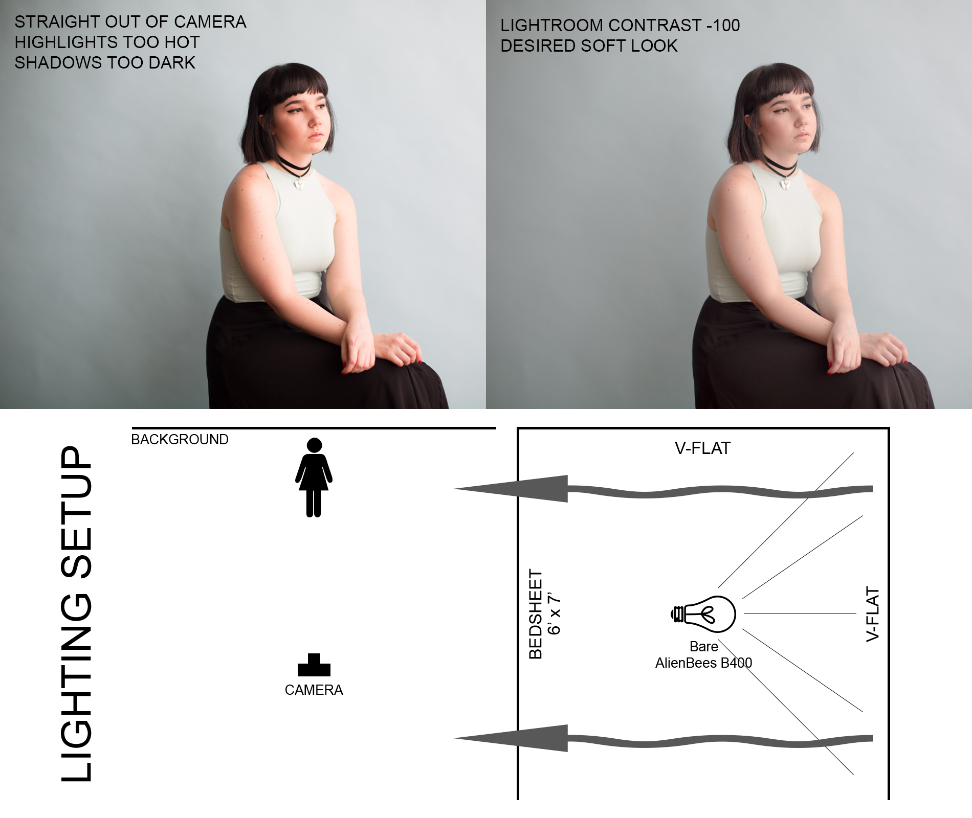

I am trying to recreate the light of a north-facing window (I know itll never be exact but trying my best) by bouncing a strobe off a v-flat and passing that light through a bedsheet. I like the slow falloff but I'm finding that the overall contrast is just too high for me (highlights too hot, shadows too dark). What are some things I can do to lower the contrast in-camera? I have some guesses before my next shoot so if anyone wants to confirm or suggest new ideas that would be great:
1. Put a white v-flat on the shadow side just out-of-frame to kick some light back into the shadow side. My issue with this is that I don't want it to look flat, but at the same time I think I need more light bouncing around. Would that lower the overall contrast, since using bounce fill doesn't affect highlights? I need the highlights to be less hot as well.
2. Push the background/model away from the bedsheet (like you would when feathering a softbox, or pulling a softbox back) to create less harsh of a falloff.
3. Add frontal fill flash, though I can't afford a secondary light right now!

A big reflector on the side she is facing away from will bring up those dark shadows.
Then you can reduce exposure so the highlights aren't that hot.

There's nothing wrong with the OP's main light source. I'll restate that all that is required is giving her shadow side more illumination with a very large reflector, perhaps another sheet of white foamcore or polystyrene.

The film(s) I'm intending to use are 120 rolls of: Portra 160, Portra 400, Tri-X 400, T-MAX 100 - I'm super new to film so I don't really know much about how film stock and contrast work together, and how I control that? Generally I want very low contrast, I hate having to decrease contrast to get the look I want. The original photo is digital yes, but just to test how my general lighting looks. I wish I could make my digital work lower in contrast as well before the editing stage.
@lc-racer: okay I think I can understand that. How does one generally control the tonal range though? Is that done by controlling the exposure settings, main light power and fill light?
@frank: I can add a large reflector, does the angle of it matter? I ask because I have a white wall I can push the entire set towards but it will be parallel to the set, not 45º.

one of these on the shadow side to control balance from light side to dark side
http://www.lastolite.com/panelite-18x12m-silver-white-lllr7231
Adjusting the reflector angle and/or distance will adjust the balance releative to the light side.
I would bring the model and the sheet forward from the background so that the background isn't illuminated as much as it is.
The highlights are too bright because you have got your exposure wrong. That can be adjusted either by lowering the strobe output or by actually metering correctly.

"The highlights are too bright because you have got your exposure wrong. That can be adjusted either by lowering the strobe output or by actually metering correctly."
I don't agree - changing exposure will make the shadows even deeper. If you're holding highlight detail, you're in the ballpark exposure wise - maybe a tad hot but nothing major.
A softbox isn't the answer, either - you've already made a huge softbox, anything you can buy commercially will be much smaller and won't give the look you want. Regular softboxes don't work well for this kind of setup, but you're on the right track by making essentially a 10' softbox.

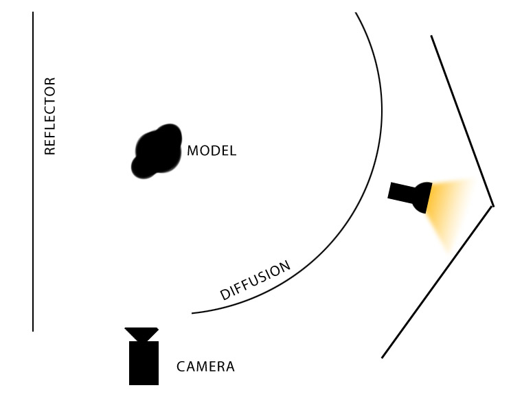

I would bring the sheet closer to the model, and wrap it all the way to camera, but keep the light where it is in relation to the model - this will give you some more wrap, but the light will fall off naturally. Add a BIG reflector and play with its distance.
For soft light, it's big and close. You might find the reflector has to be as close as possible to give the soft fill you want.
From there, you need to dial in your film & processing to control contrast.
And an edit: the size of the light on the v is also really important - get that as big as possible; a bedsheet is pretty extreme diffusion so you shouldn't get hot spots. If you find the sheet is eating up too many photons, hit the fabric store and look at some ripstop nylon - pretty much the same as pricey "diffusion" rags.
