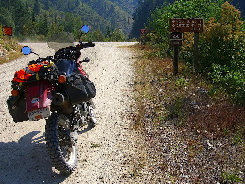

I do a fair bit of riding with cameras. I found that the simply having good padding does the trick. On the 'rougher' trips I use film gear. When offroading, it lives in my backpack unless I'm on longer road trips, in which case I have 2 densities of foam in the saddlebags.
On the sportbike I used to just toss the FM2n & lenses on top of my cloths in my tail bag.
Dual sport setup:
http://lh3.ggpht.com/_2RrwHCfRGNE/SLAvq5GzrEI/AAAAAAAAF54/cP1vOmz1J8k/s800/CIMG3987.JPG
One saddlebag is full of gear with 1 layer of foam and one of bigger bubble wrap (digital on this trip and even that survived with no problems). Here crossing from Idaho into Montana, part of a 9 day trip. BTW, I highly recommend putting the photo gear on the _non_ exhaust side :smile:
