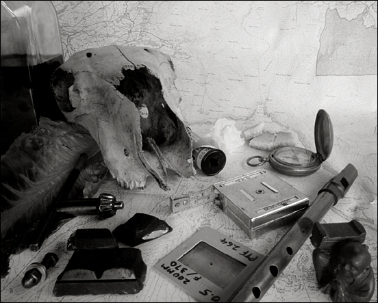

Sandeha Lynch
May 29, 2005
269
Swansea, Wales
I'd agree that 4"x5" Ortho sheet film can be pretty sharp ...
