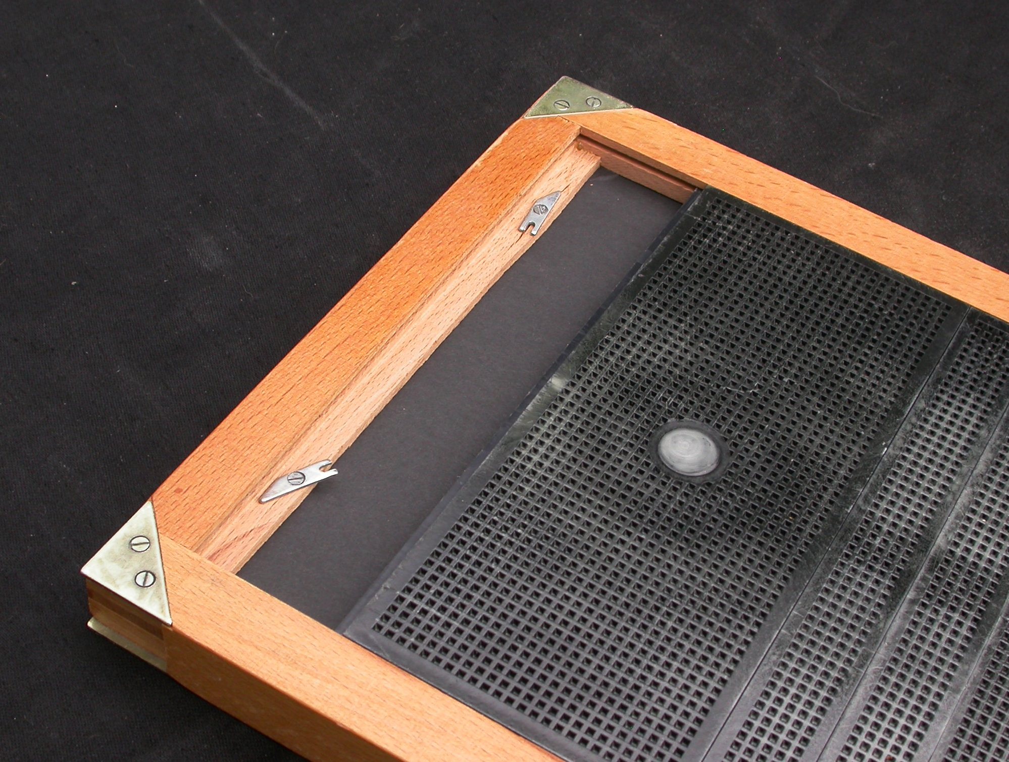

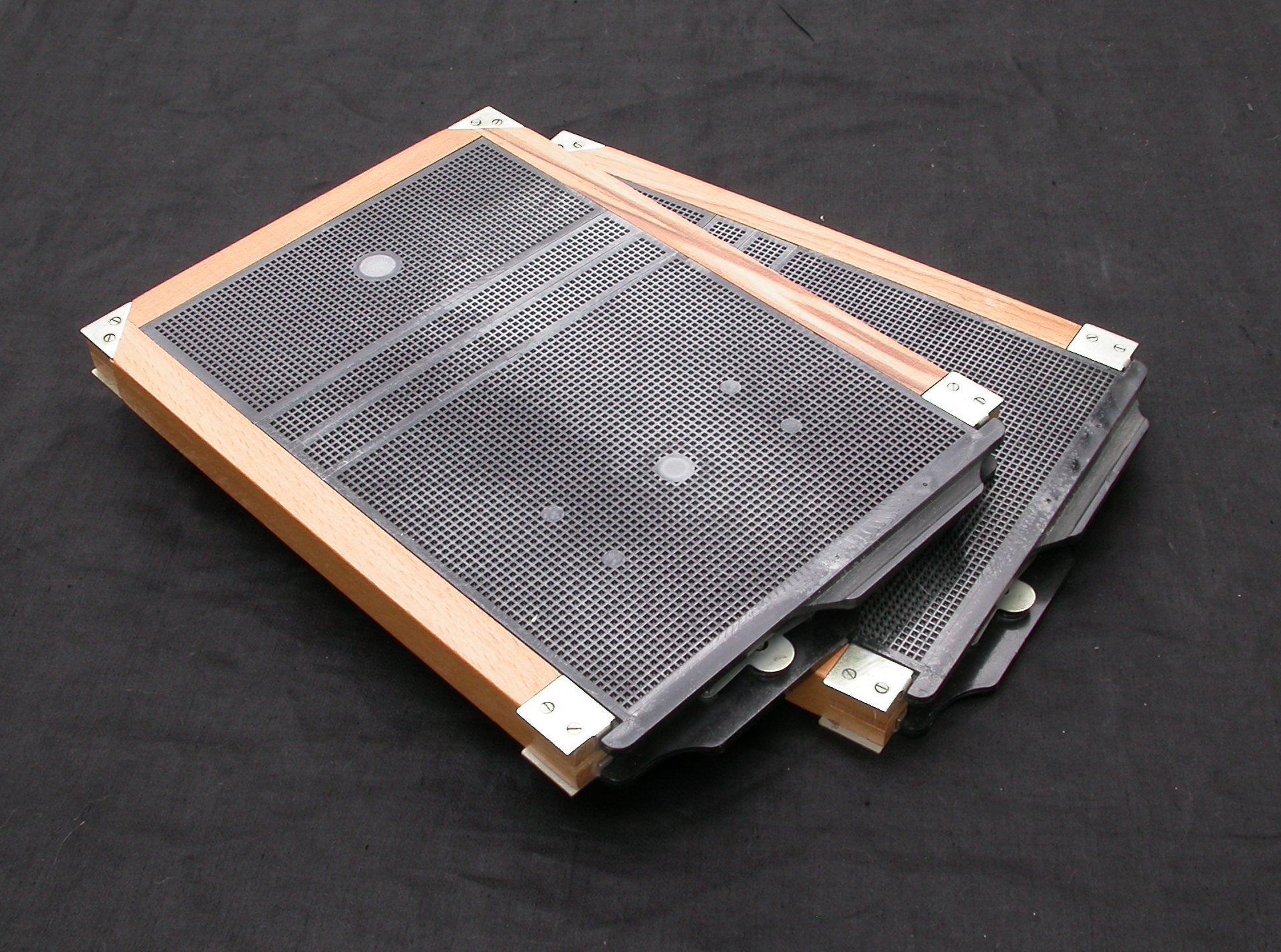

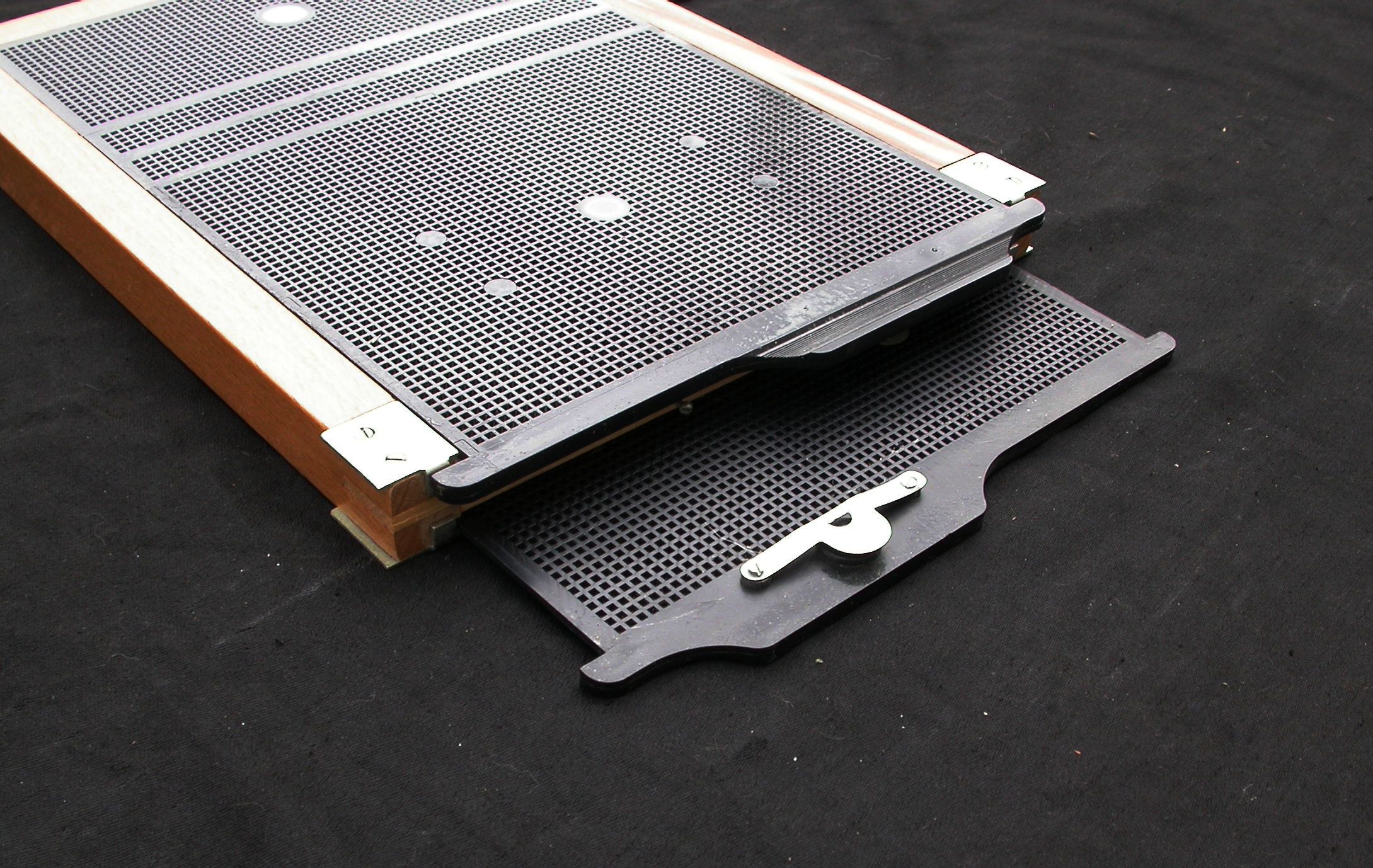

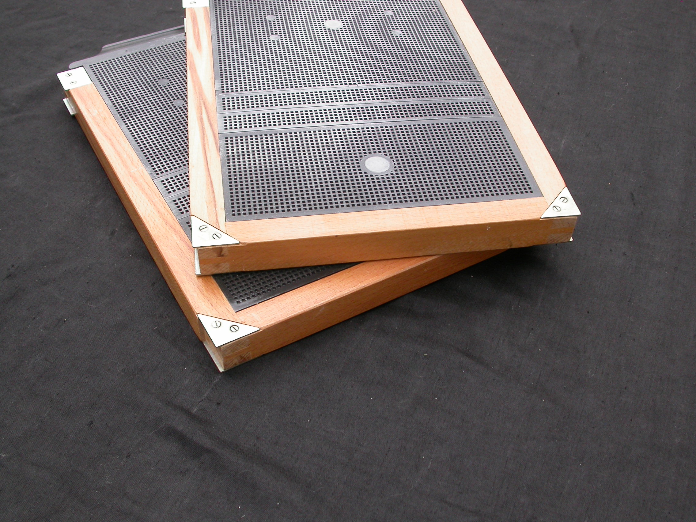

I'll make three separate posts. Here's the first set. I think these were from a Russian camera.
Outer Dimensions: 8-1/2" x 11-3/16" x 7/8"
Inner Dimensions: 7-1/16" x 9-9/16" x 13/32" deep
attachment.php
attachment.php
attachment.php
attachment.php

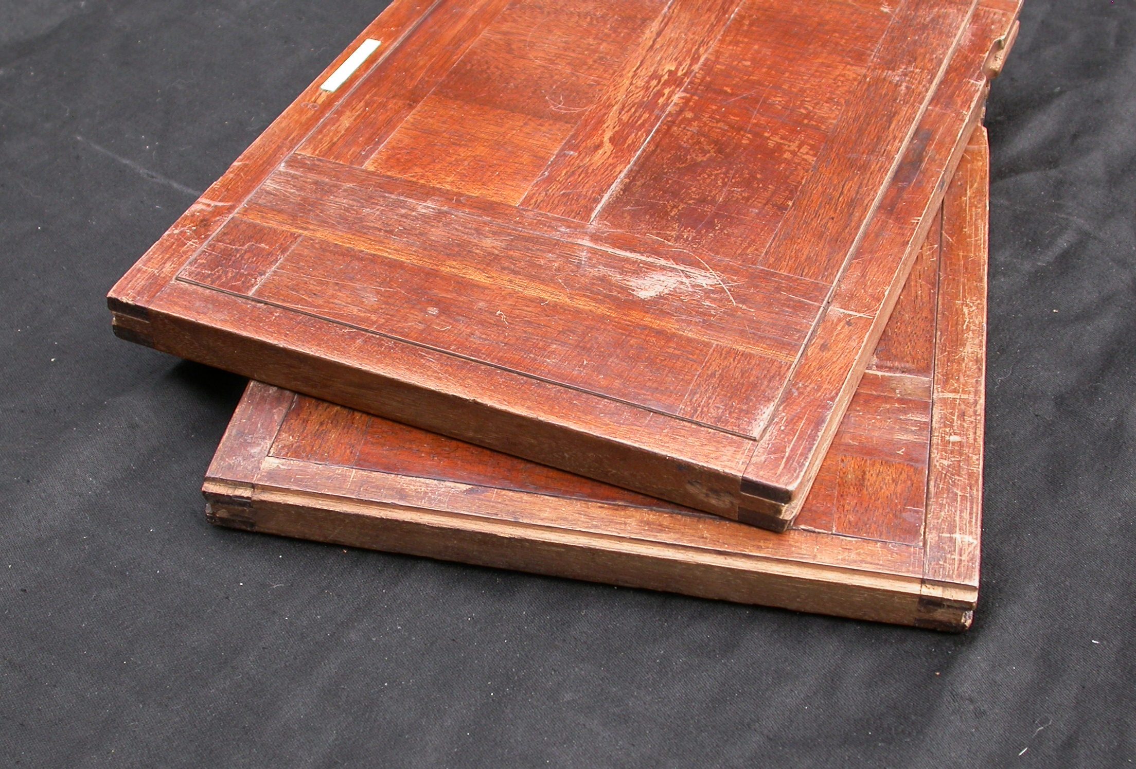

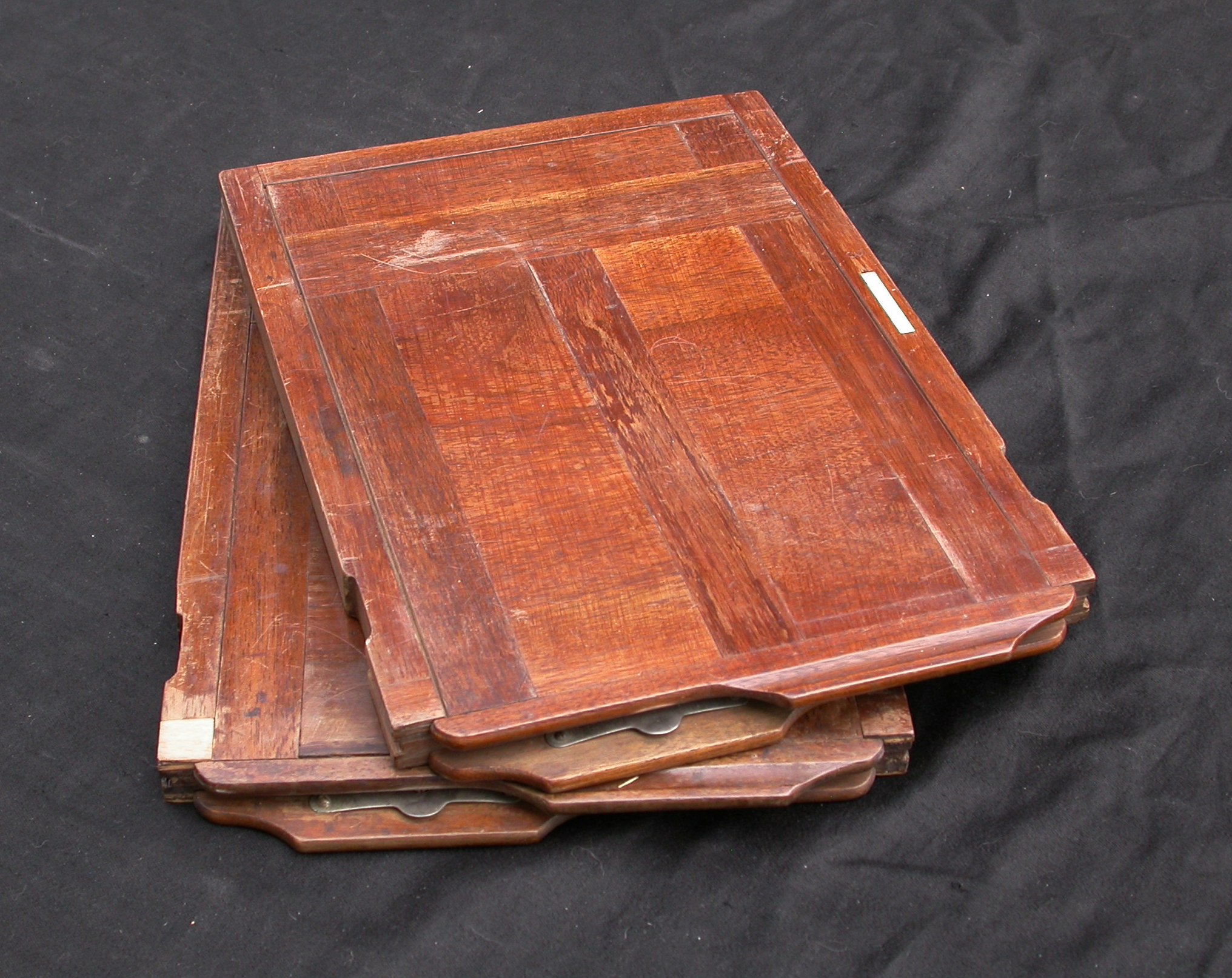

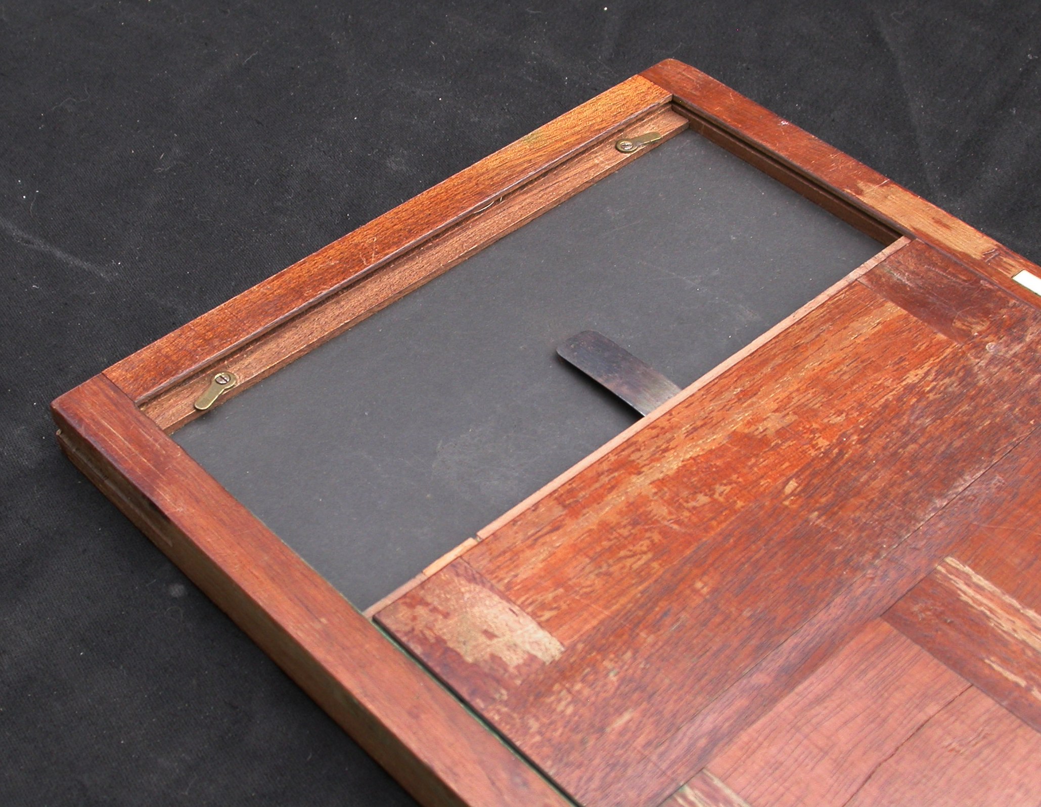

Here's the second set. These are all wood with no metal hardware anywhere except the locking tabs and the spring.
Outer Dimensions: 8-5/16" x 11-3/16" x 5/8"
Inner Dimensions: 7-1/8" x 9-5/8" x 5/16" deep
attachment.php
attachment.php
attachment.php
attachment.php

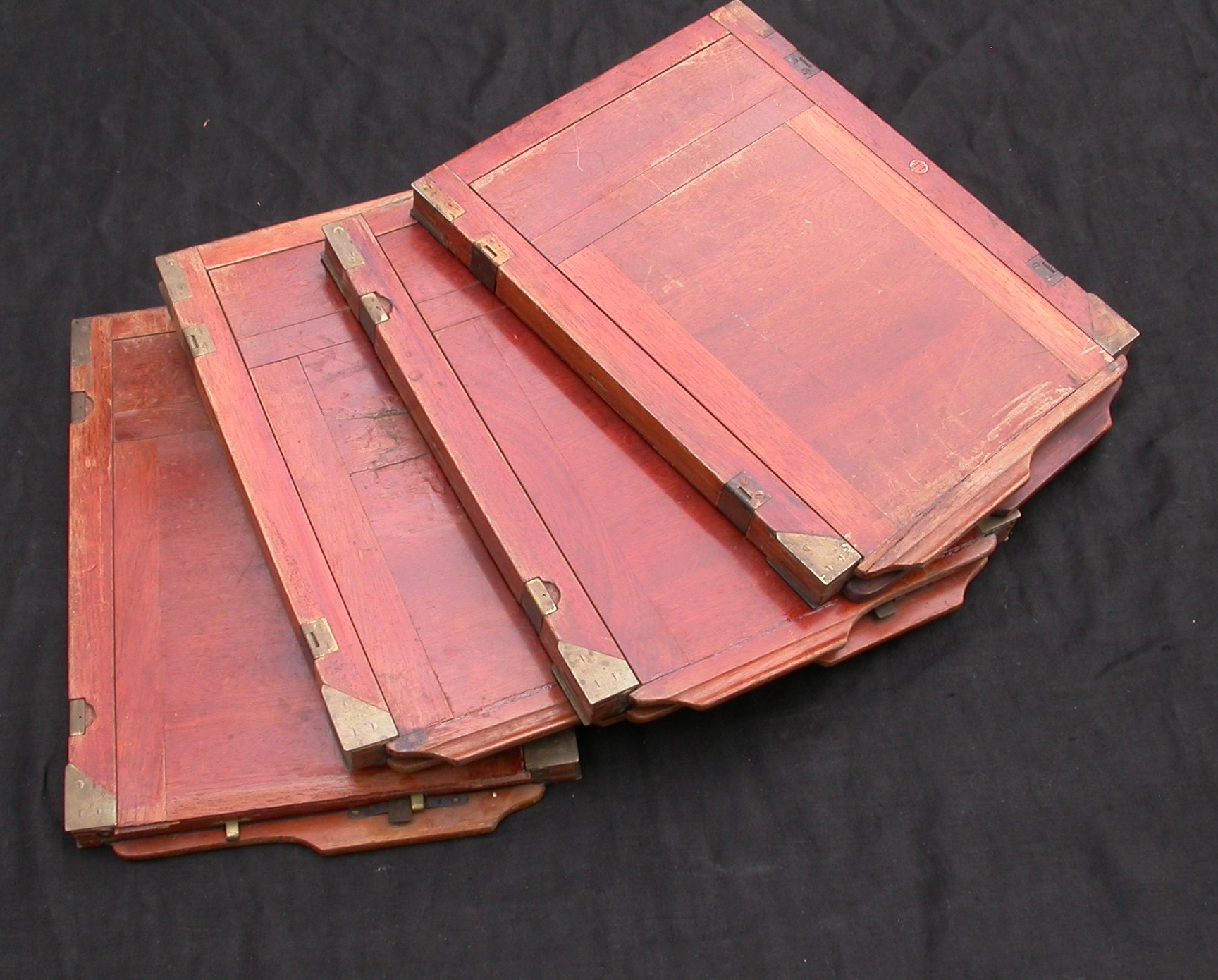

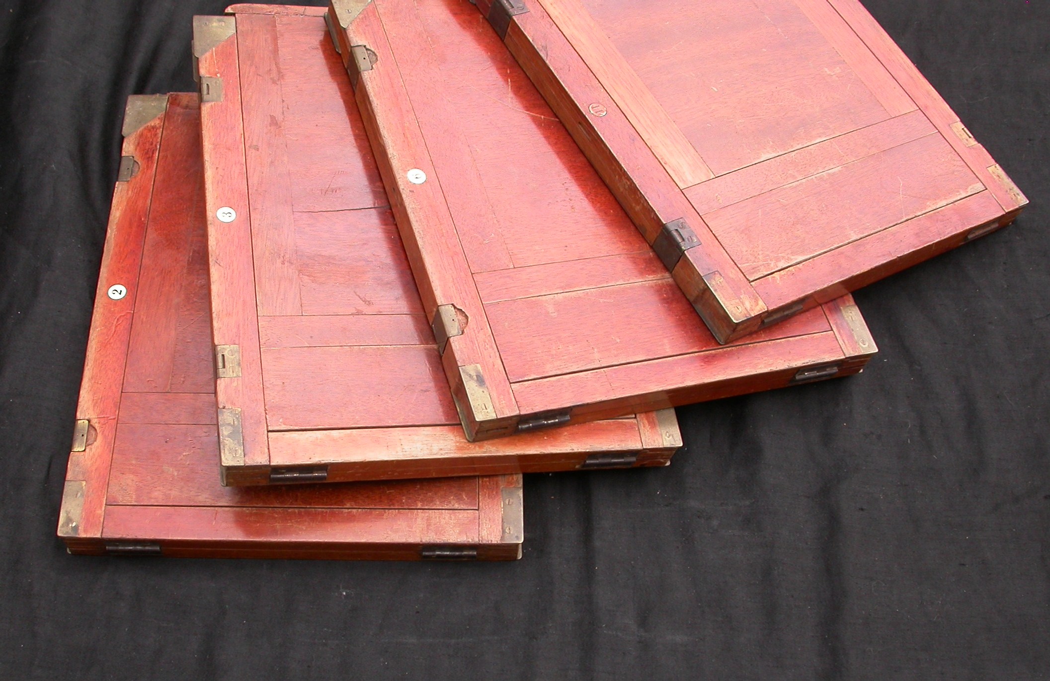

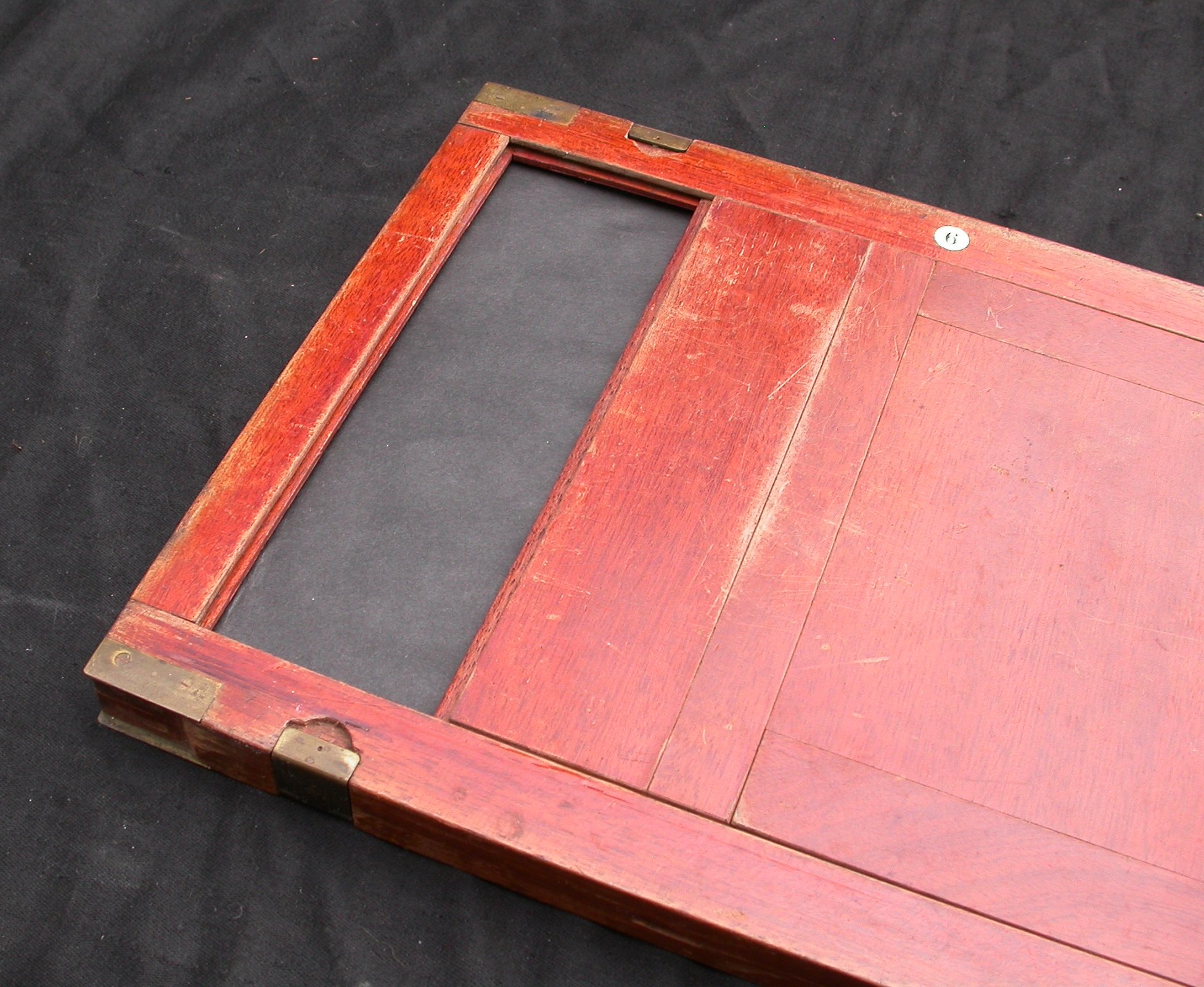

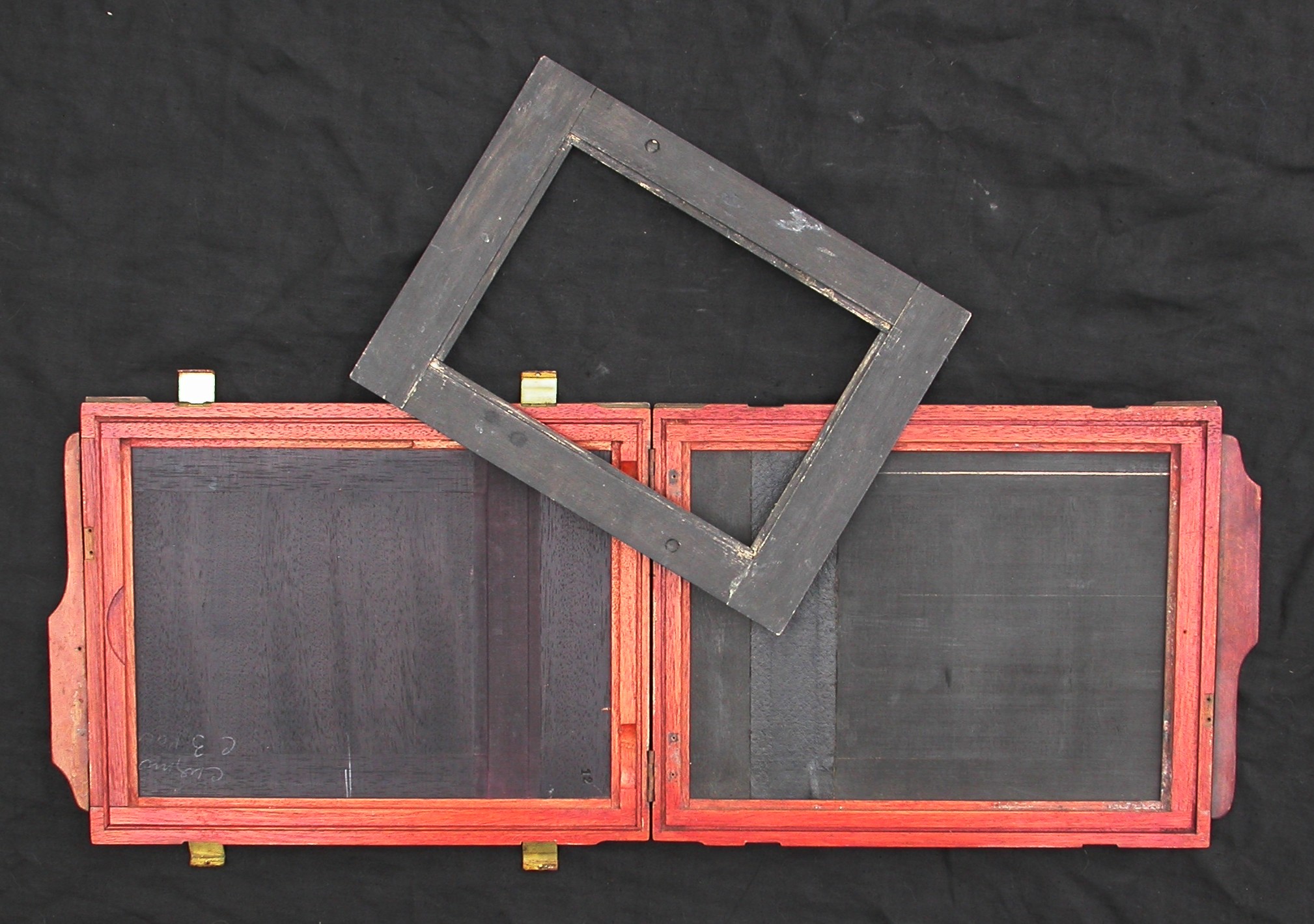

Here's the last set. These have some brass hardware. One of these also has a removable insert (reducer or adapter) on each side.
Outer Dimensions: 8-1/2" x 10" x 13/16"
Inner Dimensions: 6-3/4" x 9-1/8" x 3/8" deep
Insert Inner Dimensions: 4-3/4" x 6-3/4" x 11/32" deep --- NO PHOTOS OF INSERT
attachment.php
attachment.php
attachment.php

I'll say the top two sets of holders are 18x24cm, whilst the bottom set is whole plate, with half plate inserts. I'll gladly stand corrected if I'm wrong.
Old-N-Feeble
Feb 22, 2012
6,805
South Texas
I think you're right about the top set with waffled plastic sides but I don't know anything else.

THIS ONE IS SOLVED: Russian FKD 18cm x 24cm
Does anyone know if these can be modified to fit other cameras? Links?
--- Sorry for replying to my own posts but it seems the best way to add metric measurements without confusing the issue. I can no longer edit my original posts.
There are three different kinds of holders. None have markings anywhere.
SAE...
(ADDED) Metric...
Outer Dimensions: 216mm x 284mm x 22mm
Inner Dimensions: 179mm x 243mm x 10.5mm
(ADDED) Metric...
Outer Dimensions: 211mm x 284mm x 16mm
Inner Dimensions: 181mm x 244.5mm x 8mm
attachment.php
attachment.php
attachment.php
attachment.php
Most likely for an FKD 18x24 camera, the only post war camera of it's type.
The problem with the others is there'[s so many variations between British & Continental Book-form DDS plate holders and there were no standards. I agree on the plate sizes though 18x24cm and Whole plate with Half plate inserts.
Should add the edge fit is also critical.
Ian

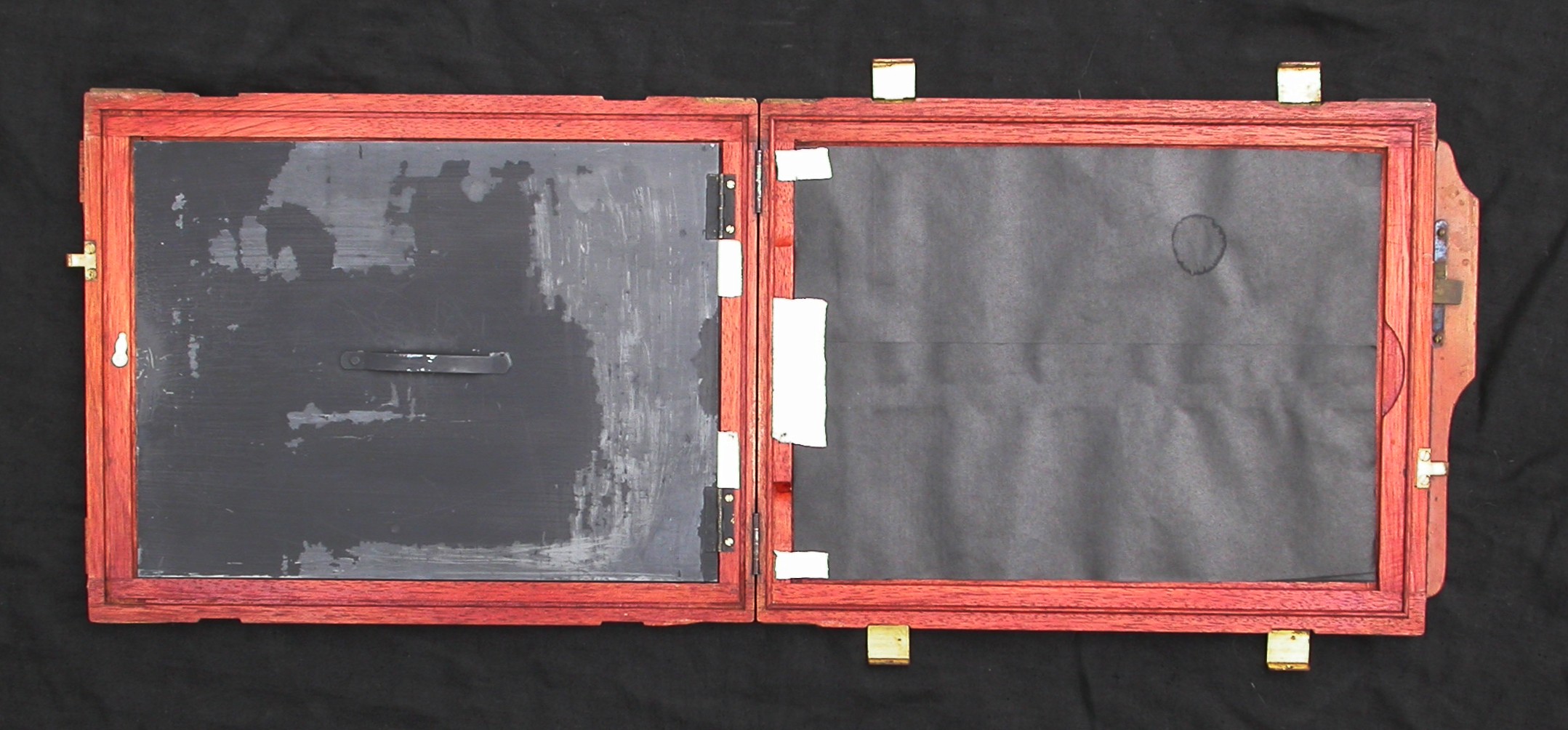

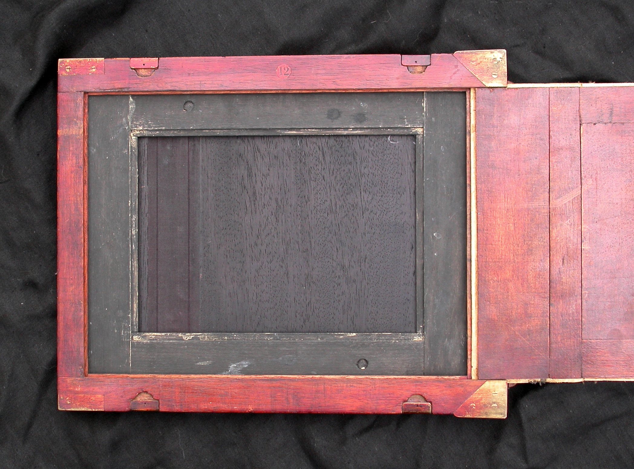

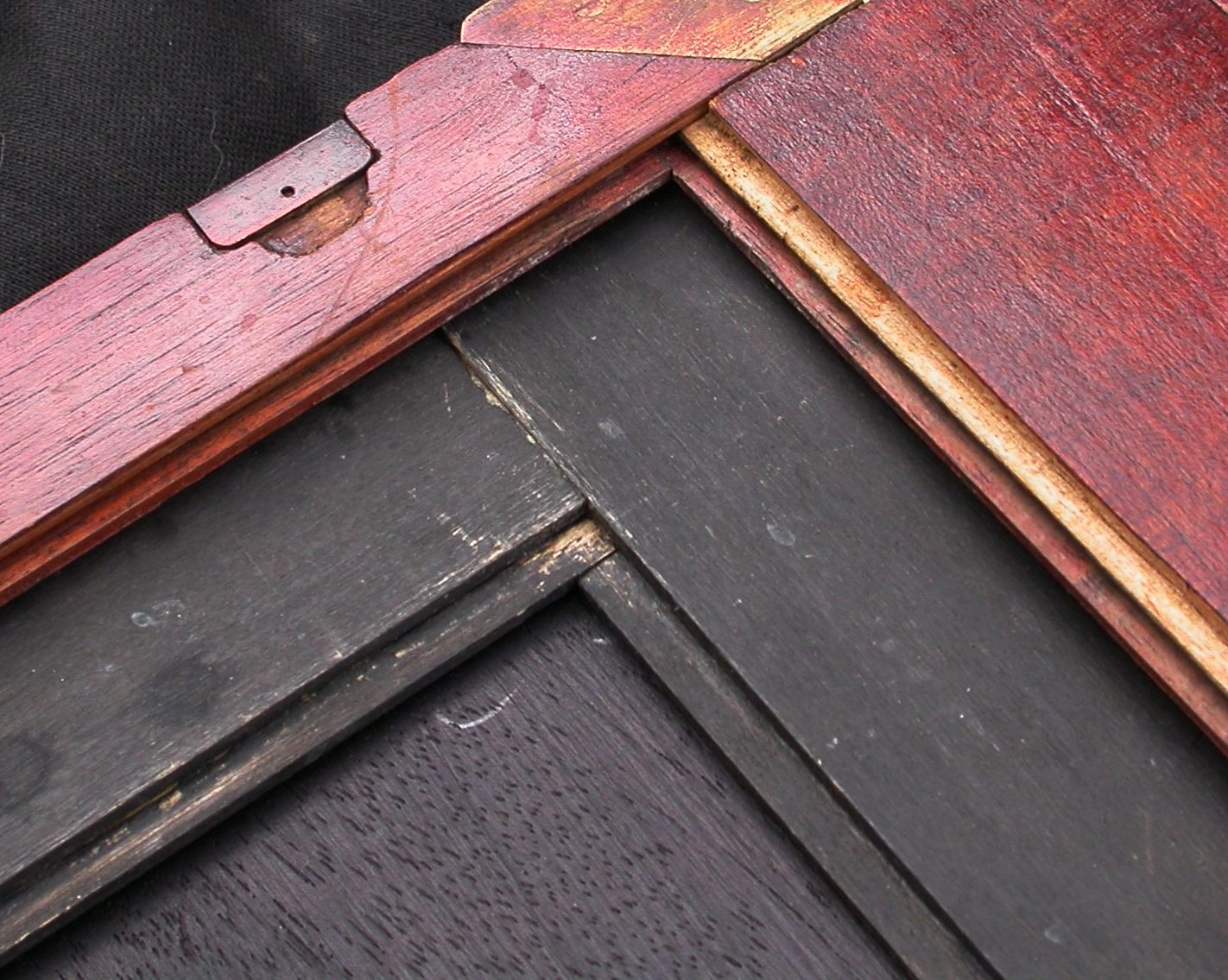

Old-N-Feeble
Feb 22, 2012
6,805
South Texas
Metric measurements added...

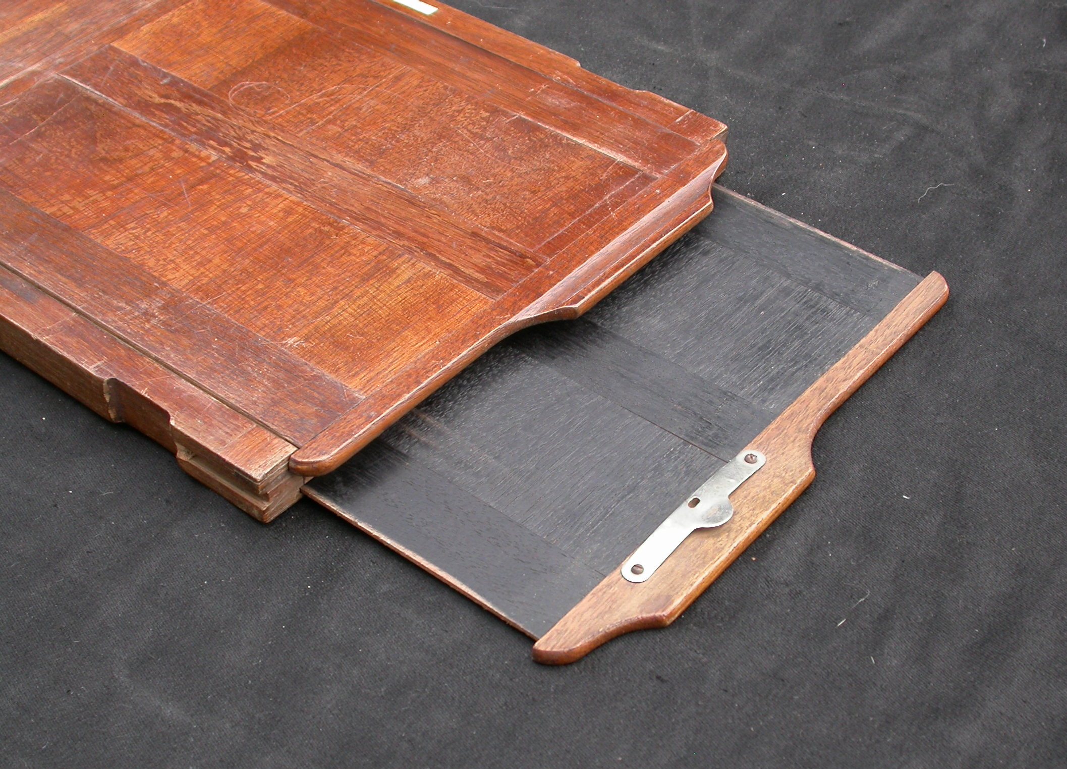

Images of insert added but could only make them attachments (thumbnails)... click to see larger.
Also added images with this film holder hinged open (two different holders of the same make/style).
(Added) Metric...
Outer Dimensions: 216mm x 25.4mm x 20.5mm
Inner Dimensions: 171.5mm x 232mm x 9.5mm deep
Insert Inner Dimensions: 120.5mm x 171.5mm x 9mm deep --- NO PHOTOS OF INSERT YET
attachment.php
attachment.php
attachment.php
Old-N-Feeble
Feb 22, 2012
6,805
South Texas
Ian
Thanks, Ian.
RE Fed FKD 18x24cm camera... yes, that definitely "rings a bell" in my mind. I believe this is correct. Do these holders fit any cameras other than the Fed or can they easily be modified to fit other cameras?
By "edge fit" do you mean the shape of the wood and the hardware? I was hoping the photos would show this. Are there any other photos I should provide which would help identify these holders?
Ian Grant
Aug 2, 2004
23,273
West Midland
Holders can sometimes be modified, depends how adventurous someone wants to be. It can be quite hit or miss trying to get holders that fit European cameras, the US standardised much earlier in the early 1900's although there's a few exceptions
Looking again I think your photos are clear enough.
Ian
Old-N-Feeble
Feb 22, 2012
6,805
South Texas
Thanks, Ian. I added photos of the wood and brass holder hinged open. The other two types of holders don't hinge open like that.
Please correct me if I'm wrong: I'm guessing the holders with brass hardware are for wet plates. The paper backing with stains seems to be a hint??
I'm sure the the Russian FKD are for dry plates.
I can't guess what the all wood holders with no brass hardware are for... wet or dry??

The mahogany holders would have all been dry plate holders, probably 1890's - 1910 or so. The 18x24cm holders might be as new as the 1970's or 1980's, and maybe even more recent.
Old-N-Feeble
Feb 22, 2012
6,805
South Texas
The mahogany holders would have all been dry plate holders, probably 1890's - 1910 or so. <snip>
Thanks, Dann. Are you referring to the all wood holders with no brass hardware?
These... ?
Ian Grant
Aug 2, 2004
23,273
West Midland
They are all dry plate holders and similar were still made up until the 60's by Gandolfi (also sold as Watson) they gave the option of backs for Book-form or modern international plate/film holders. Other companies switched to the International standards after WWII except the Russians.
One major problem is that manufactures often had more than one type of plate holder of the same size, I have 4 or 5 different Thornton Pickard 1/4 plate holders all quite different.
I'd check the widths against International sizes like 18x24/10x8 and Whole plate.
Ian
DannL.
Oct 13, 2013
617
I agree with Ian that all would have been for dry plate. But, that doesn't mean they were used exclusively for dry plate. My 5x4 is one of those. The holders were once loaded with paper negatives while still wet. The holders may exhibit residue of dried emulsion and corrosion had someone tried to load them with wet plates or paper.
