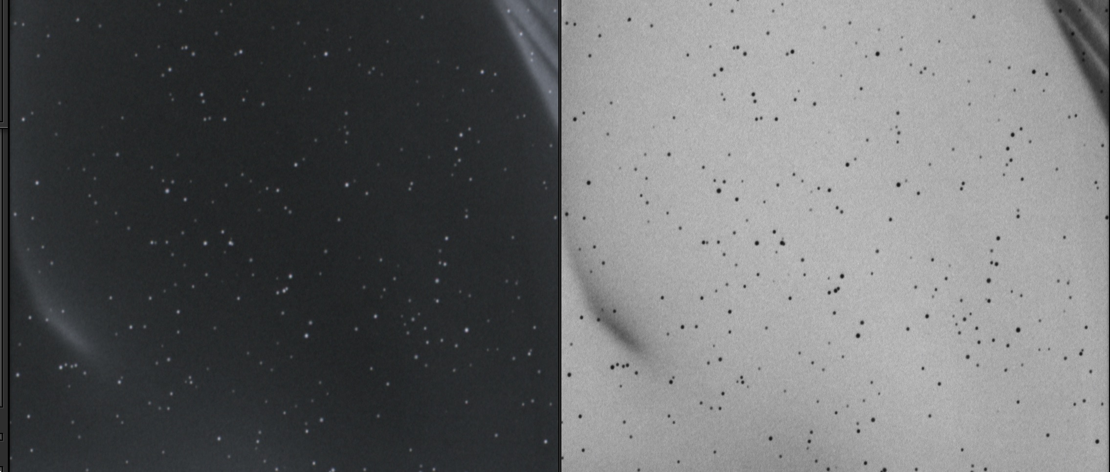

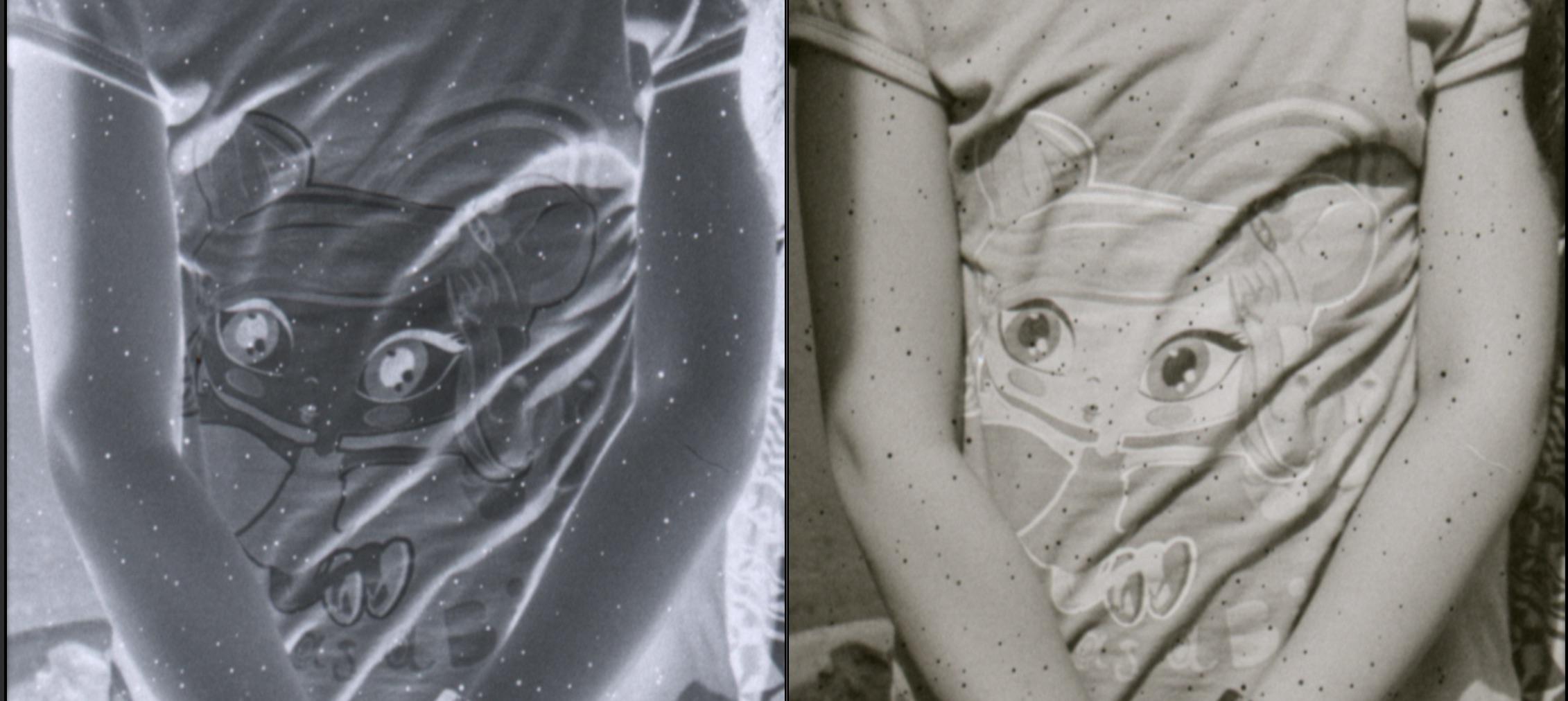

Please see the negative/scan above.
I'm getting many spots on the negatives (Orwo UN54) developed with home-mixed developer of late. I've been using this developer for some time and only in the recent times the spots have started appearing. I use RO water for preparing the developer concentrate as well as working solution. I stir well after adding the developer concentrate and carbonate solution to water and wait till all the air bubbles die out before pouring the working solution to the tank. I bang the tank hard several times after pouring in the working solution (and also after each round of agitation) to knock off airbells. I have tried presoak, filtering the developer concentrate, filtering the carbonate solution but the spots won't go. I get the spots with both citric acid stop bath and water stop bath. The scanner is fine and I've verified by scanning old negatives. AFIRC I started facing this problem after switching to a different brand of Sodium Carbonate Anhydrous but the producer is known for quality chemicals and claims that Carbonate is 99.9% pure.

The amount of gunk needed to do that would be easy to spot in a solution so I'm assuming that the gunk gets to the film in the dark.
It might be precipitate that happens while inside the tank. You could do a dummy process with an empty reel and remove the lid to check the liquid after every inversion/bang on the table. Or develop a test roll in whatever developer you have handy that doesn't have any of the Sodium Carbonate in it. D23 maybe?
Only other thing I can think of is if you use a changing bag. fwir, the rubber innards can start shedding bits when touched. One roll loaded under the bedsheets would test that.
Great suggestion. I'll try this and check if any precipitate is being formed while the working solution is inside the tank. However, I haven't noticed precipitate in the spent working solution at the time of dumping it. Perhaps I should filter the spent working solution and check if it leaves any residue on the filter paper.
It could be developer specific issue (and possibly due to the Carbonate). Just now I developed a test roll of the same film (Orwo UN54) in Rodinal and the negatives are at present drying. Will scan the negatives tomorrow and check if there are spots in them.
I also developed a test roll of a different film (Orwo N74+) in the same developer as before and this should tell me if it is a film specific issue.
I'm using a changing bag and will try your idea.
This was very helpful. Thanks again.

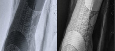

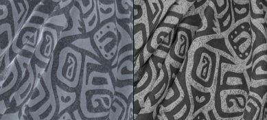

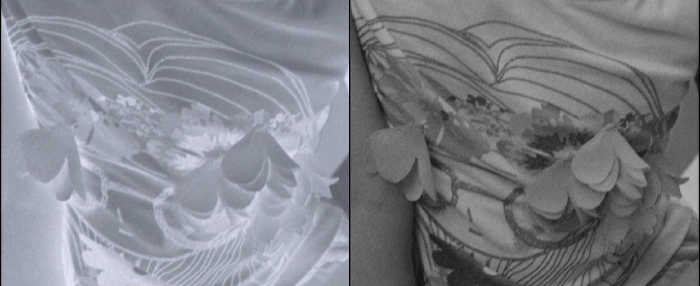

I developed a test roll of Orwo UN54 in Rodinal. Different camera same dark bag. The negatives turned out fine without any spots on them. Screen Shot 2018-04-21 at 12.29.20 PM.jpg
I also developed a test roll of a different film Orwo N74+ in the original developer using the same carbonate. Again different camera and same dark bag. This roll also turned to be fine and there're no spots. Screen Shot 2018-04-21 at 11.31.38 AM.jpg
So it could be the camera or the developer/film combination. So I'll develop a test roll again and see if the problem persists.

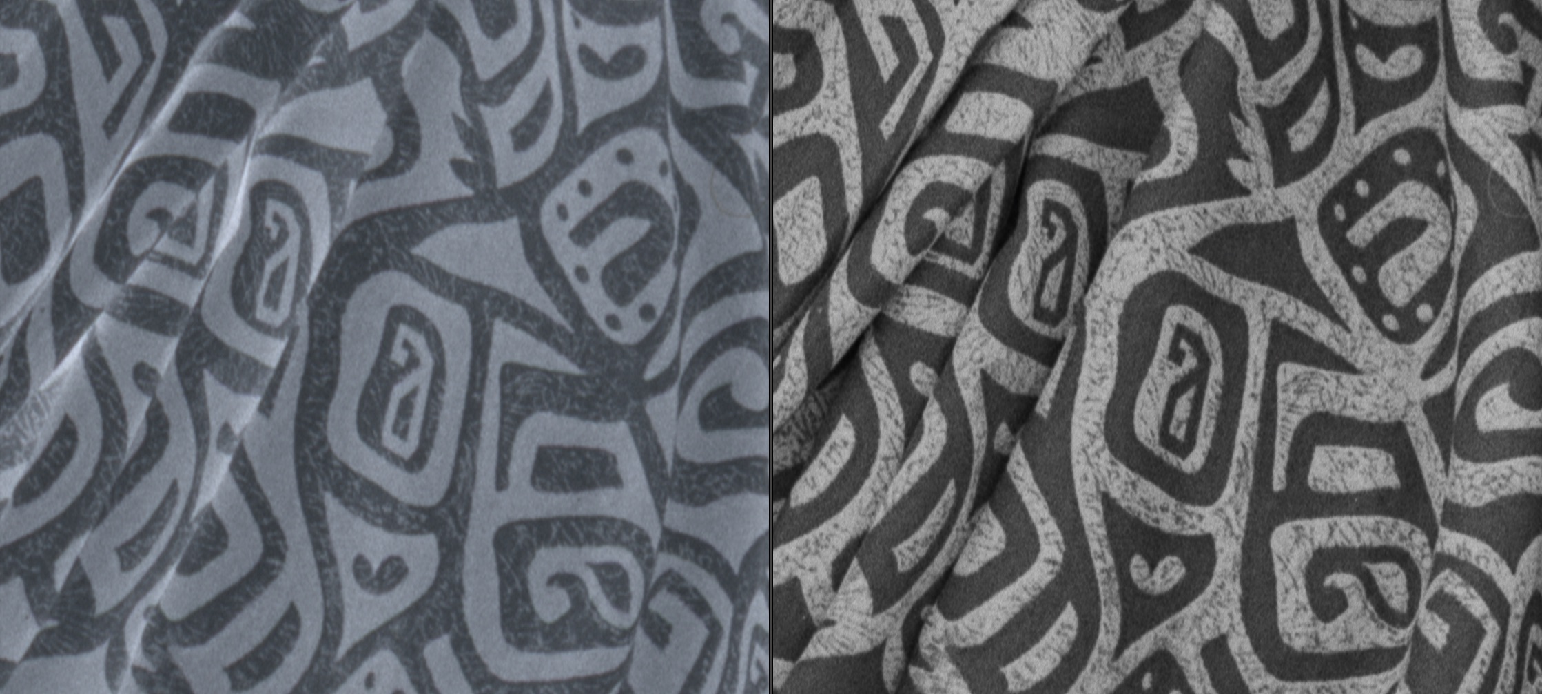

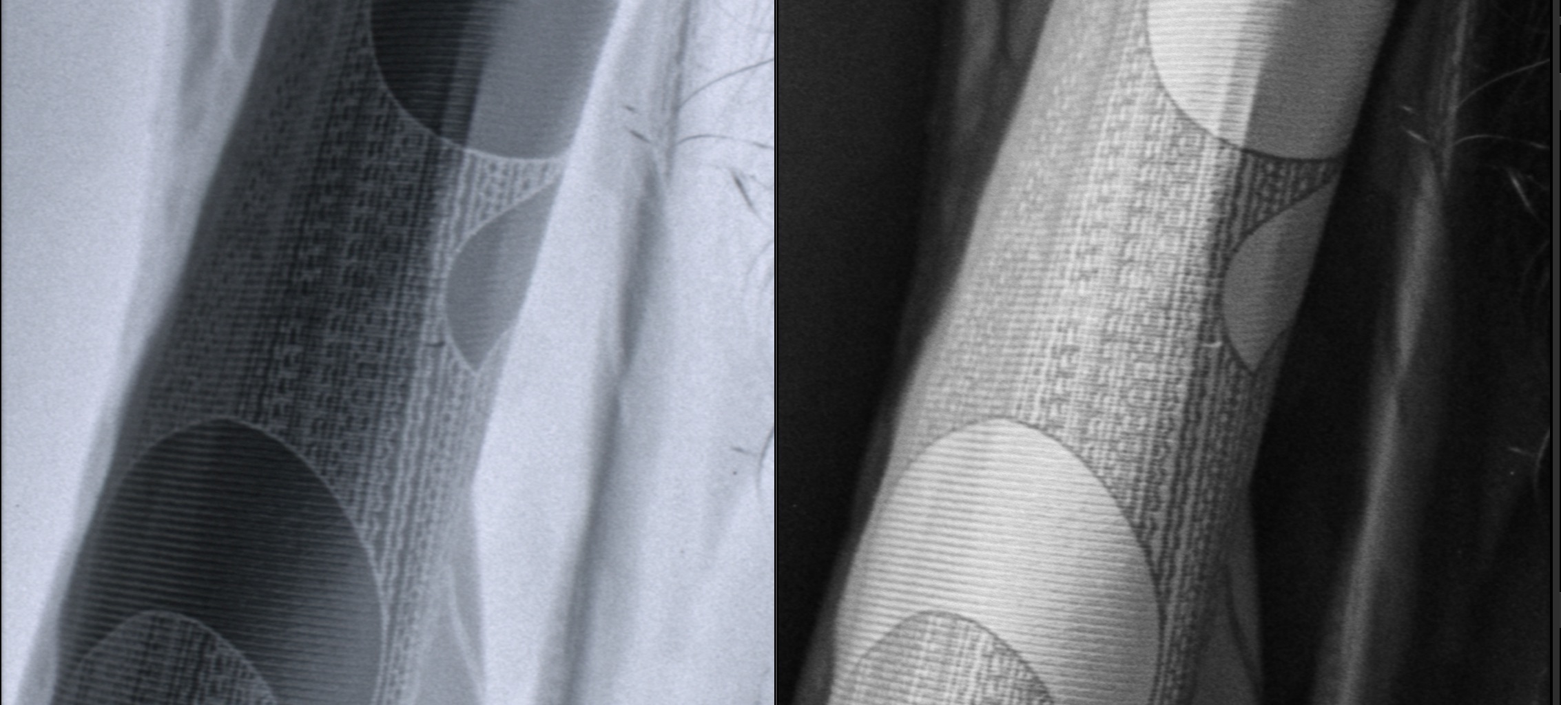

Last evening I developed a test roll of Orwo UN54 and Orwo N74+ together - same camera same dark bag. The former showed many spots and the latter showed none. Screen Shot 2018-04-23 at 2.03.15 PM.jpg Screen Shot 2018-04-23 at 2.03.52 PM.jpg
So the spots have got to do something with Orwo UN54 film. It could be emulsion quality issue that surfaces only when carbonate is used as the alkali. I'll switch to Rodinal for now as at least the one test roll of Orwo UN54 that I developed in it came out quite well.

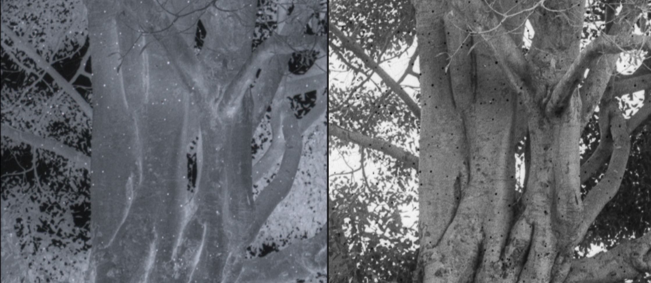

Which developer are you using? Apparently it is not a good match with the Orwo UN54. Especially looking at the last pic you posted, it is not only white spots but also grey spots.
The recommended developer / developing times are given by the manufacturer here: http://www.filmotec.de/wp-content/uploads/2010/08/V-I-VV-1182.pdf (in German)
The developer does not contain any alkali beyond the sulfite and a small amount of borax, so maybe the ph of your carbonate developer is too high and affects the emulsion.
