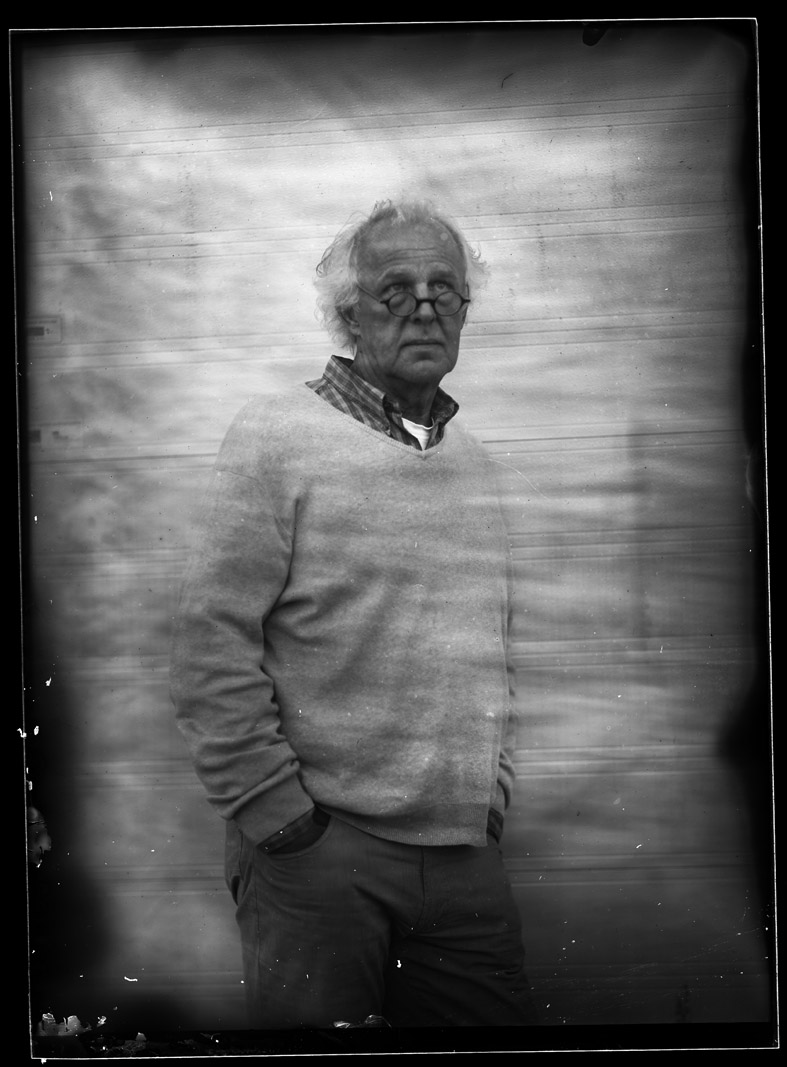

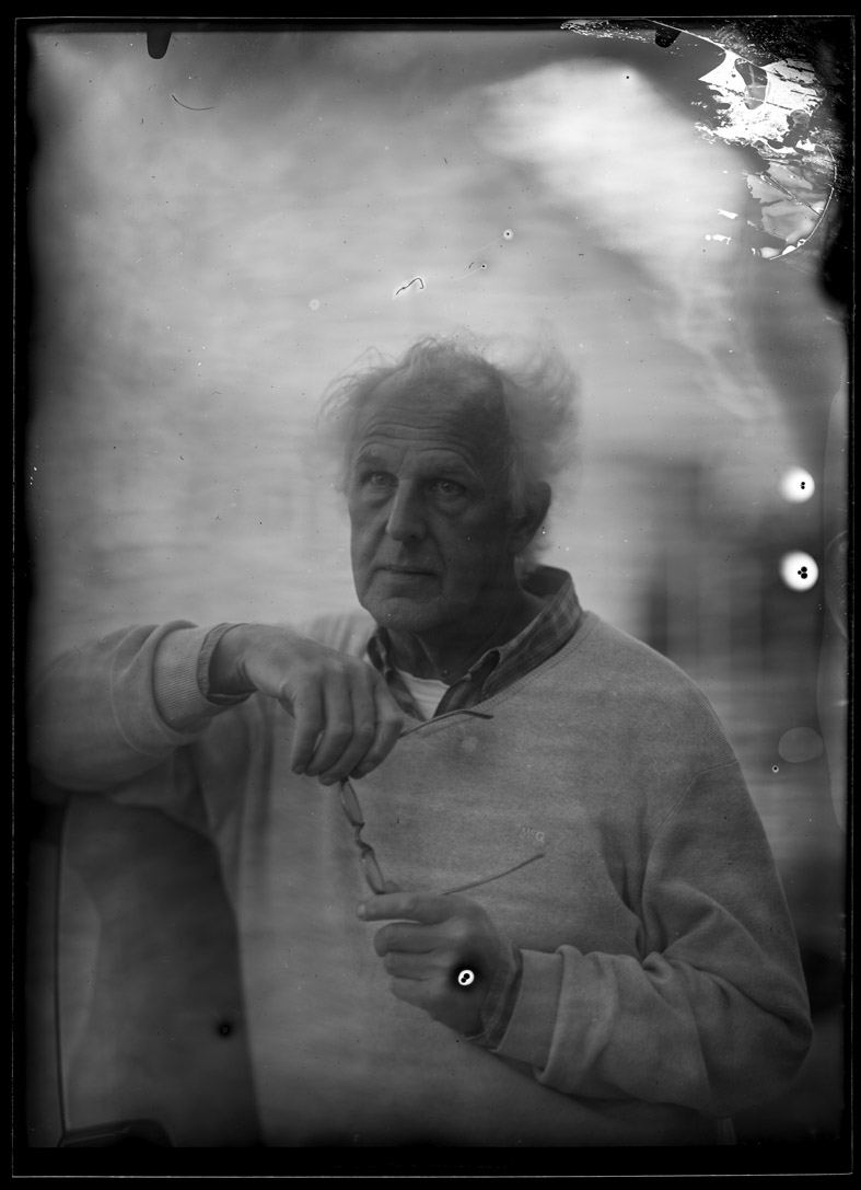

I followed a course with dry plate once, see: http://thetoadmen.blogspot.nl/2012/09/making-dry-plate-glass-negatives-with.html
I made two portraits of a fellow participant on that day, using Rollei Black Magic (liquid emulsion kit):
The streaking in the second image is from too much agitation during tray development: it's not photo paper.
(BTW: the horizontal straight lines are from a garage door he is leaning to).
