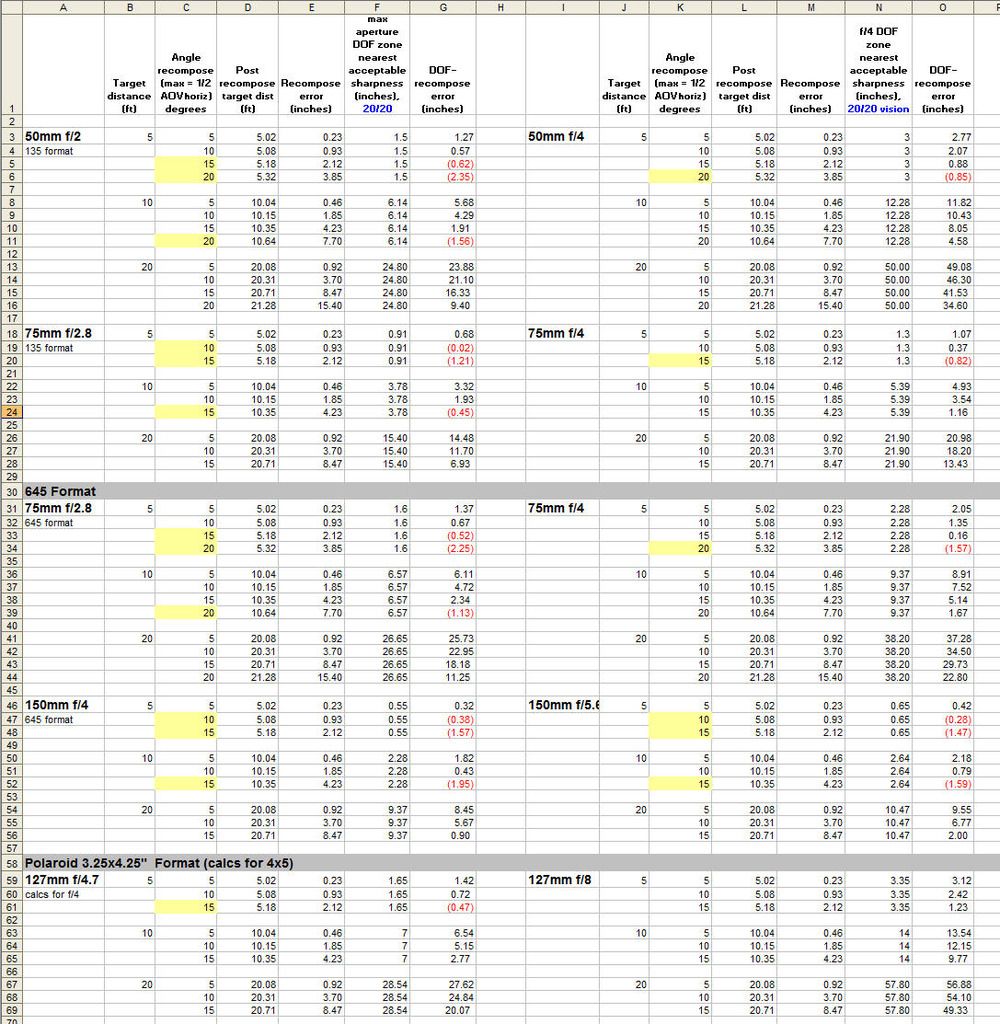

I thought about this but with all cameras, focus and recompose would cause the eye to be out of focus if you are at an angle at all, no?

Close enough in my experience. If you think it makes a difference then raise the entire camera without tipping it upwards, until the RF patch is on the eye.
Relative to camera position it's not that big a change in distance to the subject.
Focus recompose is primarily an issue when using a relatively WA lens for the format, where the long dimension angle of view of the lens extends 15 degrees or more from center. Less than recompose angle of 15 degress is generally masked by the fundamental DOF zone.
For 135 format, shooting with 50mm or shorter WA presents the possibility of focus-recompose error. Depending upon angle, the focus error computes to about 3-6", so after focusing and recomposing, simply SUBTRACT 3-6" from the apparent distance to refocus correctly...and you only need to do this when recomposing 15-20 degrees. Trying to adjust focus per the distance scale by only 3-6" can be problematic.
But that 15° off center is already exceeded by a standard lens. I guess you got a typo.

The general ground glass area of the focusing screen in a reflex camera is imprecise enough to allow focus error itself. OTOH, the central focusing aid on most 135 and many rollfilm SLRs can cause focus recompose error. However, if you run numbers, you see that focus recompose error can be hidden as an issue until you recompose by 15-20 degrees (which is about half the horizontal dimension angle of view of the normal lens!)
Here is a chart for a viewer with 20/20 vision, showing multiformats with normal and short tele lens at wide open and stopped down about -2EV, at various subject distances and angles of recompose.
Yellow boxes indicate where DOF fails to mask the focus-recompose error.
Interesting chart.
(But now I have to find a catchy name for it before filing.)
