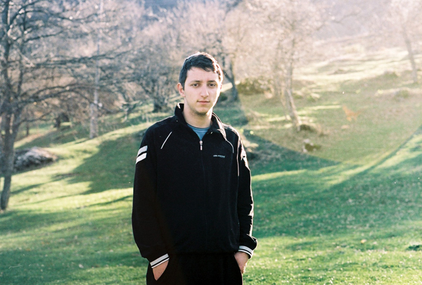

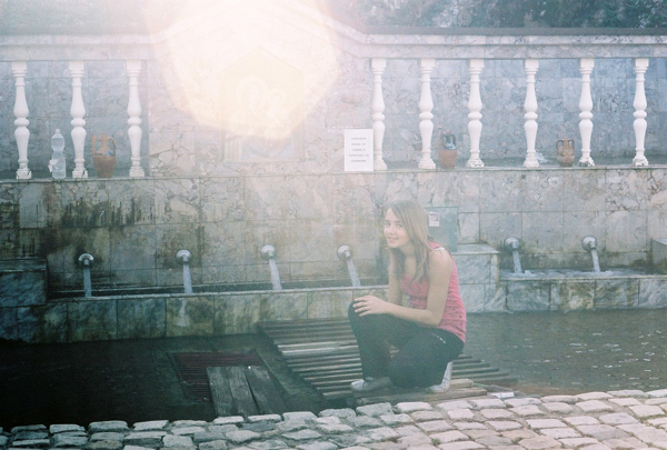

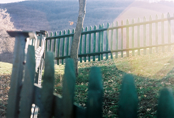

I am using Minolta SRT 101 with 58mm 1.4 and i am happy from the sharpness, colors, contrast etc, and since i am using this lens quite often i want to add a lens hood for this lens and to improve the images.
I am shooting mostly portraits, people, family etc with this lens and i don't want to have huge lens flare because of the open aperture, and i am getting lens flare even when the sun comes from the side (as on pictures #1 and #3 in the attachment).
I found out that the original lens hood for this 55mm filter size is D55NA hood.
Where i can buy that hood, on what price (if someone knows), and is there a chance that some other hoods might fit the lens?
Also, is clever buying a UV filter for the same lens? Will it change something. And if i need one, which UV filter should be good?
I attached some examples.
thanx in advance.
Stevco.
P.S. - I found this 55mm UV filter SIGMA, would it fit on my lens? http://pixplus.com.mk/index.aspx?ta...ctid=479&directoryid=+173&ctrl=productdetails

Any after market 55mm lens hood should work fine for this lens, that is what I did for my copy, and as much as I like the lens it is prone to flare.

A hood will help tremendously, also, just being more conscious of where you point your camera will make the biggest difference. In all your examples, the sun is obviously very near to your frame, and thus, unavoidable flare, probably even with a good hood.

The 58/1.4 has nice bokeh and is a generally good standard lens. I have two of them. It's always advisable to use a hood with a fast lens. The issue here is that the coating on the 58/1.4 is not as advanced as the coating on later standard Rokkors. All of the 50/1.7 Rokkors are well coated and all of the 50/1.4 Rokkors are also well coated. I most cases I block flare by shading the lens with one hand. That's just laziness because I have many hoods. In most cases where flare is an issue the light is fairly strong. I would look for an inexpensive 50/1.7 Rokkor (MC Rokkor X, MC Rokkor PF, MD Rokkor-X or MD) and use that in flare prone situations.
