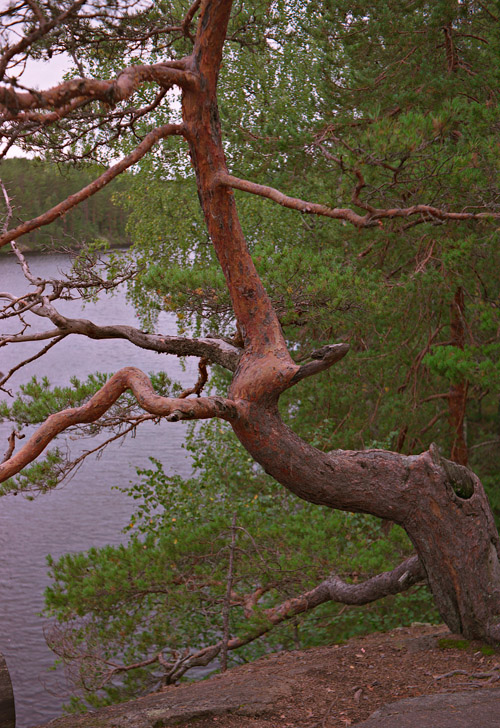

I recently bought a Bessar RF to dabble in what this sort of camera can do. It has been both a revelation and a frustration. My problem is uniform focus across the image. The lens seems to swing a little to one side (probably as a result of the design that allows it to fold ;-) ) . There is some play there, but it fells much less than a degree of movement. I'm used to movements with my 4x5 camera and given that I use a 90mm lens (not unlike the 105 Skopar on the Bessar) I don't think this amount of 'free play' is enough to account for what I'm seeing.
For example, with this image

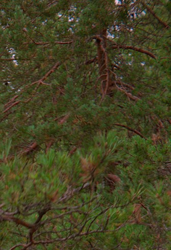

it seems that focus is just 'poor' at the edges, however close examination shows that its actually a tilt ofthe focal plane (camera in portrait orientation).
Looking at the top right in more detail a pine tree quite further back which is in focus while the pine needles of "my tree" are starting to fuzz up badly.
Looking at the middle of the focal plane the "my tree" is in focus, but the middle of that pine tree above is out of focus (consistent with the DoF created with f8).

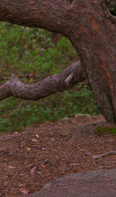

then looking further to the bottom its apparent that the focal plane is comming closer to the camera

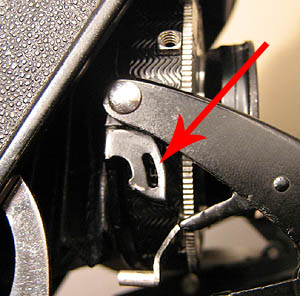

The lens/shutter sits very rigid in place on my RF-Bessa, with no play at all. Check the camera shutter assembly and standard carefully to find out if something is bent. On both sides of the shutter assembly there are slightly rounded metal stops that are there to hold the lens and shutter rigid.
yep (looked at images, thanks for that) thats the spot. I can feel some free play in that whole 'plate / mount' on the end of the bellows. Perhaps a mm or maybe less. I don't think its enough to cause the alignment issue I'm seeing, but it might be.

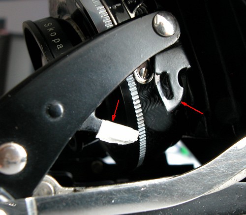

I found last night that by shimming a little the the two small arms on either side of the clamp for the "front standard" (see below)
The little 'arm' at the bottom arrow pushes against the surface on the lens standard as it closes. I put some layers of 'masking tape' on there to add some thickness and effectively push the top back more. I this seems to fix the lens alignment (and makes the entire system more rigid too)
A quick test with a ground glass and then with a cut down sheet of film this morning confirms that focus is now pretty parallel with the film plane
