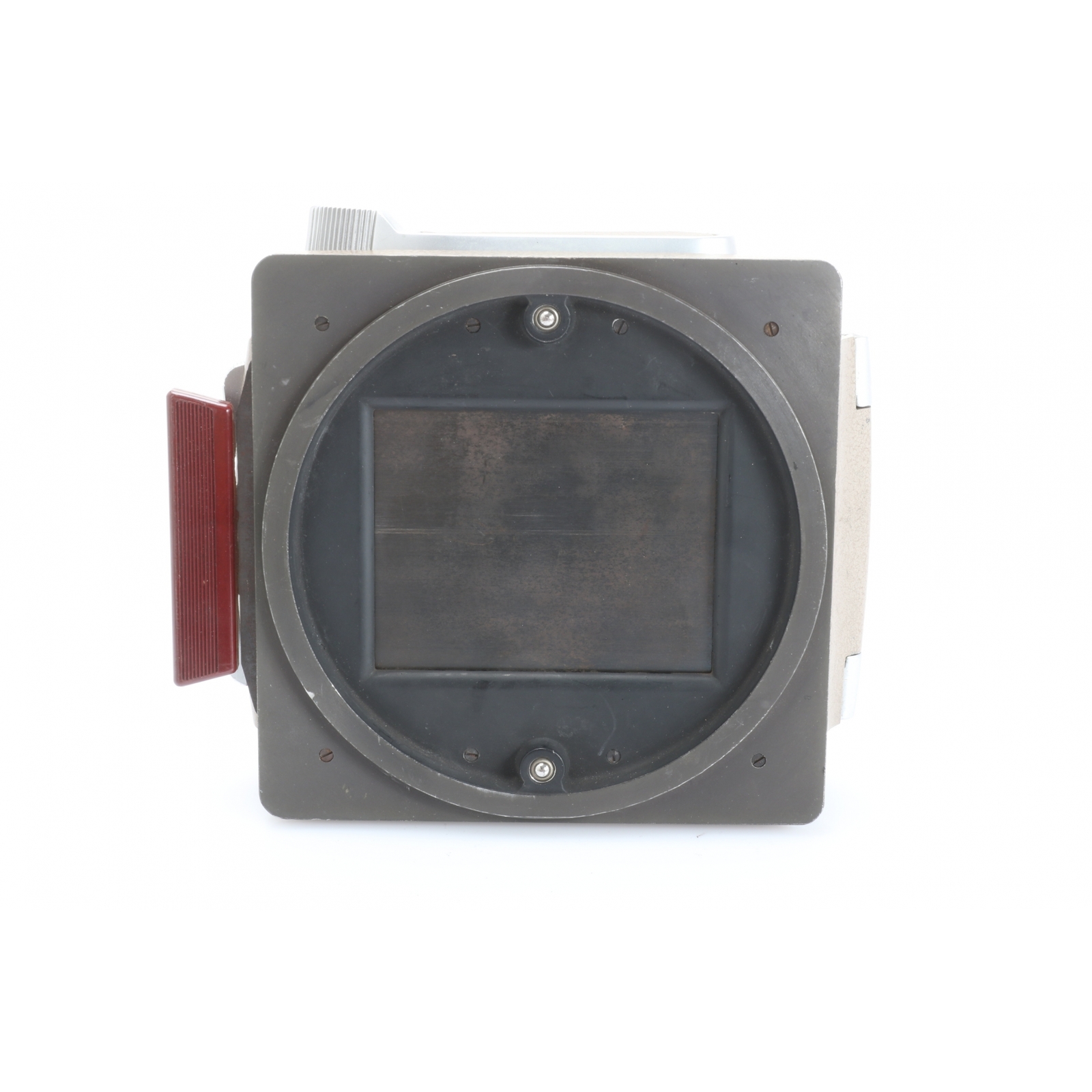

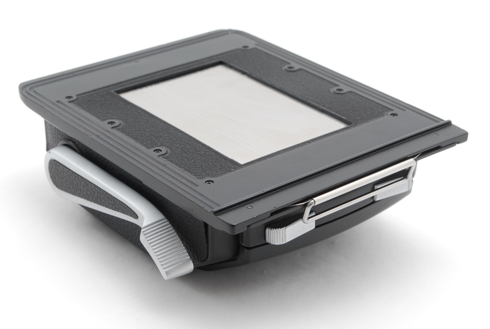

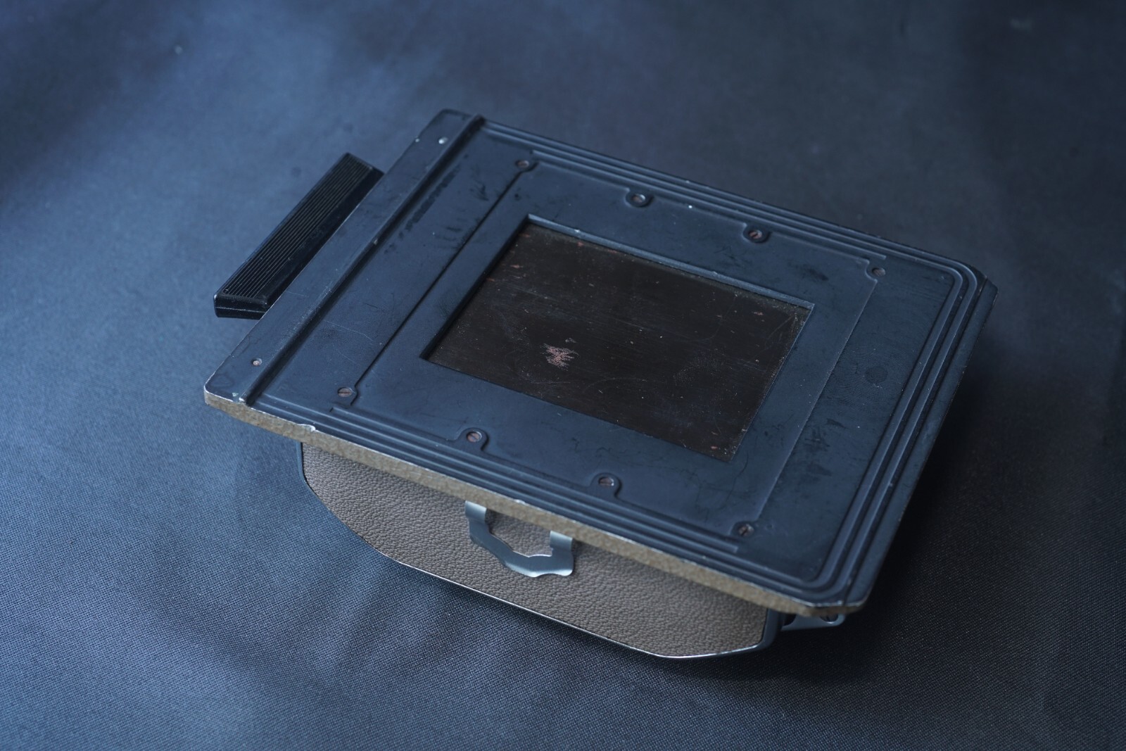

Yes, the best thing is to take a look at the back: those for the "baby" Technika 2x3 have a round interconnection to allow the revolving back to turn, like the first two below; those for the Technika 4x5 have the standard "rectangular" Graflock attachment, like the bottom two below.

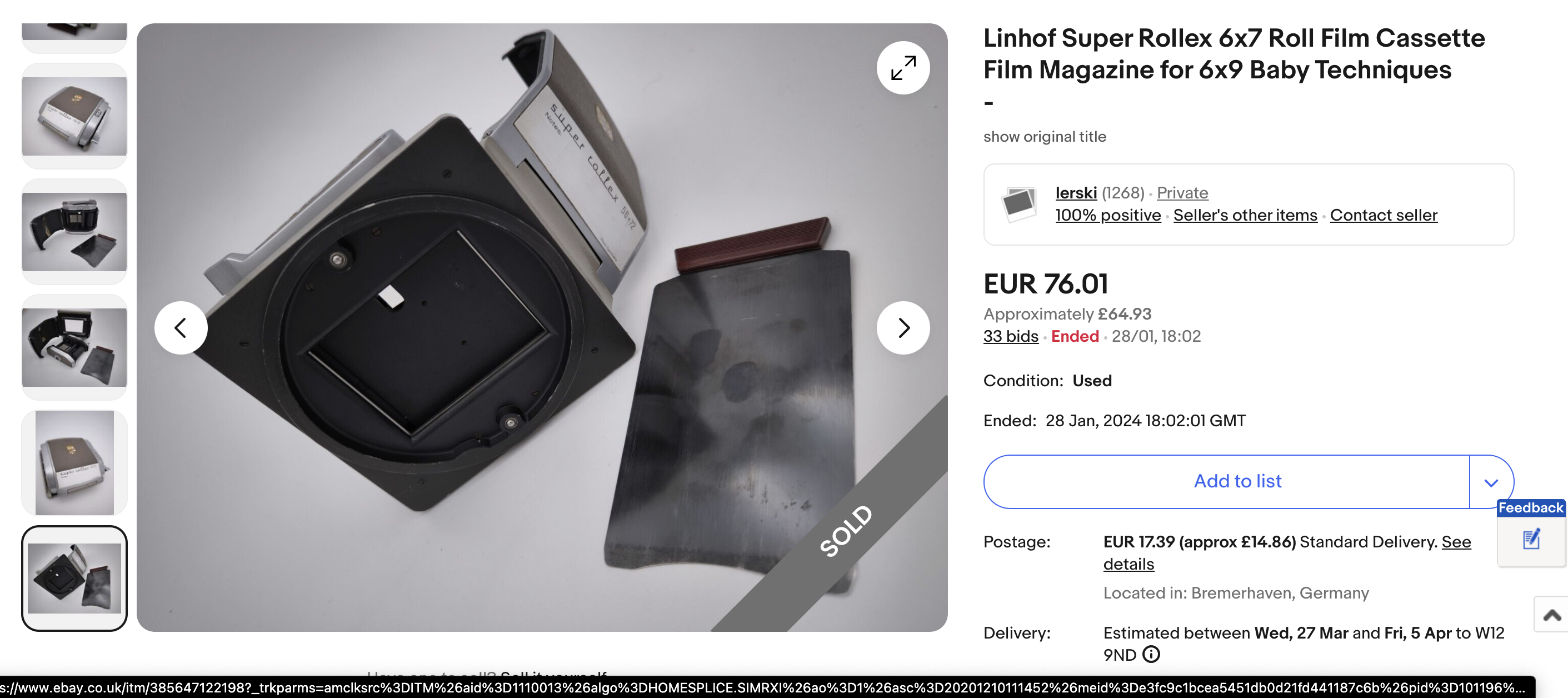

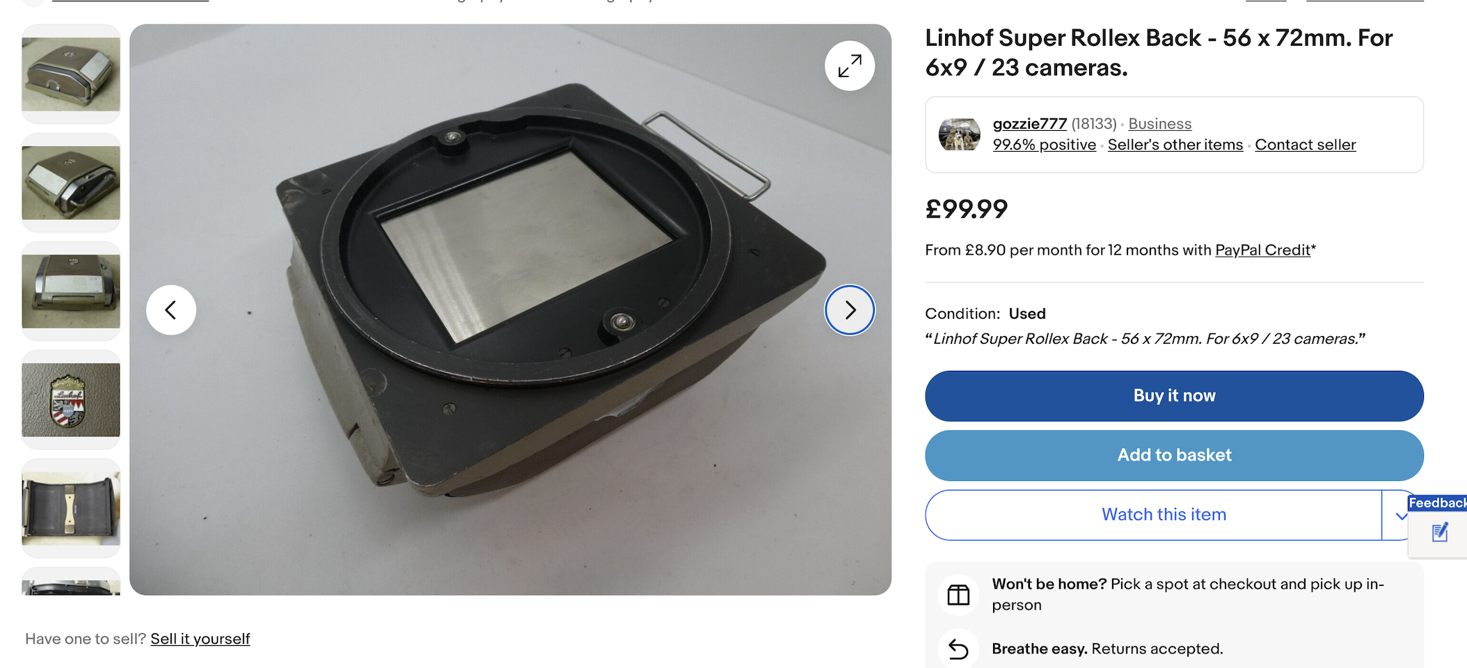

Thanks for your response - ah is it really the case that all Rollex backs with the round flange are made for the 2x3 cameras? I had heard this before but there are so many backs with the round flange advertised online as 'for 4x5' that I thought it must be wrong - see examples below

The first is a completely different thing, for 70mm, maybe it attaches directly to 4x5'' by removing the revolving back adapter - however it seems to me that there's a mistake in the ad as it claims the item to have the "international back" while in picture it's quite obvious that it features Linhof's proprietary revolving back. My educated guess is that it's the 2x3 version, but I'm not 100% sure.
The second I would qualify as a wrong ad altogether.
In both cases, I suggest that you steer clear from these sales of weird stuff that it's not what you're actually looking for and/or that appear to contain errors or contradictions.

Sorry Bayliss, I edited a bit my previous post in the meanwhile. I am now quite persuaded that the first ad is indeed for a 2x3 back: wrong description again. In any case, I suppose you're not interested in a 70mm back.
