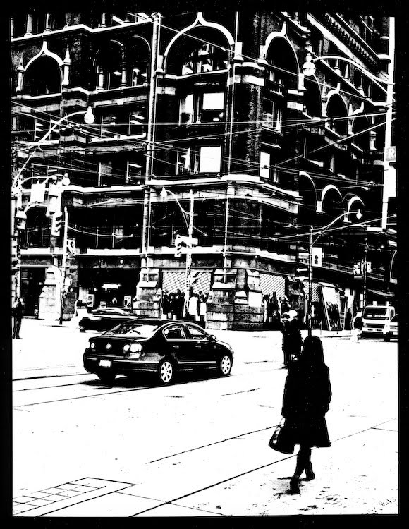

Another way, especially if you want the same end result from any old negative, is to duplicate it onto ortho/litho film and develop it in litho developers. Attached is such an example that I made from a flat negative earlier this year. The interneg I made didn't require anything other than grade 2 to print.
