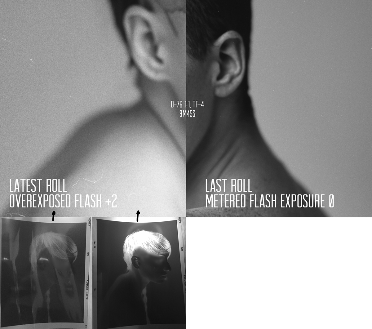

Tri-X 400 (120) overexposed 2 stops
D-76 1:1 + TF4, 20c/68f at 9m45s
I recently developed some really dense/dark negatives (I was shooting against a white backdrop about 3 feet away from the subject). I developed them normally at 9m45s (TRI-X 400 datasheet), and cant read any text through the dark parts of the negative (it blocks a ton of light when I hold it up). My negative scans are showing that they're much grainier with flatter contrast than my last shoot, where I had the light powered for proper exposure.
My strobe was powered 2 stops higher than normal and I feel I may have either overexposed it, overdeveloped it or both. Is there anything I can do in development to get cleaner negatives (e.g. less time)?

Decreasing development may help with grain, but you will most likely end up with lower contrast too.
A "fine grain" developer like perceptol would help with the grain, but you will lose both effective film speed and apparent sharpness in the negative - accutance will be decreased.
You need to adjust your lighting, and then expose the film to complement that lighting.

In the photographs that you posted, the negative on the right appears to have much darker rebates (the clear area of the film where the numbers are and between each frame). Is this just an illusion on screen or could you tell us if there is actually no real difference.
The reason that I ask is that this could indicate several potential problems.

Overexposed TriX comes out flat and grainy like you described. Over development would add to the problem. The development time you cited for D76 1:1 isn't over development in my opinion. Temp would have to have been off by more than 5 degrees F, which is not unheard of among abused darkroom thermometers. I once discovered my faucet thermometer off 5 degrees but I really didn't notice any awful results, just richer looking negatives on the light box. Also, printing overexposed triX doesn't look any better than scanning it; I have a box of that as evidence. Anyhow, besides the above advice, I once had an overexposure malfunction using TriX and fixed it using a product called Formulary Reducer III which is a negative reducer. A tricky process but if you absolutely need to save it...

Two stops over-exposed is still well within the latitude of Tri-X. Many photographs typically over-expose by a stop and develop normally for better tonality.
You can only judge granularity by looking at negatives not positive prints. In a positive what appears as grain is actually the spaces between grains in the negative. In addition judging grain is very subjective and people tend to see what they believe they should see.

It is certainly possible that your negative is properly exposed - for the foreground - while the background is over-exposed. An over-exposed background will be grainier.
The solution for that is to adjust the background lighting.

As others have said, a two-stop overexposure with Tri-X shouldn't exceed the latitude of the film, that is, if you're not already over-exposing when you think the exposure is "correct." I have great prints from overexposed Tri-X; negatives so dense that they proper-proof as almost blank white. I could be that the graininess you are seeing is a scanning artifact. As mentioned above, scanners don't do well with denser negatives. Optical printing would likely get you a much better result (hence the "damn scanner" comment above...).
If your film is so overexposed that the highlights have blocked up (i.e., all collected on the shoulder of the film with no separation, which would explain your lower contrast), then there's not a whole lot to do about it. Make the best images you can and/or reshoot. Consider it a lesson on remembering to check the lighting before exposing. You also might want to check your basic metering and exposure techniques, since, if this is indeed the case, you've overexposed 3-4 stops total, which means your "correct" exposure may be over by quite a bit. Read up on finding a personal E.I.
I doubt you are overdeveloping, even if your thermometer is a bit off. The combination of overexposure and using a (damn) scanner is likely the culprit :tongue:

I don't think so, the foreground and highlights have just as much grain as the background, which had a much weaker light on it.

Very possible that the lights were set too hot (metered at f/5.6 when I usually meter at f/2.8), but why would too much light cause overly grainy negatives? It's like the opposite of everything I thought I knew about light-to-noise.

In the photographs that you posted, the negative on the right appears to have much darker rebates (the clear area of the film where the numbers are and between each frame). Is this just an illusion on screen or could you tell us if there is actually no real difference. The reason that I ask is that this could indicate several potential problems.
Also, I have had a number of students recently who have booked to test EI and learn to develop film. Each one has solemnly told me that they only want to learn to process film and have no interest in making wet prints. Well EVERY one of these students has now gone on to learn to print and has either their own darkroom now or print in my darkroom under my guidance. So who knows, maybe one day you will also get the bug! Generally, it only takes seeing a few well made fibre prints to awaken their appetite for going beyond scanning.
Yes I think the darker rebates are an illusion, both of those negatives are exactly the same. The negative is inside its plastic archive sheet so you may notice it looks funny when I hold it up near a wall vs up to a light. About the EI testing: how exactly is it done at home and is it simple? As far as printing goes, it's not that I don't love printing it's just that I'm taking it one step at a time and still learning how to develop first. I will focus on printing next when I am more skillful and have more money to spend.

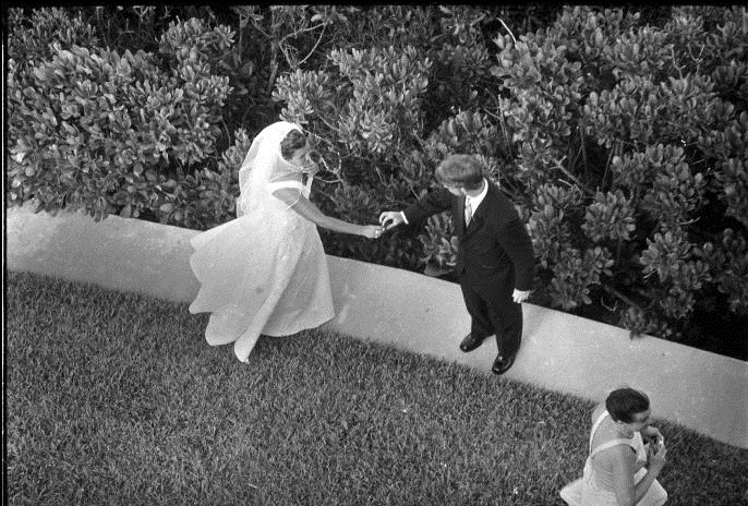

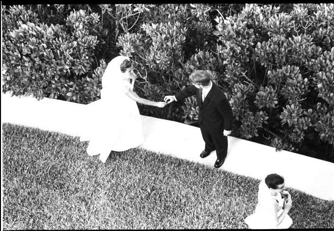

Looking at the negatives on the first post, can you judge how many stops its over-exposed? As far as the flash deal, perhaps you can imagine it as the sun but you open your lens 2 stops more than you shouldve.

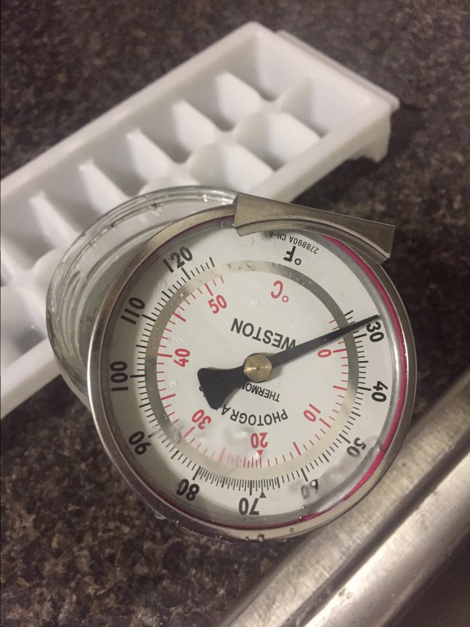

Hmm are you sure it cant read below 32F? I just put all the ice I had into a jug and filled it with cold tap water, let it sit for 5 minutes:
attachment.php
Its reading 25F right now as I edit this*
Edit 2: I threw the ice out and left just the water and it stops at 32F/0C now! Apparently ice is colder than 32F, so we have to measure the water around it - yay for high school knowledge I forgot!
