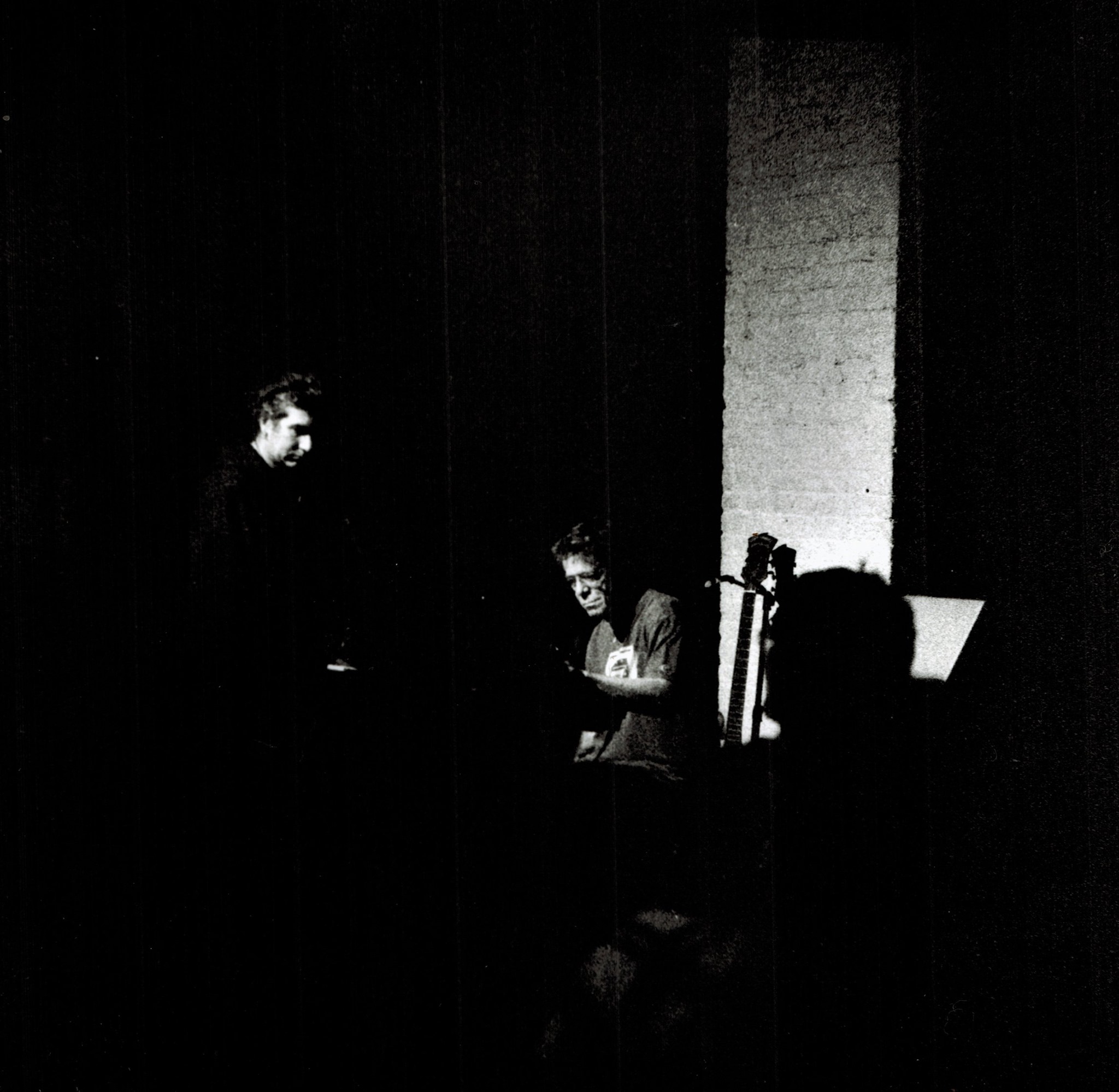

In an *average* small bar or club that I shoot, I can get EV 4 or thereabouts on a performer's face. Remember the word *average*! heh heh. I am only speaking from my experience, which is quite a lot with live music in small local venues...but every place is different. Nicely lit places are several stops brighter, and crummily lit places are several stops slower, such as EV 1 or 2, or EV nothing if it is truly dark (what I like to call "no light shooting" instead of "low light shooting"). The average of EV 4 means to make that face middle grey (a perfectly workable value for a face given that you can push that up a bit in development, and also print it up and/or intensify), you must expose 11 stops from sunny 16, which would be '1000 at f/16 with Delta 1000. Go from '1000 to '125 and you add three stops. Go from f/16 to f/3.5 and you knock off 4-1/2 more stops, for 7-1/2 total. Still 3-1/2 stops underexposed from middle grey, meaning that the face is exposed below the threshold of detail, and no amount of pushing or special printing will ever add detail there. Once something falls at a low tone, it cannot significantly be pushed, as
pushing really only works on the midtones and high tones. In my experience, you can get a decent print (albeit rather gnarly to get it) if a face has to be underexposed by two stops. Any more than that, and you have to just find a way to work with it as a block of dark tone in the print, perhaps with a touch of texture there if you are between 2 and 3 stops under.
If you really want to get slick, you can take your brother back to the bar, put him in the same lighting situations, and take some meter readings off of his face with your meter set at EI 1000. Compare the exposures it gives you to the one you actually used the night of the jam session, and you know how underexposed he was in each position onstage.
