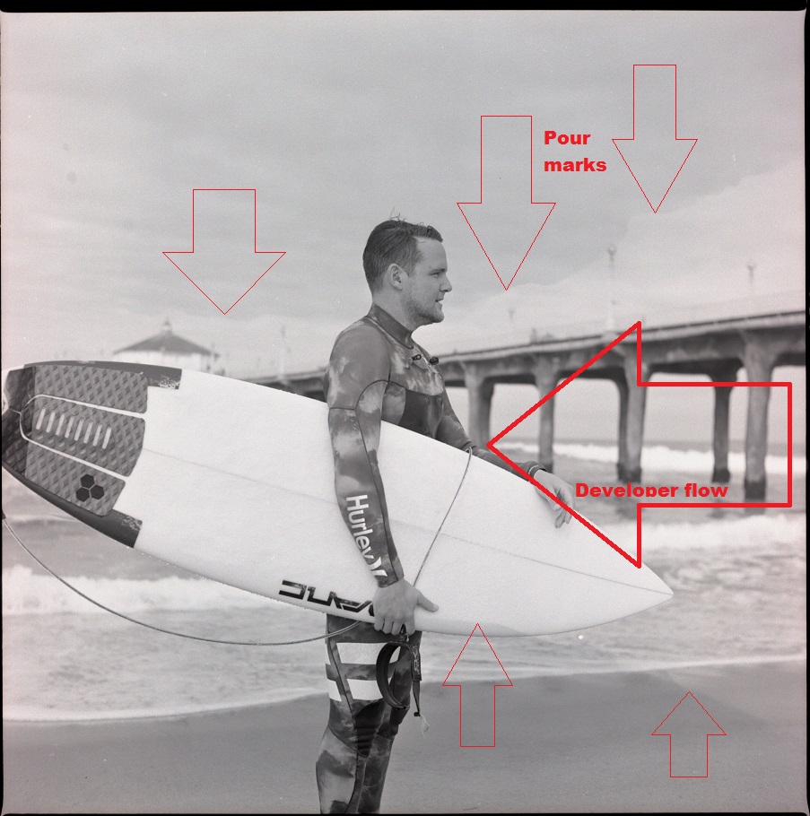

Anyways, the other issue is how the heck do I fill up the chemicals fast enough?
You don't! I can't believe no one has addressed pouring times. At just over three minutes, C-41 development takes place fast! You can check to see how much time it will take to get the top reel completely submerged in whatever size tank you end up using, but anything more than about eight seconds is too long. Forget the funnel. For large loads, better to drop and lift the reels into and out of the developer and into your next bath. This can be cumbersome with Paterson tanks since the center column isn't really designed to work like a lifting rod. If you go that route, best to have your next bath ready to go in a separate vessel that can receive the reels.
Here is what uneven development from slow pouring looks like. And this was a two reel tank with just two 120 reels (this was on top, of course). Not pretty. And, yes, I used a pre-wash -- two of them in tempered water.
ETA: My example was with a stainless steel tank and reels. I know the Paterson tank is designed to fill up evenly from bottom to top, but I still wouldn't trust it to keep developer away from dry film before the fill line reaches it. The other issue with excessively long fill times is the top reels will get less development time than the bottom reels -- again, more of an issue with C-41 since the development time is so short.
Very weird, I never had this problem with my 2 120 reel tanks. I pour directly from a large 1L measuring beaker into the tank and it takes 5 seconds or so. Then at 3:25 I start pouring out so the roll at the top that received 5 seconds less development at the beginning gets the last 5 seconds to make up for it.
