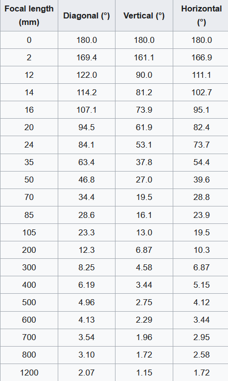

Given the focal length of the lens and the coverage, the angles needed to design your lens hood should be known. They can basically follow the diagonal angle of view of that lens (a value that can be calculated - or looked up on this handy table from Wikipedia:smile:
That could be close enough. Beware that some lenses are not precisely their stated focal length, and some lenses distort.

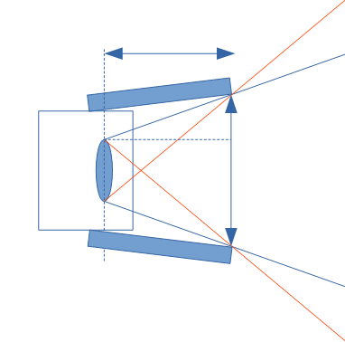

Here's a sketch:
The clear rectangle is the lens barrel, the blue ellipse is the entrance pupil, the blue rectangles represent the lens hood (its opening and length shown with the arrows) and the blue lines represent the FOV. The red lines represent the stray light cone that still gets into the entrance pupil despite the lens hood. The lens hood has to follow the FOV lines to avoid vignetting and to minimise the stray light.
First you need to locate the pupil. Prop the lens horizontally then use a digital camera on a tripod + nodal slide to focus on the front of the lens barrel. Stop down the lens then move the nodal slide until the aperture is in focus. The distance moved is the distance of the pupil with respect to the front of the barrel (or whatever reference point you used).
The FOV a for each side of the image is tan(a/2) = s/2/f where f is the focal length and s is the image side (e.g. 24, 36, 56mm etc...). Using similar triangles plus the size of the entrance pupil (f/f-no) you can determine the size of a lens hood of a chosen length (w.r.t to the pupil) and for each side of the image. You can see how a hood made for the full pupil will have to be shorter than necessary when the aperture is stopped down. Or how a round hood made using the image diagonal will be less effective.
For extra nerd points, round the corners of your custom hood with the same radius as the pupil.
