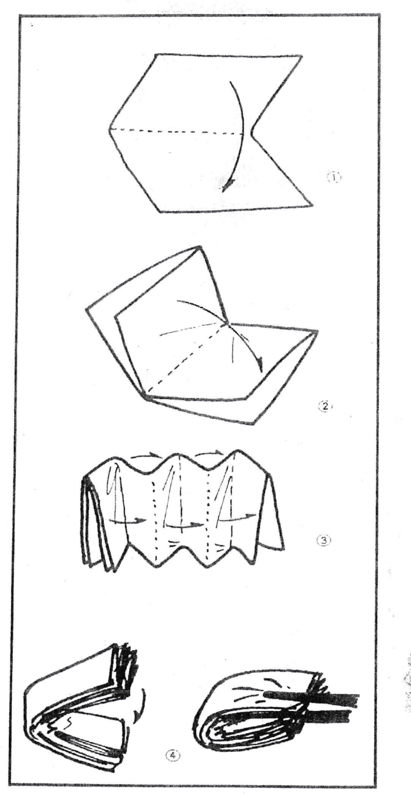

kimwipes has a special tissue for cleaning lens. Better to use a tweezers to hold the tissue than yr hand

For yr ref:

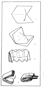

For yr ref

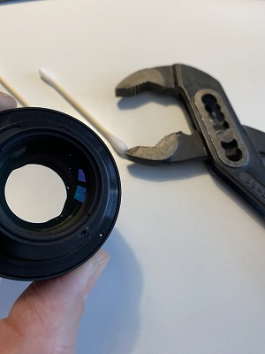

If anyone is interested how to open a EL-Nikkor lens. You just need some special tools:
It was impossible for me to screw the rear part off by hand. So I used my pipe pliers and a piece of an old bicycle inner tube to avoid scratches.
