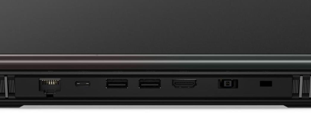

I checked out Lenovo's website and the Y540 model I saw doesn't have a Thunderbolt port or one of the legacy notebook computer ports (PCMCIA / ExpressCard). If your computer is similarly configured, you're probably out of luck trying to rig an external device that could support a Firewire card (and device).
