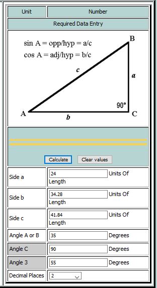

Angle of view at f/16 for that lens is 70 degrees. A little trigonometry and paper and pencil will get you pretty close. You can look up solving for sides of a right triangle to understand the process but it ends up being just over 34". That is, of course, if I'm thinking straight today.

Here's the solution that I came up with - the 70* angle of view comes from Schneider's website. Edit -and I suppose this would be to the lens and not to the film. Who knows what I'm calculating now....

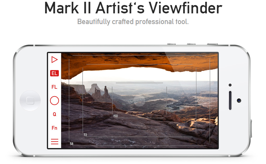

I know you were looking for help finding the answers based on first principles and you got a lot of good responses.
These days there are a lot of apps kicking around and I just wanted to recommend one that I use a lot and seems to get me pretty close. It's the Mark II Artists Viewfinder and lets me set up my film size (4x5) and my various lenses. The downside is that it's expensive at $25 but it saves me a lot of time and also let's me get a quick snapshot of the scene for a record.
