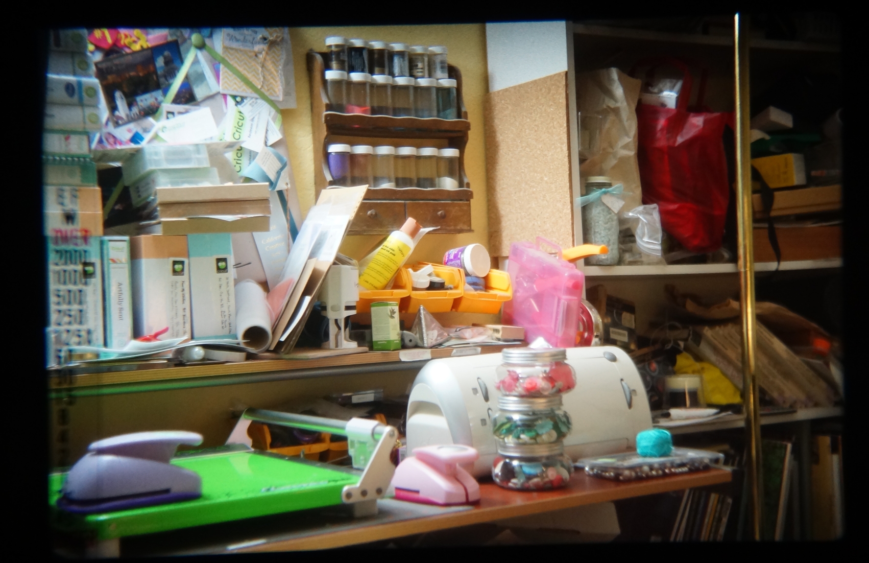

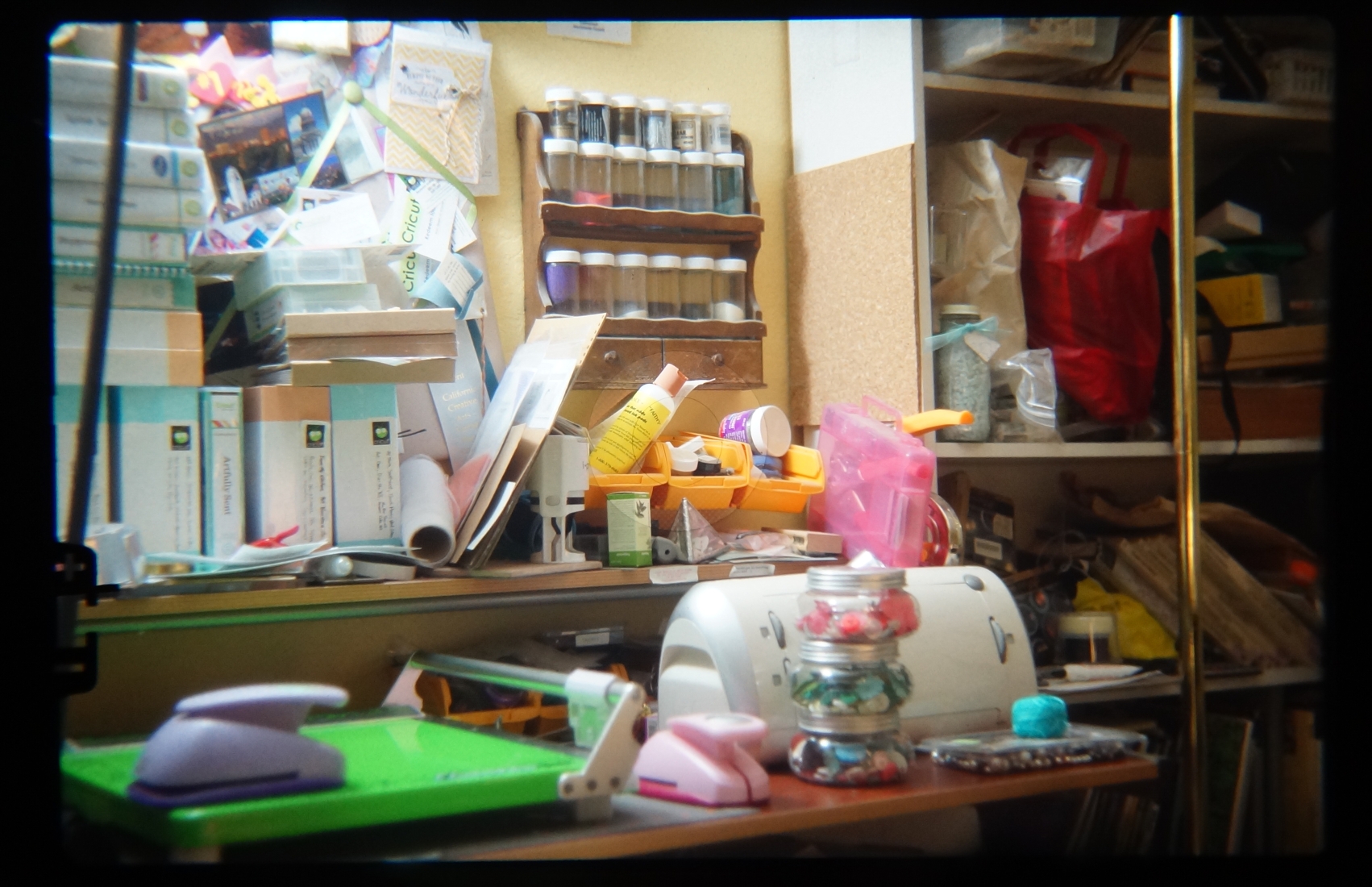

examples
This may clear things up, or more likely add to the confusion.
Here are two images I took with my NEX through the viewfinders of these two cameras. It was very hard to get good clear examples. I set the camera on manual and used the same settings on both.
these clearly show the Olympus with the 'brighter' screen (using the 1-13 screen).
Note, however that the ME Super seems to my eyes (not the pictures) to be a bit clearer or perhaps a tiny bit more contrasty.
-On the other hand, the olympus is easier to see the screen from slightly off angles, whereas the pentax I have to look straight into the viewfinder or the edges will darken. (maybe this is why the image of the pentax appeared dark)
*So I would give these two cameras a tie. But for better screens, there are may other cameras to choose from.

lxdude
Apr 8, 2009
7,094
Redlands, So
Thanks for those pictures. They convey pretty well the impression I get from each.

Oh the Pentax had a SMC-M 50mm f1.4 lens, and the Olympus had a 50mm f1.4 MC in the 800,000 range.
I dont know when exactly Olympus switched away from thorium glass, but many of the chrome-nose 50's use it.
