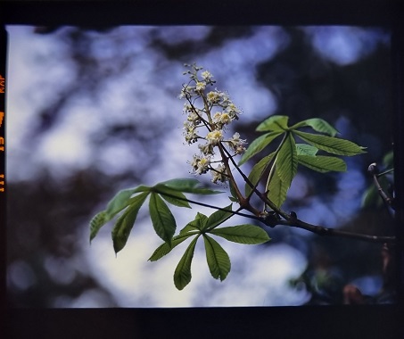

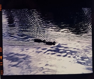

I just developed a roll of Provia 400x, expired in 10/2014. I bought it sometime ago from the auction site and since then it was in the refrigerator. Since it was one of the oldest i have, i decided to use it as a test roll for a Pentax 645 i got recently.
I exposed it at EI 400 and developed it in chemistry mixed form a newly opened Tetenal E6 3-bath kit. The batch was the third and final one and the chemistry was mixed almost one week ago.
Below are some quick "phone scans" of two frames shot in aperture priority with the speed that the camera selected and no compensation from my side.
It came out fine. The actual slides look better on the light table.

Thanks Dmknkl.
Looks like you had luck.
Based on your results. Would you have exposed it differently? More or less?
dmtnkl
Jun 11, 2017
194
earth
I have shot more Provia 400x that expired between 2013-2015. This was just the most recent example.
I always expose it at EI 400 and it comes out fine.
