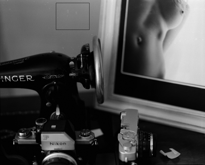

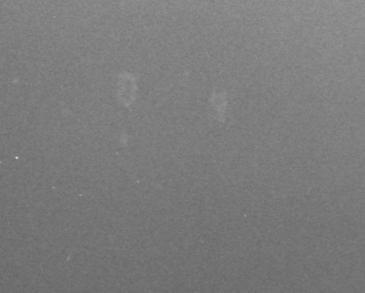

Hi everybody,
Since my moving from a place to another, my developments have issues, like the marks you can see on the neg joined here.
These marks appear after drying , but they are in the emulsion.
I am clearly fed up with it! It occurs with all the developers I use, but only on my Fortepan 400!

Is it the same emulsion batch Fortepan 400 as the Fortepan 400 you used before?

Hello everybody, and thank you.
First my question is to avoid this marks at development, not to make digital negative. Thanks anyway for the idea.
Second, to Neal, I don't know. I keep my film frozen, yes. But I use to put them out of fridge one week before use.
Emulsion is constallated of black dots... It seems to be an emulsion defect, but I don't know.
