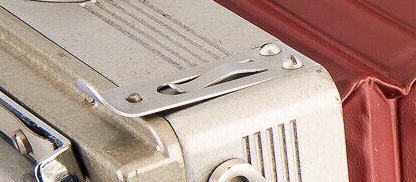

I just got an sc2 and I can’t figure out how to attach the dark cloth.
My calumet c40x has nice clips that are very convenient.
This new camera doesn’t seem to have anything like that.
I’ve just been draping it over the rear standard but it seems like there has to be a better way that I haven’t thought of yet.
First time at all I read that a camera got means to fasten a darkcloth.

I’ve never seen attachment clips either.
I have seen that some Plaubel cameras have a metal wire frame to hold up the dark cloth so it doesn’t fall down and obscure the ground glass. I thought that was a cool idea. Another cool one is the Sinar bag bellows can have a loupe installed, then attached to the rear standard so you can operate it without a dark cloth.

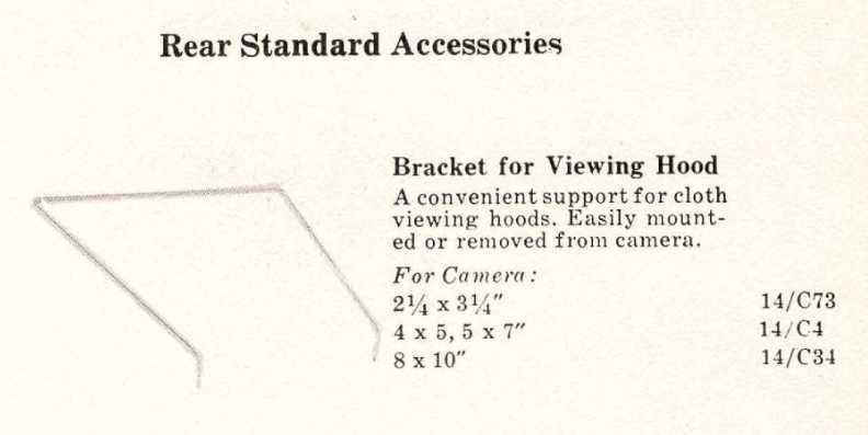

I was wondering about those holes. You wouldn’t happen to be able to explain how they function would you?
I wish I could find a manual for the sc but it seems to be lost to time.
AgX
Apr 5, 2007
29,973
Germany
I haved not yet seen these holes, but there must be two holes at the top of the rear standard. Combo offered a darkcloth "holder" which just is a plain, U-shaped steel wire frame, seemingly to be mounted 45° upwards by means of the 45° downwards bent ends of that frame.

The frame plugs in vertically and gravity keeps it there. I thought I posted a picture.
I used to use a 3x3 foot piece of B&J Darkroom Cloth which was rubberized on one side and lightproof, long gone from the market. Now I have a genuine Calumet that is fading year by year.
$65 for a real one, the topside can be a reflector. https://www.bhphotovideo.com/c/product/446774-REG/Harrison_2035_Silver_Classic_Dark_Cloth.html
There are two holes on top of each standard. I suspect something very similar to what you describe as what might go there. I have yet to see anything purposeful for those holes.
Look at the photo in post #14. There you see that U-shaped wire frame I described.
