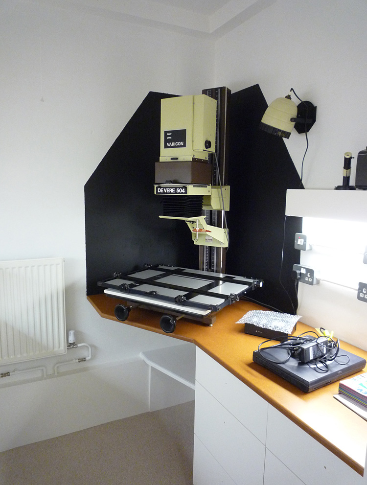

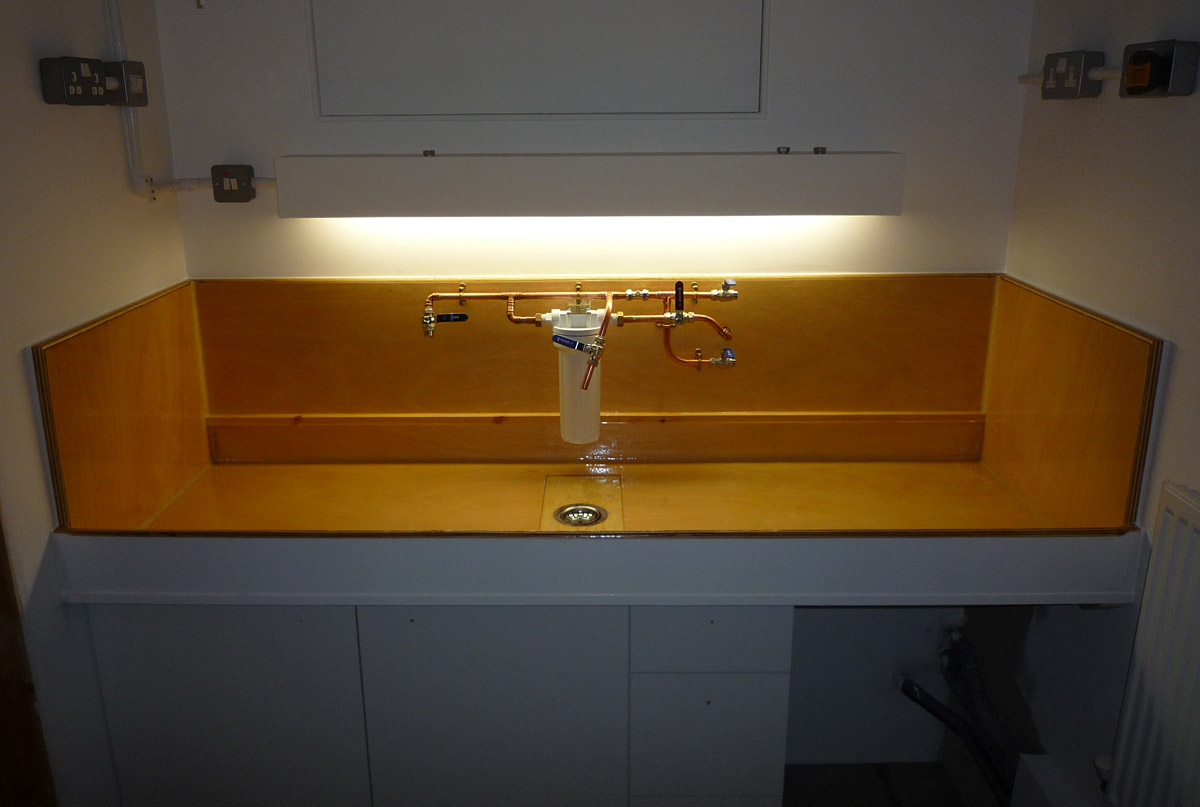

Thanks Martin. I've just completed the darkroom with an epoxy coated ply sink. Enlarger went in yesterday and hence why I want to attack this paper.
Being my first darkroom there will no doubt be more silly questions and mistakes, but hopefully some worthy images along the way.

Oh that's a neat and tidy arrangement. In the Equipment > Darkroom sub-forum there is a thread for pictures of darkrooms, these photos would go well in there. And congratulations on the De Vere, great machines.
