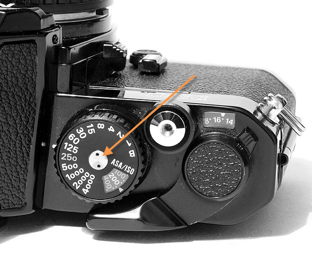

Hello Friend,
I have Nikon FM2n and I fell the shutter speed dial is to loose.
I wanto to adjust the firmness speed dial analog cameras
Do you have a ny experience for adjusting this dial?
Please let me know, thanks
- the picture in attachment, explain what I mean.

Probably just need to tighten the chrome screw (the one your red arrow is pointing at) that holds it on.

You'll need a spanner wrench to handle the task. They're available on line, and you can probably find a decent set on eBay. Be sure to get one with interchangeable tips, because the spanner wrench is very versatile. They work on lens retaining rings on view camera lenses, and sometimes, even on watch backs when you need to change batteries.
Alternatively, you can grind part of the tip off a flat blade screw driver, and taper the points to fit the two holes.
