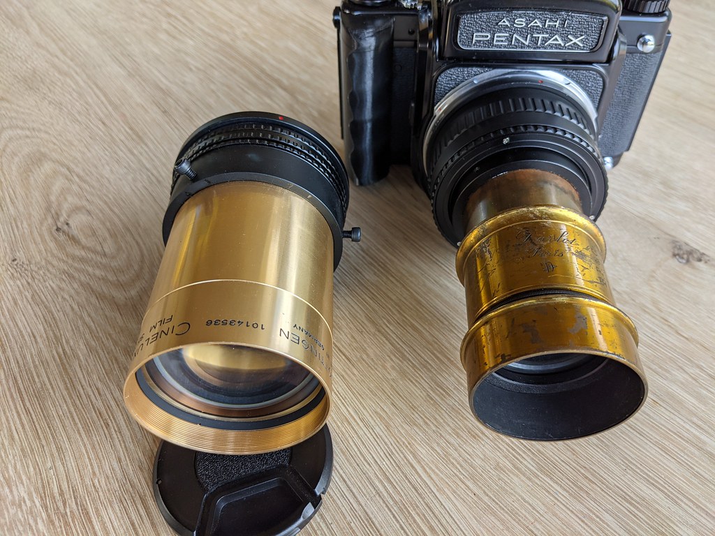

Since absolute image sharpness is not the main objective in using projection lenses on P67, you can also experiment with low-tech and temporary solutions such as gaffe tape, plastic/cardboard tube, sheet metal, etc. You can figure out what works for both infinity and close range, and play with it until you find a more permanent and elegant solution. Elegant and permanent solution might need some custom machined parts, or at the very least, 3D printed adapters.

Epoxy worked just fine :smile: Focuses from infinity down to 1,4 meters.

The mount and the 82-77 stepdown ring. Which then screws on the 77mm helicoide. And a buddy of mine 3dprintet 77mm to 70.5 mm holder for the lens.
