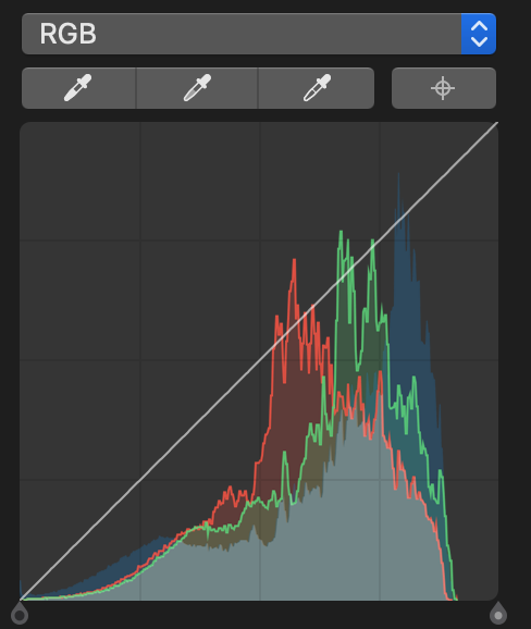

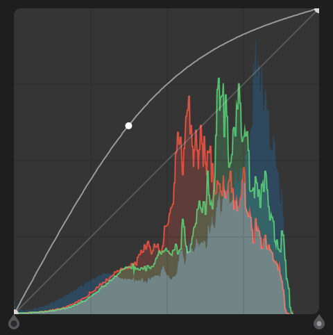

Is it possible to achieve a "midtone" bumping on B&W film & paper?
I mean this kind of transformation:
.. to => ..
I don't know what you are showing. What are the axes. If this is a print, then burning multigrade paper with blue light (number 5 in the diagram) will darken the shadows like that.
Ahm, sorry. Those are normal levels-dialog values: X is original tone and Y is intensity.
I guess contrast is S-curve as what I'm after is just a single point "bow" ?

I'm looking for boosted mid tones while maintaining black black and white white.

I refine more: how to make print with bumped midtones (see example from picture at first post) from B&W negative?
So, if that is a transparency, when you write "bump" you want it brighter, or less density. In that case you will probably need two masks to control that. More info here:
In the analog world, there are a couple of ways to manipulate the curve shape of the final print relative to the original scene in the way that you desire (that is, if I'm understanding your explanation correctly).
The first is direct manipulation of the curve on the negative by using (a) a film with a pronounced shoulder and/or (b) compensating development or (c) SLIMT techniques to achieve a steeper contrast curve (C.I. or contrast index) in the mid-tone area of the negative.
Then, when printing (analog) one can choose a paper with a long toe and/or use flashing or split-printing techniques (e.g., printing contrasty and then burning highlights with a low-contrast filter, etc.) to achieve more mid-tone contrast.
Masking is another (more advanced) technique to manipulate the contrast curve in the final print.

Printing at a hard grade (for the steep part of the curve) and flashing the paper (to round off the shoulder) might do it?
I didn't mention this specifically, preferring the technique of burning highlights at a lower contrast setting, but yes, indeed, this works well too!

It does indeed lower the contrast of the highlights. The idea is to print at a contrast setting/grade that is "too contrasty" for the negative and then use flashing (or burning at a lower contrast setting) to get some detail in the highlights, albeit at a lower contrast gradient than the midtones. The result is contrastier middle values and less-contrasty highlights. Exactly the effect you seem to be after.

SLIMT for negatives (not prints) and compensating development techniques both have a similar result, albeit using different mechanisms: to reduce contrast in the highlight portion of the negative. This changes the characteristic contrast curve of the negative to one similar to the one in your "midtone bump" histogram above; i.e., steeper in the middle and then tapering off with the highlights. FWIW, I use SLIMT techniques for extreme contractions since effective film-speed loss is less than with reduced development and the midtones retain much of their "normal" contrast.

Is it not just a case of printing shadows and mids at one contrast and highlights at a softer contrast.
I think you are saying here "print with higher contrast" which is same as S-curve. Or how do you limit certain contrast to shadows/mid tones only?

If you turn the contrast up and/or develop longer you can separate and burn in the highlights separately on a softer grade. It might need some good skills though to burn in complicated highlights.

I think ic-racer hit the nail on the head in post #8. Basically, masks are made to manipulate analog tone curves. You can find some example of what contrast masks can do here: https://www.maskingkits.com/maskingexamples.htm
It's not as easy as pulling a tone curve up with a mouse click, but it can be fun and, from what I've heard, it becomes easier the more you do it. I have the Radeka masking kit and have done it, but I don't shoot enough large or medium format film to become adept at it. It's not something that works very well with small negatives because of the precision required.
