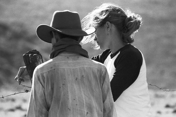

Here's a 35mm tri-x neg rated @400 dev'd in rodinal 1+25. lot's of grain even in a 5x7 It's too much for me but you may dig it.
vinny
