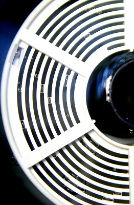

Here's what you get
No amount of tapping removed them completely, this was after sharp taps !!!

Unlike the rest of you I've done some practical experiments with a tank, reels etc, taking the lid off to see what happened, in fact a few times - first with plain water and no film and once I thought I'd solved the problem then again with some old film & dev.
Having had a Paterson tank with 7 rolls of film split when giving it a tap I don't advocate sharp taps
Here's a few things I found last year:
1. No amount of tapping removed air bubbles totally, although in some cases it ma be enough for then not show.
2. Nor did inversion agitation.
3. If you have the Paterson twist stick to agitate by turning the spirals that helps.
4. Two drops of Wetting agent entirely solved the problem, with the surface tension broken air bubbles disappeared completely and didn't reform.
Then some comments.
5. Developers and films vary some developer/film combinations may be more prone to air bubbles than others.
6. Water supplies are very variable, this will make a significant difference..
7. The main conclusions are that some developers may contain too little sequestering agents for certain water supplies, and in most cases when you mix up yourself from scratch won't necessarily contain any sequestering agent.
In my case using Pyrocat HD there's no sequestering agent but wetting agent has proved sufficient even with the very high salt/calcium levels of my local water supply. In the 16 months since changing my way of working I've had no air bubble marks on negative.
My suggestion to anyone having persistent problems is do some visual tests with your tank and some dry spirals, you'll find it can be hard enough to dislodge the air bubbles with no film loaded, it's even worse with a film in the spiral.
If you do this you should find what will works best for you.
