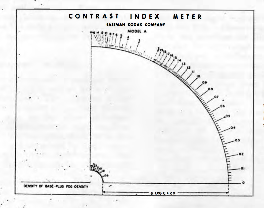

How specifically do I need to measure CI for alternative processes?
Traditionally Contrast Index is measured with a transparent overlay.
What I do, is take the first 10 or 11 points after 0.1 and do a linear regression. I started doing this on my Atari computer in the early 1980s and still use that same method in a spreadsheet.
