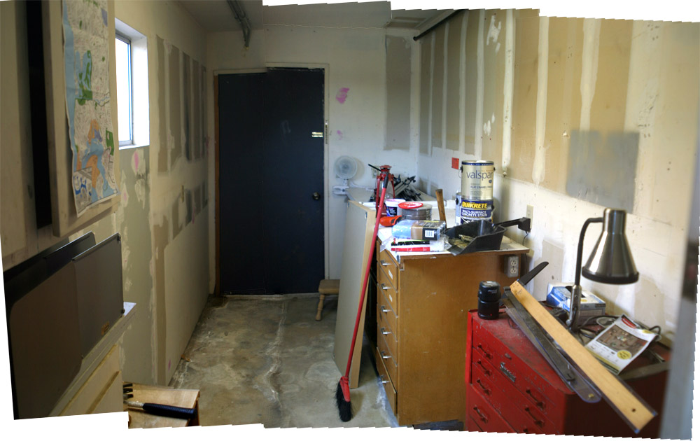

So, Im fortunate enough to be living at home and going to school right now, and even more fortunate that my mom is letting me convert the tool room in the house into my darkroom, im undergoing the conversion process on my own right now, and this is what i have so far.
The room i will have is about 5x8 (I have to put up a wall to devide the room and that workbench will stay there.

Some suggestions:
1. Block off the window, but do it in a way that is removable. In fact, it would not be a bad idea to have the window available as an emergency egress in the event of fire. A sheet of plywood held in place with wooden cleats would be adequate although not pretty.
2. Think long and hard about what you plan to do in the darkroom. 5x8' is about right for a decent darkroom, but you will probably be limited in the size prints that you can make. You mentioned 16x20 and 20x24 - - - maybe not.
3. Buy your trays, and then lay out four (developer, stop, fix, and rinse) on the floor, and measure how much space that requires. Add 6" to find the minimum inside dimensions of the wet side sink.
4. Visit as many darkrooms as you can to get ideas before you start construction.
5. Don't forget ventilation.

5x8 isn't huge by any means, but workable. I'd consider having the enlarger on the end of the room and the sink then running the long way. That should give you 6 feet-ish of sink and a workable dry area. Definitely lay it out. In fact, I'd lay it out on the floor with chalk or cut out paper including outlet locations and plumbing locations. Then, put the trays, enlarger, etc in place and make sure you are considering everything. Life-size is better than graph paper any day. Since you won't be there forever, you might also consider how the sink can be moved at some point too.

The logical thing, given that you have two 4' sinks is to arrange them down the side with a bench at the end to hold the enlarger etc. Only snag there is that the bench will only be three feet wide unless you extend it over a sink to take in the whole five feet width of the room. Another option is to sell the sinks and get a single six feet one which will be just the right size to allow a full-width dry bench at the end.
There is not really enough width to allow a dry-side bench to run parallel with the sinks: a 2' wide bench + 2' wide sinks would only leave you 1' to move around in. You could try an 18" dry bench but then the enlarger base will stick out so it would probably need to go at the very end and it would still be a tight squeeze. Last thing you need is to feel claustrophobic in a place where you are supposed to be relaxed and creative!
If you are going to use the Jobo to make prints, rather than using trays/dishes, then you may be able to get away with just one of your 4' sinks to hold the Jobo, but you will still want room for one or two trays for toning etc as you would not do that inside the Jobo.
As others suggested, lay it out first. See if you can live with a three feet wide area for the enlarger or you need the whole five. Five feet is a very reasonable width for the enlarger and all the bits you need around you when enlarging. Three feet will do - many communal darkrooms have the enlargers in bays of that size or smaller - but try it and see.
Ideally you want air extraction close to the sinks and to pull the fumes away from you. This may be tricky if the sinks are not on the wall with the window - unless there is another location out of sight in your picture - so you may have to knock through the wall. I'd also recommend acting on Jim Jones' comments re' cabinets and electricals. Budget-priced white kitchen units make good darkroom cabinets. Figure out how many sockets you think you need - then double it...
Put something soft on the floor such as industrial rubber matting or wood planking etc with insulation under it and install heating/aircon depending on your local climate. Make it comfortable and practical to work in and you will reap the benefits.

this just in, i actually measured the room, and it is actually 6'2" wide, you think 26 inches will be enough work space?
