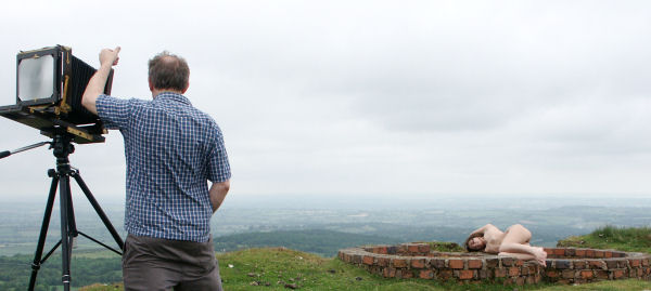

Not familiar with that analogy....:D
Here's my 10x8, you see Jason it loved it :smile:
No wiggle . . . . . . . .. . . . . . . . . . . . . . .. . . .
That's how a camera should live, and the model also works with Kim Weston :D
