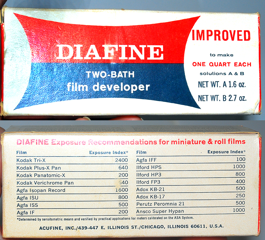

I got a couple of these packages of Diafine at an estate sale, both unopened.
Going by the films listed on the box, how old would say this is? I know Ilford HPS goes back to the 1950s-60s but I'm not sure about some of the others. The box has a zip code address so that would place it around mid-1960s or later.
Do you think it's still good? The metal cans inside are unopened.

There is a zip code so not the 50s, no earlier than 63, just before GAF bought Ansco so between 1963 and 1966. Other date is HP3, when did it become HP4? I think current Diafine list Trix as 1600, the older emulsions were thicker allowing more of part A to soak in.

Sometime from the early/mid 60s
Agfa IFF, Ilford HP3/HPS, Ansco SuperHypan are from that time.

Although the films listed on the box clearly date it to be 1960s vintage, my memory of buying a box of Diafine new in the 1990s was that the package still looked nearly the same - white box with that red and blue logo and two small metal cans inside. I'm sure the list of films had been updated. Acufine was similarly packaged in a small metal can.
