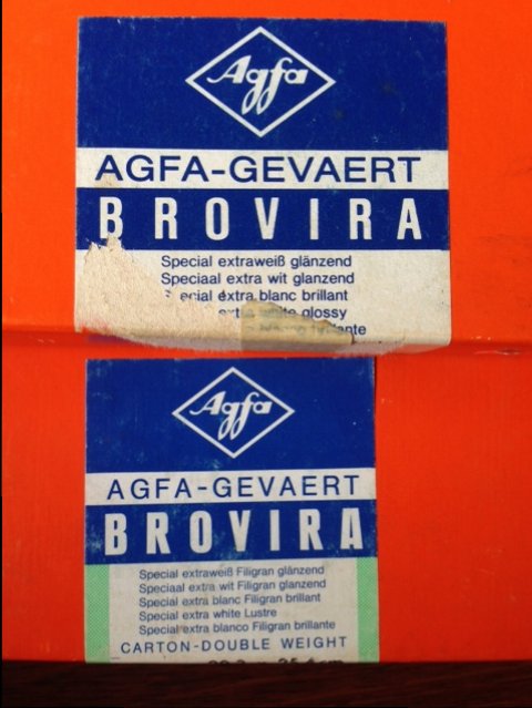

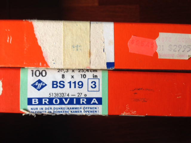

Can anybody please recognize how old is this Agfa Brovira paper.
Price was 29.95$, then reduced to 25.45$ from Toronto Camera store
It's still good paper, I just tested it. Unbelivable!

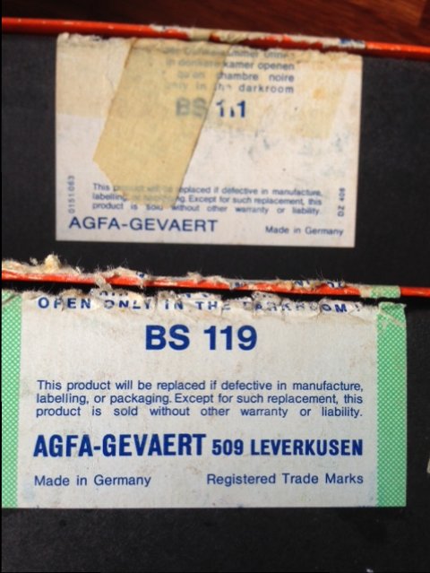

The Brovira brand is indeed quite old, but my guess is that this particular paper is from the mid/late 60s at the earliest or early/mid 70s at the latest. The printing on the boxes gives us some clues: First, "Agfa-Gevaert" as a company (as opposed to the older "Agfa" only) came into being only in 1964. Second, the boxes still show a three-digit postal code ("509 Leverkusen", omitting the final "0"); from the mid 1970s on it was the rule to use all four digits of the postal code, irrespective of whether the final digits were zeros or not.

Very good detective work mnemosyne!! Impresive! Also, very good idea to buy only unopened boxes!
Yesterday on Ebay I saw Brovira only in small sizes and lots of Brovira Speed with crazy prices!
My guess was that this paper is from '70. When I moved to Vancouver in '94, average price for the box of 100/8x10"FB paper was around 50-60$. Now is over $110. So judging by doubling the prices, it's '70. Not very scientific method but .....
This Brovira glossy paper, air dried, has surface with almost eggshell shine. New glossy paper are way more shiny.
Momus-Why you did not try that paper? it's simple and fast test??
Revdoc-Older Ilfobrom keeps better from my experience! I have a few boxes, bought fresh in early '90 that went bad and older box still with "Ilford star" symbol that is still OK.
Thank you all!
