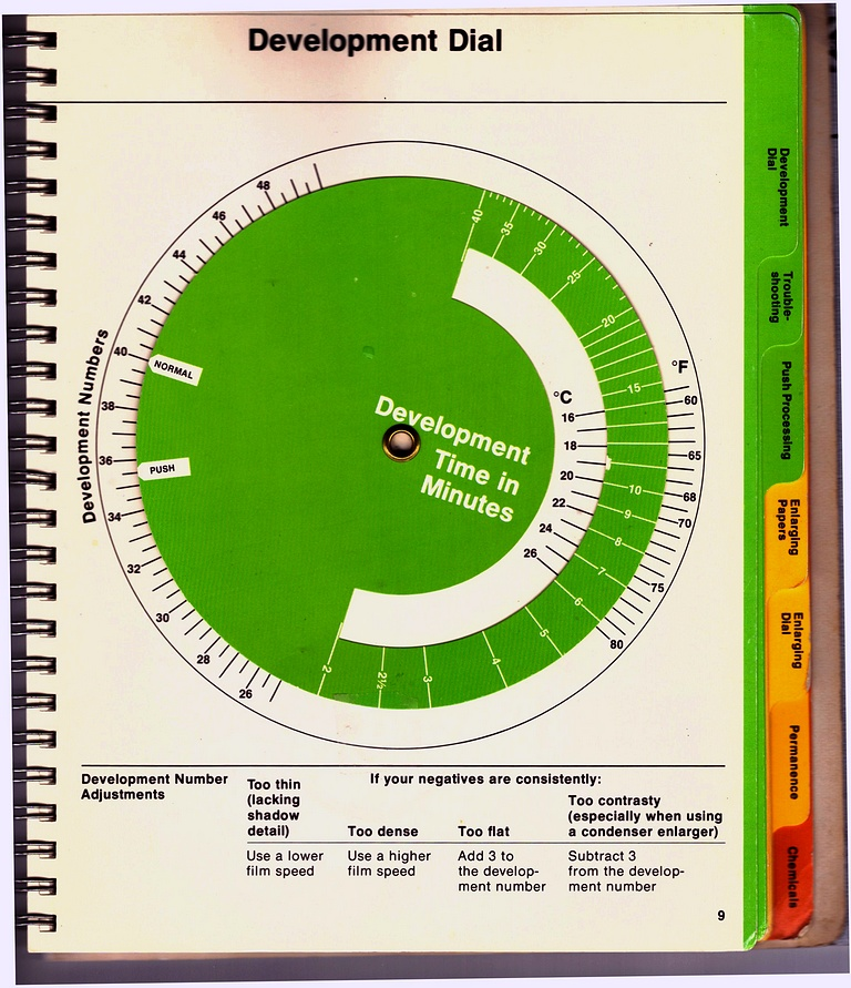

I use the reading on my thermometer, and interpolate the indication on the Kodak Darkroom Dataguide Development meter to the nearest 1/4 minute.

Going slightly off-topic, do you use that little computer? I don't know how old your Darkroom Dataguide is, but the one I have is from 1965 and just about none of the films available nowadays is on the chart that assigns the "Development Number".
MattKing
Apr 24, 2005
53,182
Delta, BC Canada
I certainly do.
Just use current information to reverse engineer your development number, and you are off to the races.
All of my copies are annotated with updated Development Number information. I also record the Development number I used with the film exposure and developer information on my negative sheets.

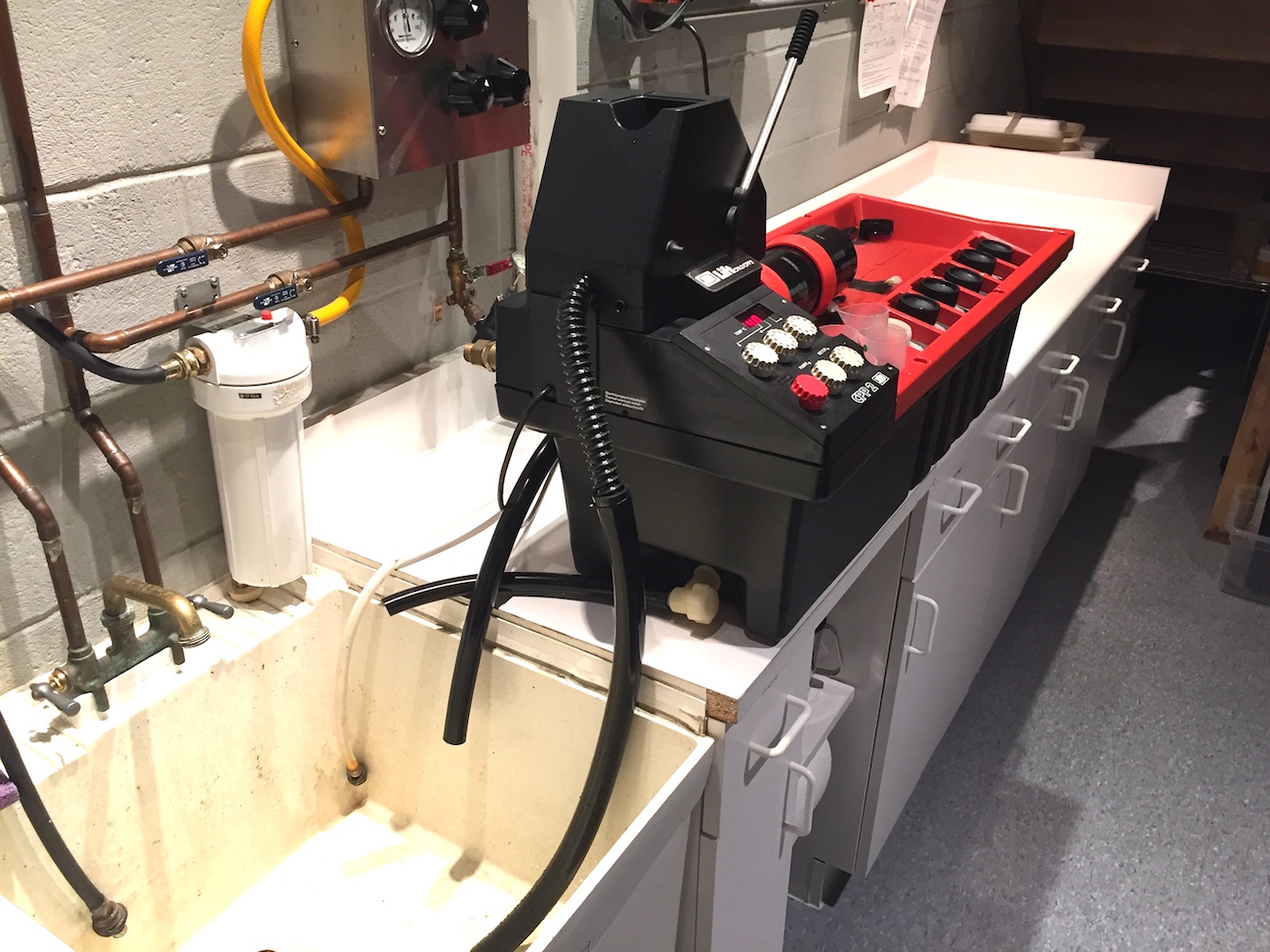

The Jobo controls the processing temp closer than it needs to be for conventional B&W work.
Prior to that I had decoded the Temp-Time formula from the Kodak Darkroom Dataguide wheel and ran the program on my 1984 Atari computer using a program I wrote in BASIC.
