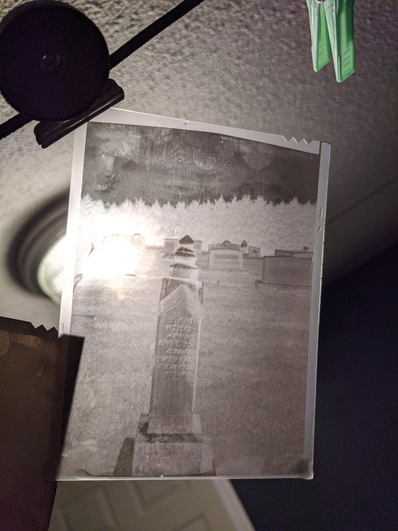

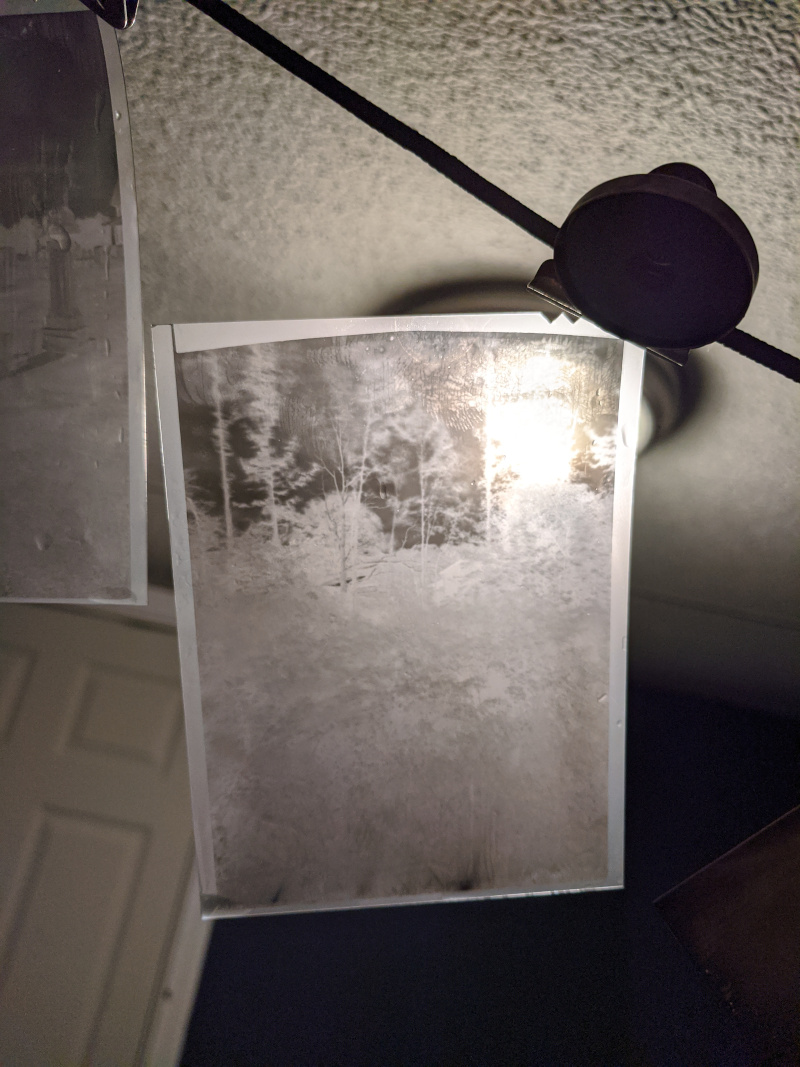

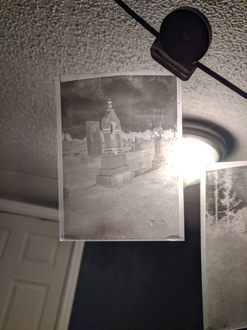

Well, today, I got the darkroom straightened out enough to develop film. Since the pinhole sheets were already in the Yankee Agitank, they were up first: but that tank wants 48 ounces to develop up to 12 sheets of 9x12, and the Df96 was only a quart. I had planned to mix a second quart of Df96, combine the two, and carry the processing count for the pair (two rolls would require one roll of time correction in the larger volume).
By the time I got things to where I could develop, however, I found it was too late in the day to mix the Df96 in "warm" water (around 100F) and still cool it to 80F or so for processing; plus, I couldn't find either my stirring paddles or my darkroom thermometer (they're here somewhere, I just haven't emptied that box yet). Well, I knew where I had a bottle of that Dektol double strength stock solution, and it was still the same color it had been when I last used it. I knew where there was fixer concentrate, and I could see the stop bath was still yellow in its translucent storage bottle -- indicating it was acidic enough to stop development.
Well, then, here we go. Nope, no hints on the Internet for how long to process long-expired TXP in antique Dektol (not very surprising), but I found a very old thread on Large Format Forum suggesting that 5-6 minutes at the standard 1+9 film dilution was a good starting point for that film -- twenty years ago, anyway.
Okay, starting from liquids, I could mix with cool water. I don't know what the temperature was, but it was below 75F, and above 65F (I tempered cold tap water with a trickle of our lackluster hot, and I know what 75F feels like from my partner's aquarium). I set up DevIt! on my phone for 6:30, clip tested both the developer and the fixer (both worked) -- nothing more to do than start.
Hint: don't develop with chemicals in 2L soda bottles.
Oh, the bottles are fine, they do a pretty good job of keeping oxygen out of your chemistry, and you can squeeze them easily to eliminated the air inside. They are not, however, capable of pouring a lot of liquid rapidly.
Yet, when you process film that expired when most of the new generation of film photographers were in diapers, with developer that was mixed fifteen years ago, if the only complaint you can make is over the hesitation marks from the slow fill -- I'd say you've come out pretty well.
Do I recommend doing things this way? Go back and read the title. Does it work? Seemingly it does, at least if you have the blessing of the Great Yellow Father. Worth noting that every chemical and material I used for this was made in Rochester, before Kodak even moved their coating facility to Colorado, never mind started outsourcing their chemicals.

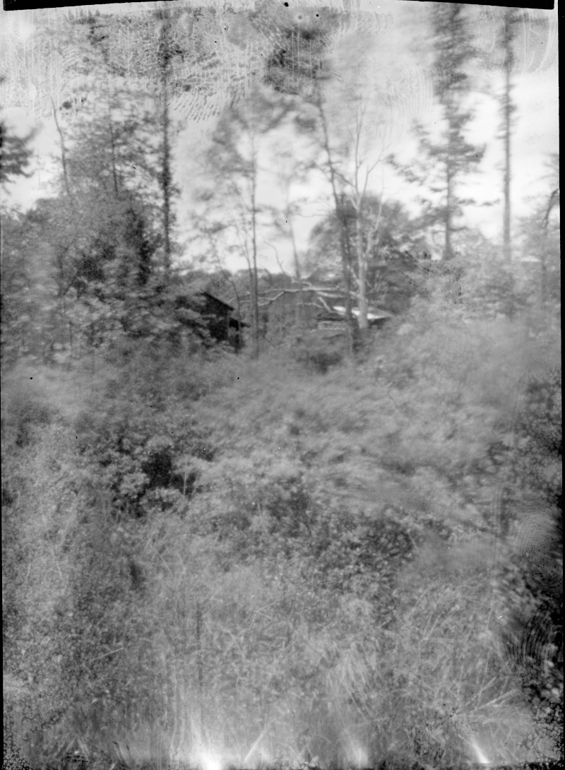

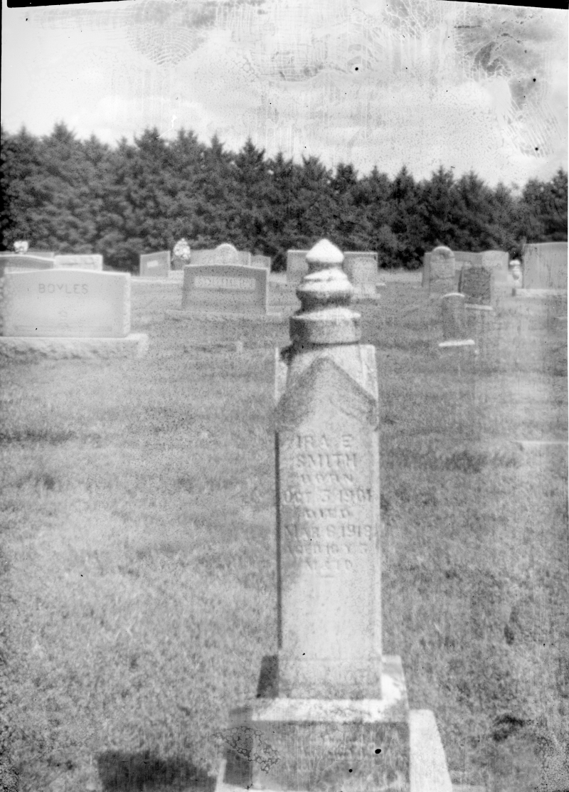

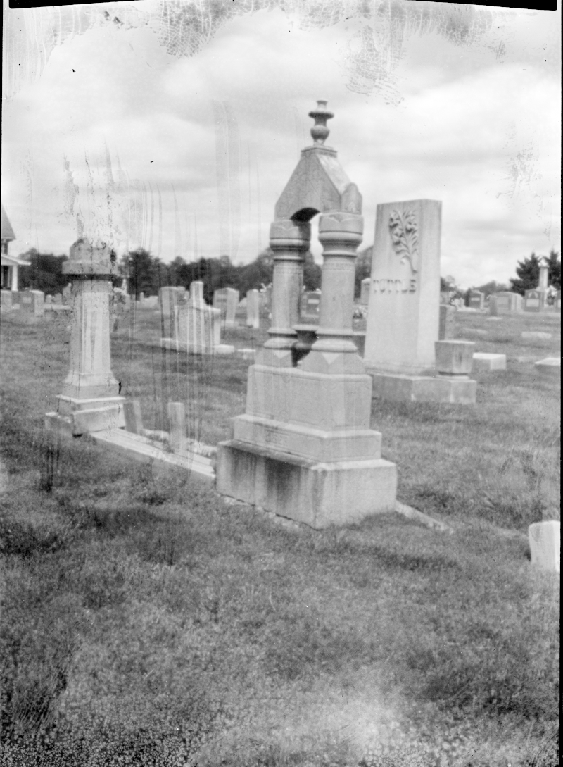

The negatives were dry when I got home from work last night, but I don't always get to "play" immediately, and then my scanner was being difficult (I bought it used in 2003). Wound up having to restart both the scanner and Ubuntu to get it to behave -- which meant I had to leave it until tonight. But now I have the scans -- and one more in the list of "how not to" -- because there are fifteen year old fingerprints on these negatives. I handled them no differently than I'm used to doing (clean hands, but not gloves) when I loaded them into the film sheaths and plate holders, so I can only conclude that my skin oils had fifteen years to work on the emulsion, changing the sensitivity of the halides as they worked. So, whatever my intentions, these are "artistic" now...
Zeiss-Ikon Ideal 9x12 cm, 1998-expired Tri-X 320, developed in Dektol mixed 1+19 from fifteen year old double strength stock solution (equivalent to the usual 1+9 dilution).
