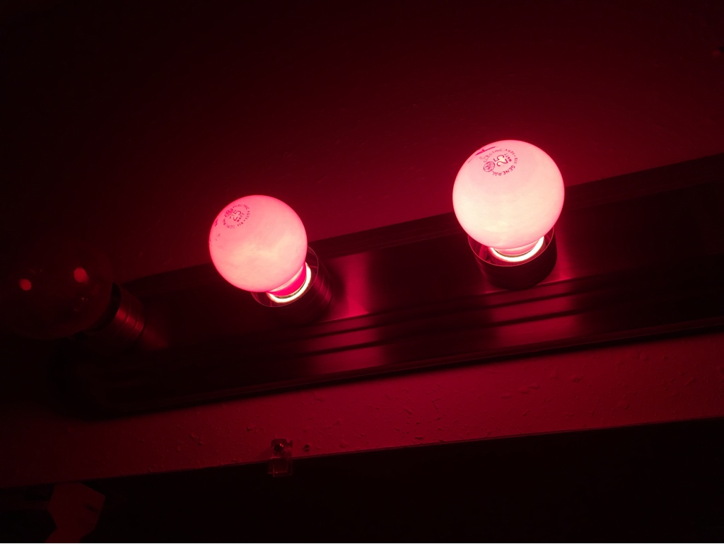

As it turns out, I have a built in safelight in my darkroom. Doubling as a half bath/laundry room, I found I can use these 25w bulbs from centuries past that I found in my camera junk box.
However there is a little bit of white light at the base of the bulbs. Do you think this will affect paper from 3' away?

I'm sure they will affect the paper, but do a proper safe light test to verify.

It's a good question to which Rick has given a good answer. However in the U.K. you can get what looks like a dark brown/black plastic open fez-like cover that screws on to the bottom of the bayonet attachment and effectively covers the bottom of the bulb where the white light is.
I know you use Edison screw bulbs but there may be something that does the same job?

red safelights were used way back when papers were graded and only sensitive to blue light. Today VC paper is senstive to blue and green over a much wider part of the spectrum. And papers are not all equal. You must test your safe light as Rick A says. And 3 feet is much too close anyway.

I'm with Rick on this, most likely won't work.
Aside from the band of white, 25 W is probably a bit too much. I tried a 25 W (white) in my filtered safelight and it fogged.
However, you could try wrapping the white part with some electrical tape, the bulb base will likely stay cool enough that it won't be a problem.
In any case, the only way to know is to do a proper test.

Take a bit of black paint and paint over the clear space above the base before you do any testing.

As mentioned, tape or paint will work fine. In addition, the wattage won't be as issue if you screw them into a lamp w/ a shade and address the opening at the top. Or, angle the light to the ceiling and bounce it back to your work area. It isn't the wattage, it's how much of it is getting to your area.

I used red bulbs when I first started printing in the late '50s, but they were a really dark red, specifically sold as safelight bulbs. The ones in your picture look like decorative red bulbs that would NOT be safe.

I agree with others and recommend a proper safelight test.a dab of red nail polish may cover your white spot on the bulb.:smile:
