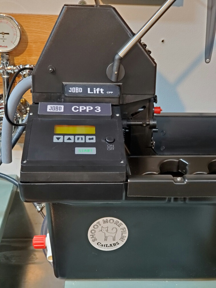

Film processing with my CPP3 equipped with a lift, I don't smell much of anything. I have a mixing valve so I fill the processor with tempered water for color. Highly recommend installing above a sink if available (not a requirement by any means). Mine is on a plywood platform above a SS sink.

Same here. I use a water stop for many processes and low odor rapid fix or Kodak F-24 fixer that I mix myself. I, also, use a Jobo Lift which IMO minimizes exposure to any smells.
